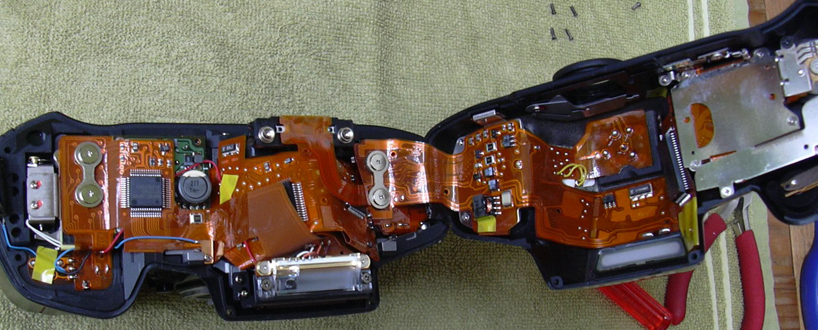

Decent cameras have a rating of minimum shutter cycles before they give in. So, if you buy a not much used one, will serve you for quite a lot, while a beaten like hell one might fail you sooner than expected. Note that electronic cameras have plastic gears too.
Look what there is inside an electronic camera:
This one is from an F90. For sure, besides the shutter mechanism there is a lot more that can go wrong in here. I am not saying it is unreliable, but as with everything, the simpler the better.
