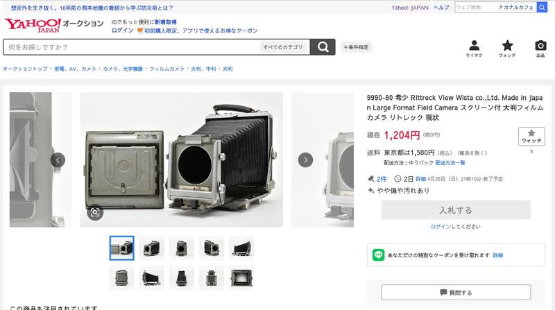

I'd love to find a Rittreck View 5x7 for example, that feels like a good solid camera, but they're hard to find! Any other ideas? I'm trying to get the whole kit set up (minus the tripod and head, which I have) for under $1k which feels tight but doable.
there is a Rittreck with the 5x7 back and the rotating 4x5 on Yahoo auctions now, 2 days left, current bid 1204 ¥ ie ~ 1,3 of your $.
for items on Yahoo Japan i use Zenmarket proxy, they collect the import VAT for reversion to my treasury department here where I am in Europe, so no extra processing fees and swift delivery (fast customs processing as declaration is done by the carrier).
