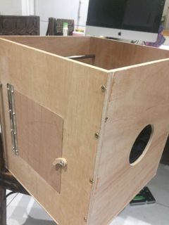

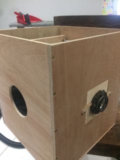

I've got an afghan inspired box camera made out of ply... I've attached a few pics-great fun and the kitten agrees!
Very cool!
It looks like you're using a lens in shutter so, presumably focal length and f-stop are well known.
The on line calculators will do the rest.
