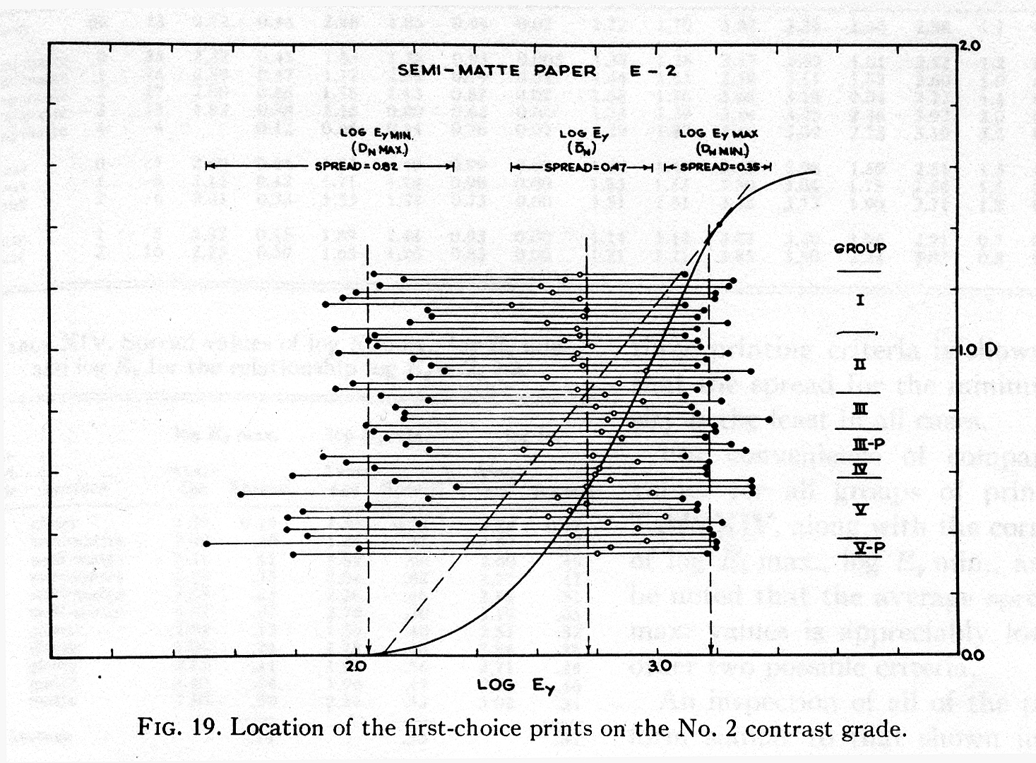

Jones discusses the best way to relate the film to the paper in two rather tedious papers, Control of Photographic Printing: Improvement in Terminology and Further Analysis of Results, 27 pages, and The Control of Photographic Printing by Measured Characteristic of the Negative, 60 pages. Both published in the Journal of the Optical Society of America. These are the studies that helped to establish the LER ranges for paper grades and the NDR/LER matching system. He looks at a number of different ways to "match" film to paper and concludes,
"The procedure followed in obtaining a relationship between NDR and LER may seem forced and artificial. This we grant, and it must be born in mind that the print quality obtained by its use will not be the highest possible quality. But what other course is there to follow? Either we must make the best of a somewhat imperfect relationship or face the prospect of having no criterion whatever for choosing the paper contrast grade."
This doesn't mean anyone should throw the baby out with the bath water. It just means there isn't system that works perfectly every time. I've attached a graph from Jones' testing showing the variance in negative density ranges that yielded first choice prints on a grade 2 paper. What Jones found was “for the soft papers, the density scales of the negative (DR) should in most cases exceed the sensitometric exposure scale of the paper (LER), whereas, for the hard papers, the density scales of the negatives should in most cases be less than the sensitometric exposure scale of the paper (LER).”

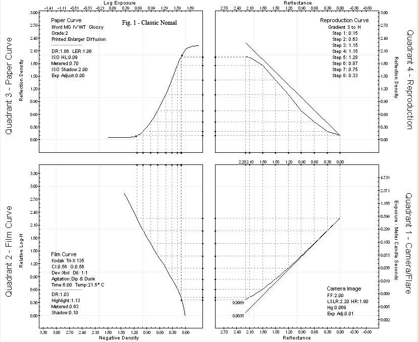

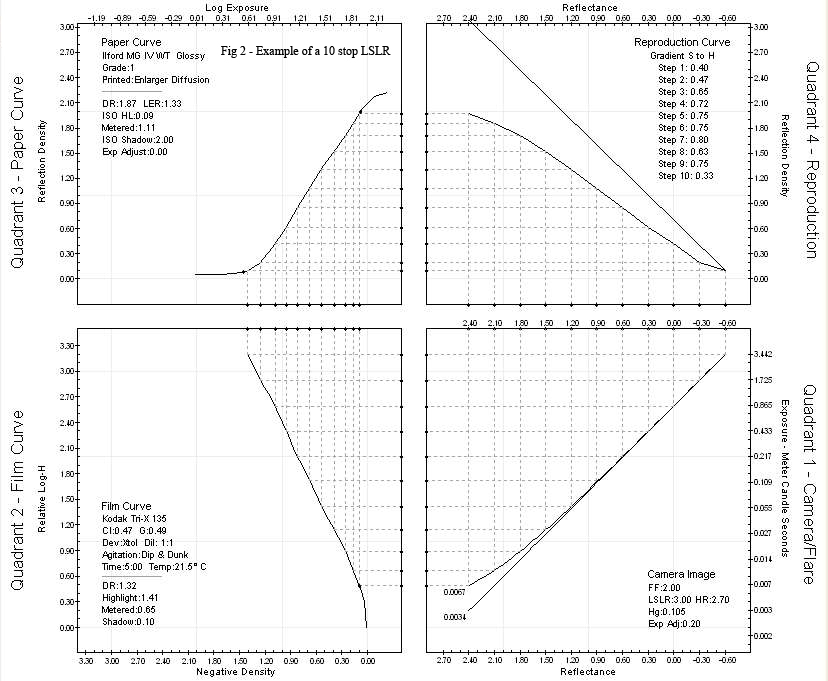

Michael, the method of matching the NDR with the LER isn't broken, there are just other factors involved. And you have pointed one out. While it is acceptable to compress the values from the highlights and shadows, the mid-tone gradient must exceed the mid-tone contrast of the original subject for the print to be perceived as being of high quality. They found the mid-tone gradient generally needs to be over 1.10. To fit the values from a subject with a high luminance range onto the paper, it is likely the mid-tones have to fall below the 1.10 gradient level. So even though the NDR matches the paper LER, unless the mid-tone gradient is greater than 1.10, the resulting print will probably not be acceptable. (This is another reason I like to use multiple quadrant reproduction curves. The fourth quadrant compares the print values to the original subject values. It's a very useful analysis tool. In fact, I just uploaded two examples. Fig 1 is a classic example for Normal and Fig 2 is for a 10 stop luminance range. Even though both film and paper match, there is a major difference in the reproduction curve.)

Another problem especially with long range subjects comes from the fact that paper can't reproduce specular reflections. In order to produce any tones above the reflectance of the paper, they have to be printed down but without loosing the impression of brilliance. Subjective tone reproduction makes my head spin, but objective tone reproduction makes little sense without it.

I should have included this in the last post. This is the same 10 stop luminance range, but the negative density range doesn't match the the paper's log exposure range. As Jones has suggested, the NDR is higher than the paper LER. The resulting mid-tone gradient on the tone reproduction curve is over the 1.10 minimum for a perceived quality print. If needed the highlights and shadows can be controlled through printing techniques.
To me, this appears to support Michael's observations. In addition, it is consistent with tone reproduction theory. Tone Reproduction Theory - it's a problem solving tool.:smile:

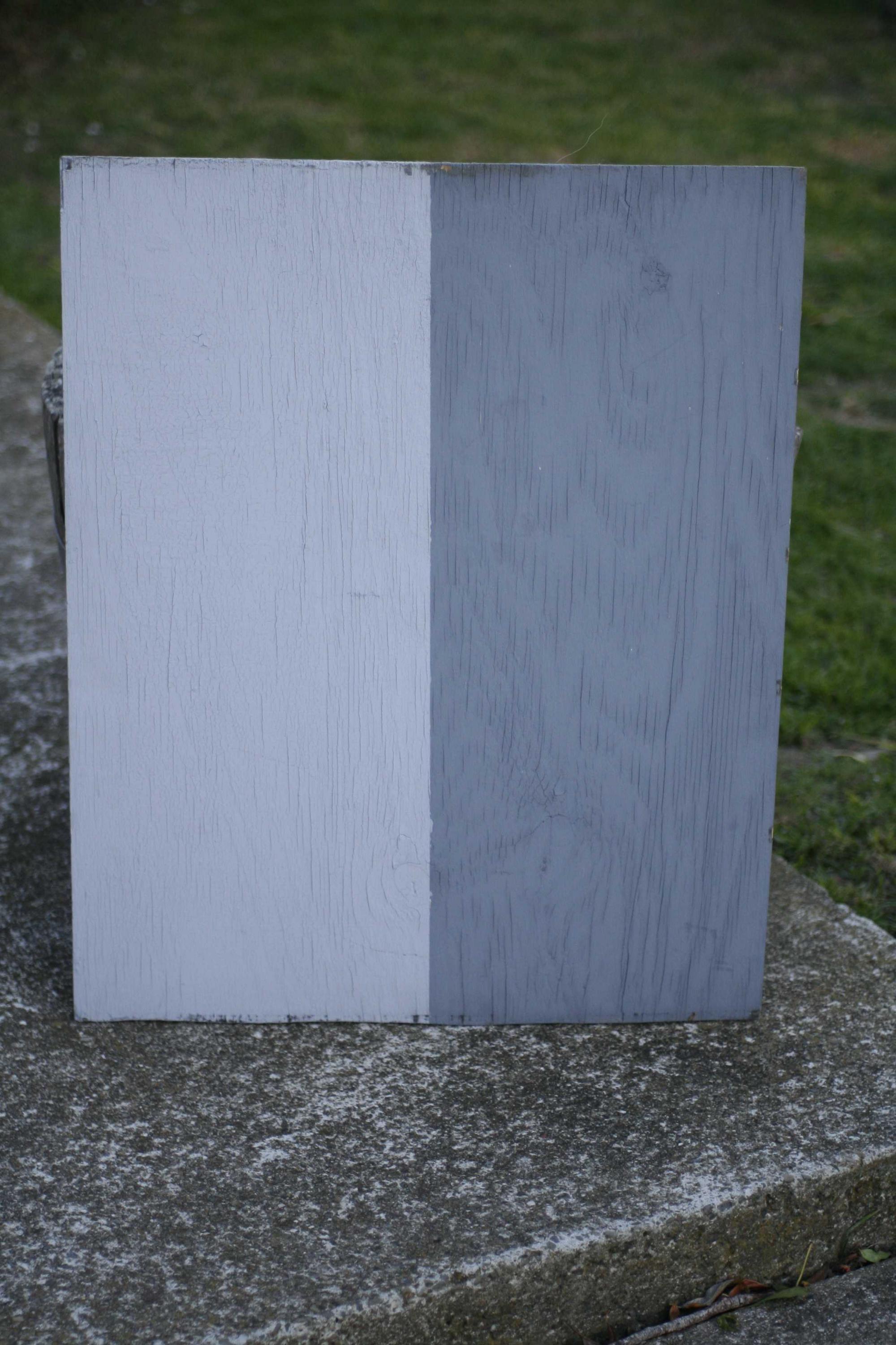

This painted plywood two-tone target, specified in Minor White's Zone System, does not have much flare. The two tones are supposed to meter one stop apart - so it is a one-stop Subject Brightness Range.
