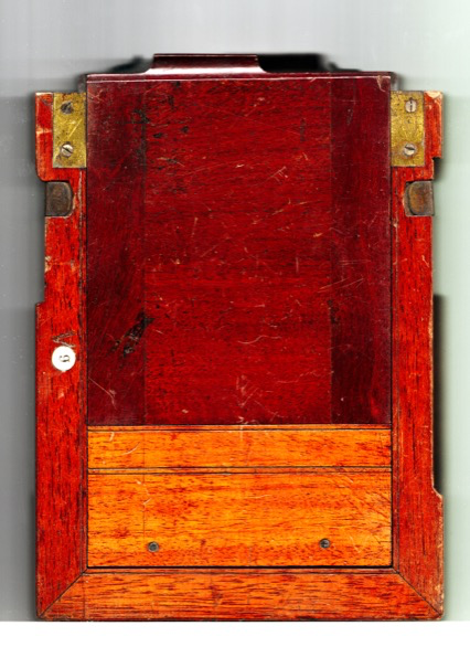

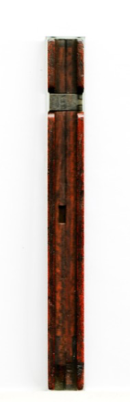

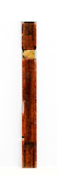

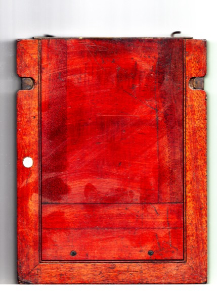

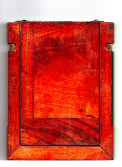

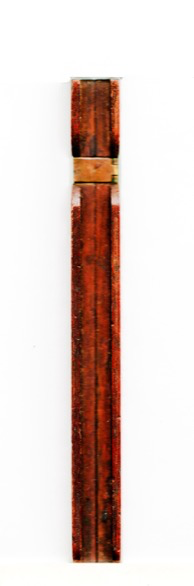

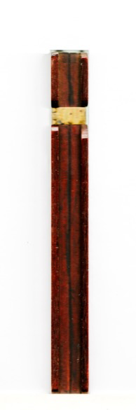

A half plate - partly mahogany? - holder with no trademark/name (seems from same manufacturer as the one shown in #27, but has 'opposite' wood color and in part other dimensions).
Measurements in inches are as follows:
A = 5,91
B = 0,42
C = 0,16
D = 0,12
E = 0,16
F = 7,80
G = 1,17 there is no slope
H = 4,40
I = 2,23 including slope
This one does have a notch for a slot at the side at 0,63 inch from the bottom.
These are known to fit:
unknown
extra info:
The 2 holders in my collection both have the letter A stamped at their left side (although not to be seen in the 2nd picture).
The inner sides of the slides have digits stamped: nrs. 50 and 50A, and the other nrs. 8 and 8A.

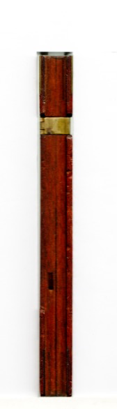

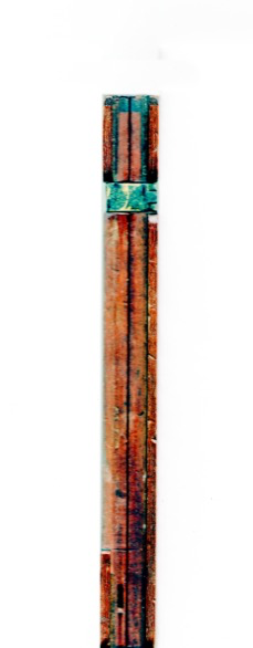

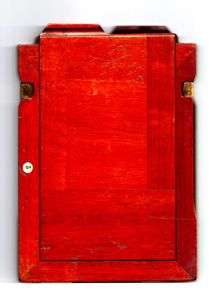

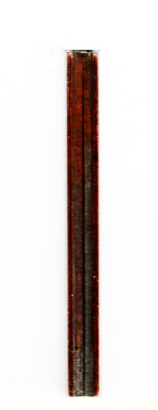

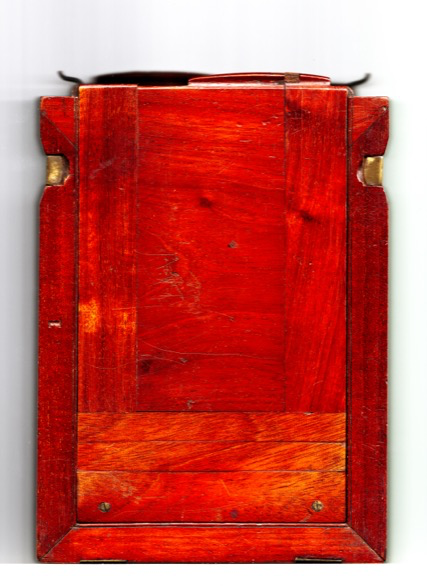

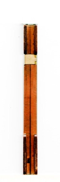

A half plate - partly mahogany? - holder with no trademark/name (seems from same manufacturer as the one shown in #26, but has 'opposite' wood color and in part other dimensions)
A = 5,91
B = 0,42
C = 0,15
D = 0,10
E = 0,15
F = 7,80
G = 2,08 there is no slope
H = 3,13
I = 2,59 including slope
This one does not have a notch for a slot at the side.
unknown
extra info:
In my collection I have 3 of these holders; two have plated hinges.
The inner sides of the slides have digits stamped nrs. 31 and 31G, 36 and 36&, and 40 and 40*.

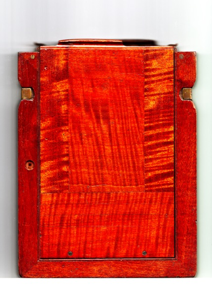

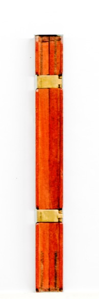

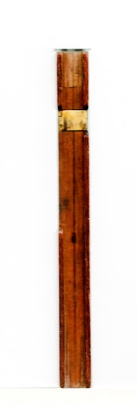

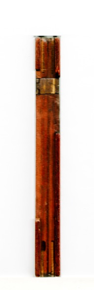

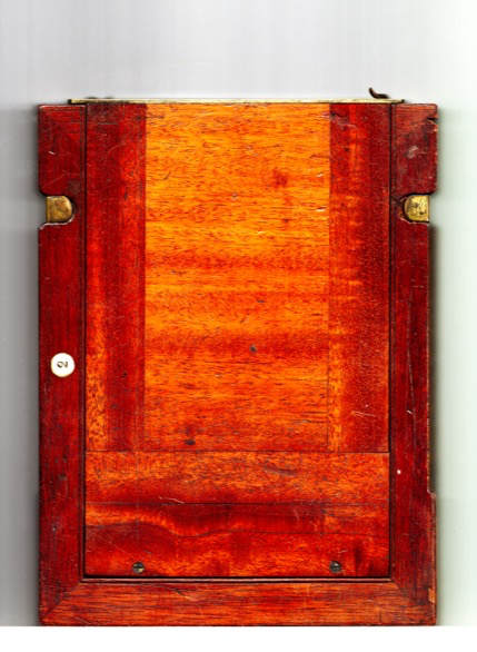

A half plate mahogany holder with no trademark/name with typically somewhat scewed slide tabs.
A = 5,75
B = 0,46
C = 0,15
D = 0,09
E = 0,15
F = 7,65
G = 1,21 including slope
H = 5,04
I = 1,40 no slope present
This one does have a notch for a slot at the side at 0,61 inch from the bottom.
unknown
extra info:
The two holders in my collection have digits at the inner side of the slides: 5 at both sides, and the other 7 at both sides.

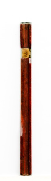

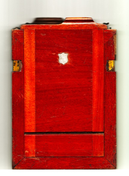

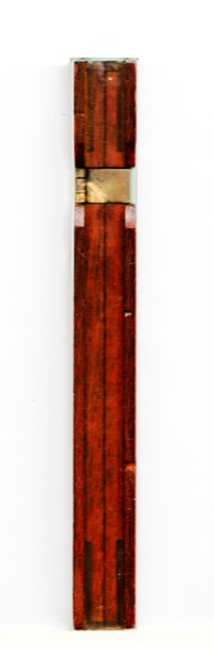

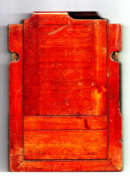

A half plate mahogany holder with no trademark/name (seems from same manufacturer as the one shown in #30 but with somewhat other ridge dimensions)
A = 6,07
B = 0,53
C = 0,16
D = 0,13
E = 0,16
F = 7,85
G = 1,73 including slope
H = 1,40
I = 4,72 including slope
This one does have a notch for a slot at the side at 3,39 inch from the bottom.
unknown
extra info:
The two holders in my collection have imprinted or rather scratched lines and 'curves' at the inner side of the slides: III and ))), and the other I and ).
The tabs of the slides have a distinctive horizontal groove.

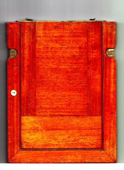

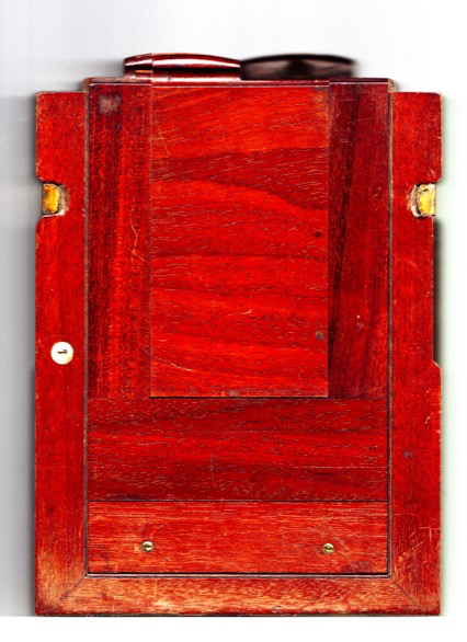

A half plate mahogany holder with no trademark/name (seems from same manufacturer as the one shown in #29 but with somewhat other ridge dimensions)
A = 6,07
B = 0,53
C = 0,16
D = 0,13
E = 0,16
F = 7,85
G = 1,52 including slope
H = 1,85
I = 4,48 including slope
This one does have a notch for a slot at the side at 3,23 inch from the bottom.
unknown
extra info:
The two holders in my collection have imprinted or rather scratched lines, 'curves' and 'x'es at the inner side of the slides: I I and ) ), and the other I X and ) X.

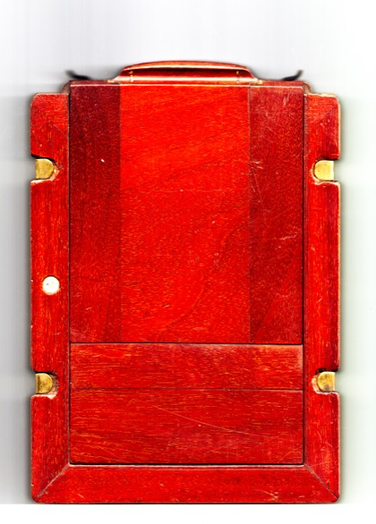

Here is a half plate mahogany holder with imprinted trade name on the slide: J. Lizars Glasgow.
A = 5,98
B = 0,41
C = 0,16
D = 0,11
E = 0,16
F = 8,04
H = 4,51
I = 2,01 no slope present
Lizars 'Challenge' camera.
Members might report whether they also fit other camera's from Lizars.
extra info:
In all 3 of my holders on each inner side of the slides (the same) digits are imprinted: 16, 22 and 23.
Two of the holders have imprinted numbers at their sides (which do not correspond with the numbering for the plates): a 3 and the other a 10

extra info:
At their sides these holders have a 4 digit number stamped: 1723 (2 holders), 1731, 1895.
variants:
These holders have two or four brass reinforcements (see 1st and 2nd picture).

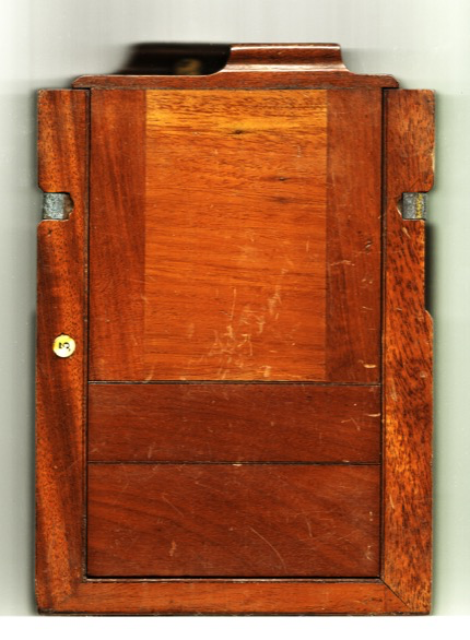

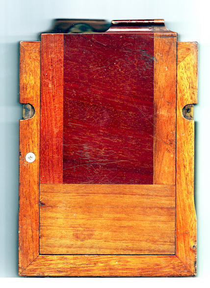

A half plate mahogany holder with no trademark/name and no hinges at the sides but instead at the top.
A = 5,98
B = 0,45
C = 0,13
D = 0,13
E = 0,13
F = 7,74
G = -
H = -
I = -
These holders do not have a notch for a slot at the side.
unknown
extra info:
Typically these holders do not have any numbering to distinguish the film or plates!
The inner side of the slides and of the holder have imprinted digits: nr. 13 and nr. 13+
The rims at both edges of the sides are similar.

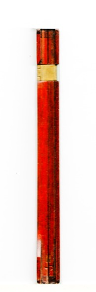

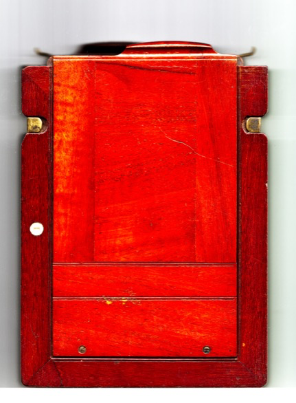

A half plate mahogany holder made by J. Lancaster & Sons.
A = 5,88
B = -
C = 0,12
D = 0,13
E = 0,12
F = 7,87
G = 1,74 no slope present
H = 0,62 = width of the hinge
I = 5,51 no slope present
This holder does have a notch (in brass fitting) for a slot at the side at 3,43 inch from the bottom.
camera's by J. Lancaster & Sons, but camera type is unknown, probably The Instantograph.
Other members might report which type of Lancaster camera's would match these holders.
extra info:
Typically this holder does not have any numbering to distinguish the film or plates!
Also peculiar is that this holder does have hinges at the sides as well as at the top!
At the inner side bottom edge of the holder a little 'V' is stamped.
At the sides the holder has (similar) rims at the edges and in the middle (see 2nd picture).

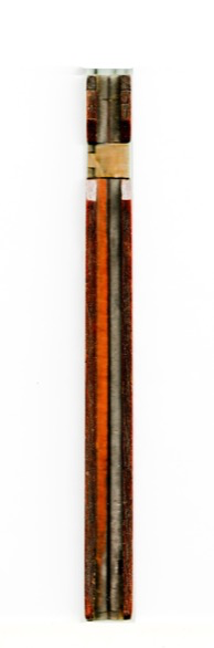

A half plate mahogany holder with no trademark/name.
A = 6,10
B = 0,52
C = 0,20
D = 0,13
E = 0,20
F = 8,10
G = 1,60 including slope
H = 1,80
I = 4,70 including slope
This one does have a notch for a slot at the side at 3,25 inch from the bottom.
unknown
extra info:
This (heavy build) holder has imprinted or rather scratched lines (like roman numerals) at the inner side of the slides: I I I I X at both sides.

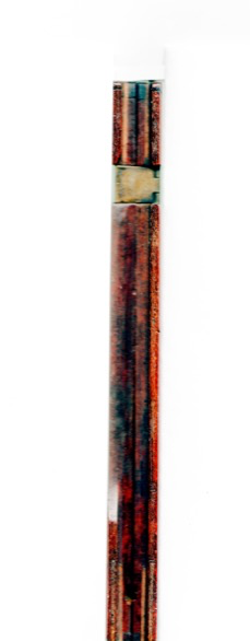

A = 6,10
B = 0,50
C = 0,14
D = 0,13
E = 0,14
F = 7,87
G = 1,38 including slope
H = 2,66
I = 3,83 including slope
This one does have a notch for a slot at the side at 3,40 inch from the bottom.
unknown
extra info:
This holder has imprinted or rather scratched lines (like roman numerals) at the inner side of the slides: I I I X X X at both sides.
A half plate mahogany holder with no trademark/name and brass reinforcements at the top.
A = 6,10
B = 0,50
C = 0,17
D = 0,15
E = 0,17
F = 7,87
G = 1,32
H = 1,78
I = 4,77 including slope
This one does have a notch for a slot at the side at 0,90 inch from the bottom.
unknown
extra info:
A = 6,10
B = 0,56
C = 0,13
D = 0,13
E = 0,13
F = 8,04
G = 1,54 including slope
H = 3,10
I = 3,40 including slope
This one does not have a notch for a slot at the side (the notch in the left rim seems not original - re 2nd picture)
unknown
extra info:
This holder has imprinted digits at the inner side of the slides: 26 and 26+.
