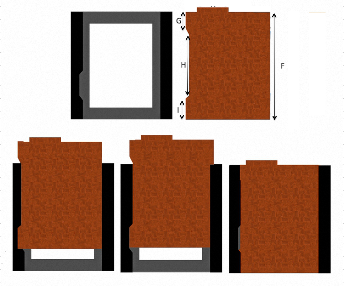

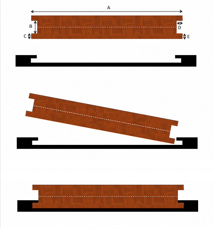

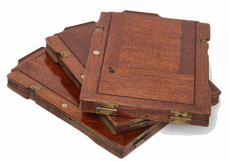

Ron (Netherlands) and i have discussed how to identify Wooden "Book Form" plate holders, and the measurements needed.
These are typical Half Plate Book Form plate holders.

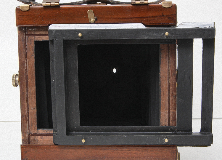

To understand how they fit I've include this image of an adapter I made, Rather than being slid in the whole way the bottom eged is located in the bottom groove of the bac in this position then the adapter or plate hold slides to lock it in place
The top groove is not always continuous allowing the holder to be slid into place but no further.
There's far greater variations between different Book Form plate holders than metal plate holders which makes life difficult.
These two drawings show how they work and the measurements needed:
The above illustration is the raer face of the book form holder. Most dimensions are self explanatory, C is the thickness of the top edge/tong of the holders, this usually has part of the edge/tongue cut away to allow quick fitting. E is the bottom edge. F is the over all length of the holders excluding the dark-slide tab
Ron has kindly added the A-I measurements needed to check possible fit.
We will both add examples and measurements of Book Form holders and what cameras we have that they fit in an effort to build up a useful resource.

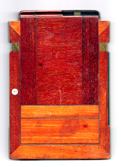

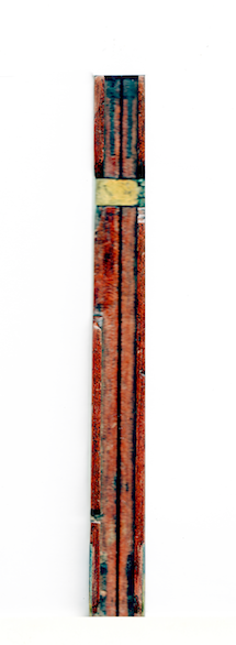

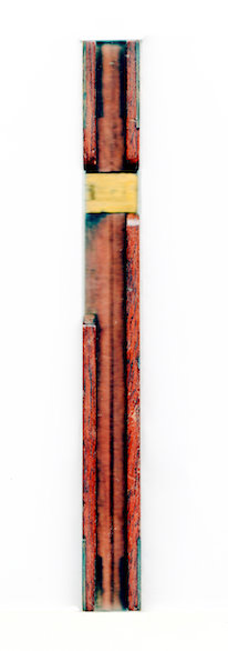

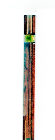

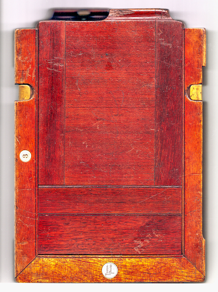

Thanks for all the front work Ian. Here is a first sample of a what easier to find British half plate double holder in mahogany
made by Thornton Pickard.
Measurements in inches are as follows:
A = 6,00
B = 0,48
C = 0,15
D = 0,12
E = 0,15
F = 8,00
G = 1,25 including slope (slope sometimes not there or hardly visible)
H = 5,25
I = 1,50 including slope
These do not have a notch for a slot at the side.
These are known to fit:
Thornton Pickard Triple Imperial Extension
Thornton Pickard Imperial Perfecta
Other members might report whether they fit other TP camera's like the (Royal) Ruby, Tribune, or Amber.
extra info:
On each innerside these holders have stamped a 3-digit number succeeded by a letter like 203Q and 204Q.
Further, the same holders with exactly the same dimensions were on the market but without the trademark.

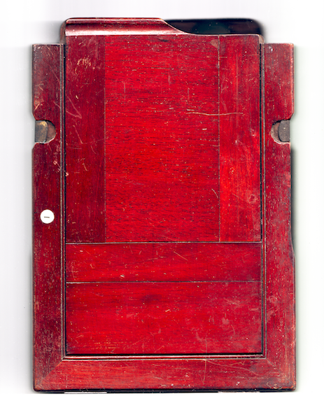

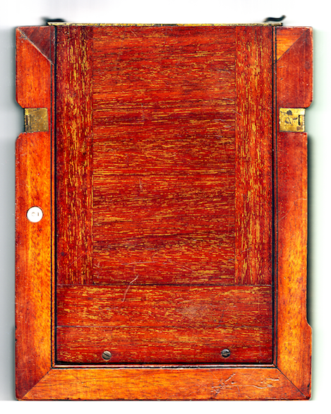

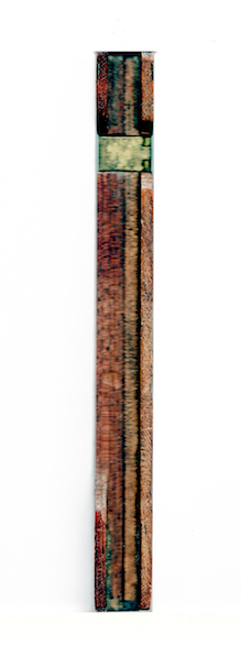

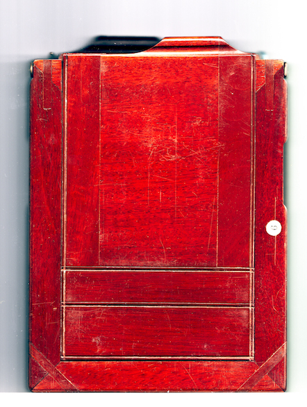

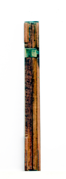

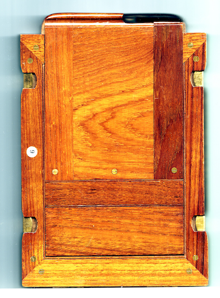

Here is a mahogany holder that came with one of my half plate Perken, Son & Rayment cameras.
The holder has no trademark/name.
A = 6,25
B = 0,45
C = 0,15
D = 0,13
E = 0,15
F = 7,90
G = 1,74 including slope
H = 4,52
I = 1,65 including slope
This one does not have a notch for a slot at the side.
Perken, Son & Rayment patent camera
Other members might report whether they also fit other Perken camera's like the Optimus, or older Lejeune & Perken camera's.
extra info:
Typically these holders do have two brass strips at the top of the slides instead of the more common wooden tabs.
On each inner side these holders have stamped a 1-digit number which corresponds with a 1-digit number on the inner side of the slides. In this one: a 1 and 2.
Further, the same holders with exactly the same dimensions were on the market with the imprinted tradename "Optimus" at the inner side.

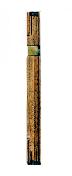

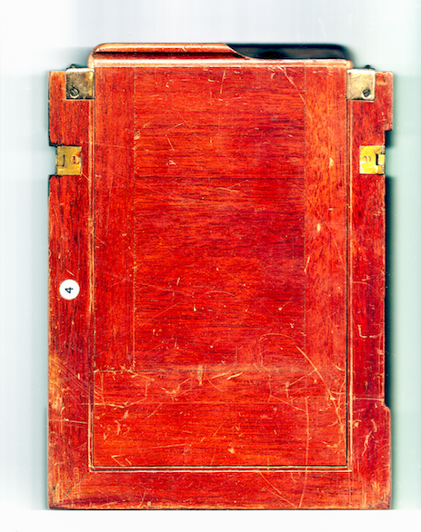

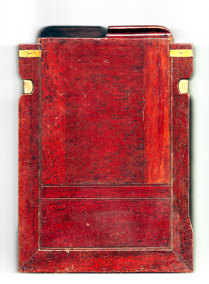

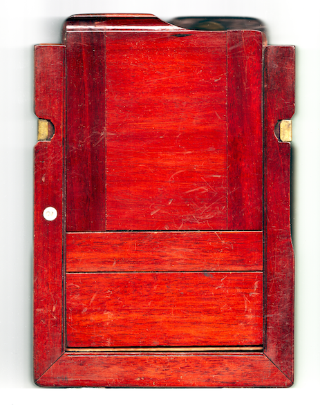

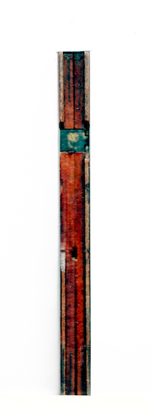

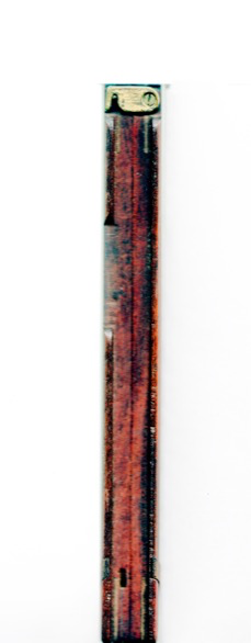

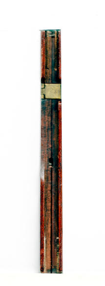

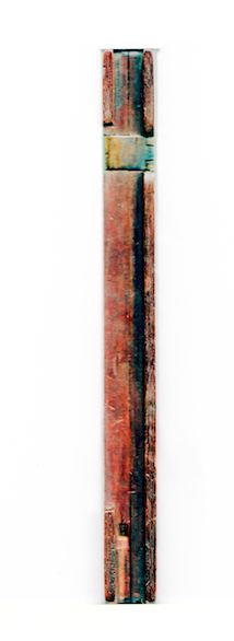

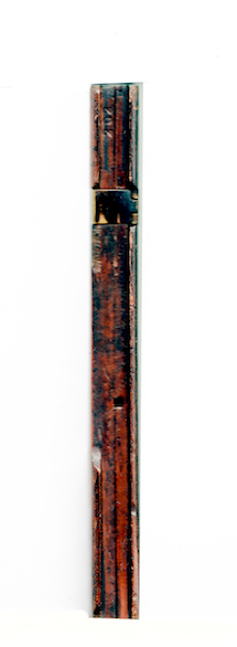

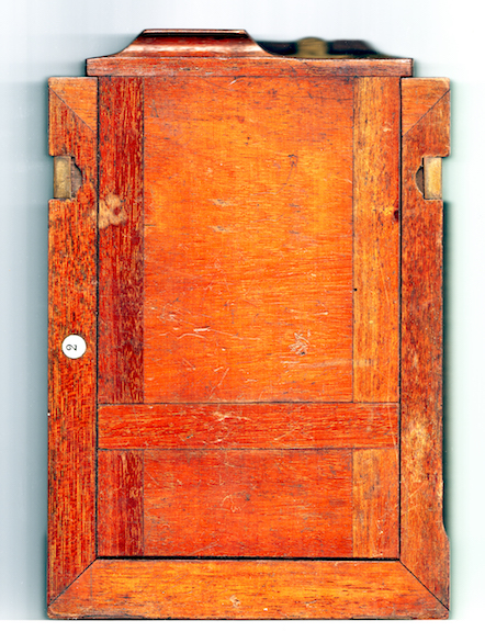

Another more common seen mahogany plateholder is this one by Houghton:
A = 6,10
B = 0,40
C = 0,18
D = 0,12
E = 0,18
F = 8,00
H = 5,00
I = 1,75 including slope
Variants:
Some do have a notch for a slot at the side, at 3,55 inch from the bottom (see 2nd picture) or at 0,70 inch (see 3rd picture). I have 2 that do not have a notch at all.
Houghtons The Victo camera
Houghtons Triple Victo camera
Other members might report whether they also fit other Houghton camera's like the Victo Superbe, Tropical Victo (although it had teak holders in stead of mahogany) or possibly even some Sanderson.
extra info:
Typically these holders have a wooden tab at the top of the slides with a curve at the right side.
At the bottom sometimes a number is stamped like 5409 or 7678.
On one inner side one of these holders has a 1-digit number stamped, a 2. But others do not have any number inside.

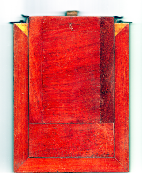

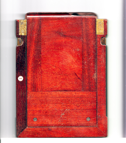

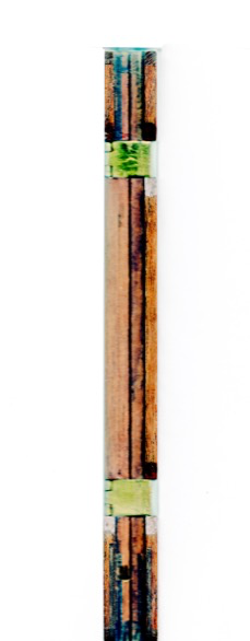

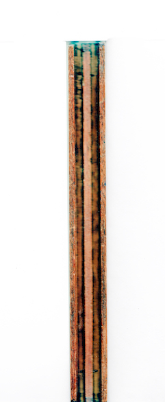

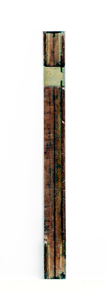

Another half plate mahogany holder which is probably by Houghton but has other dimensions than the one in #8:
A = 5,85
B = 0,38
C = 0,11
D = 0,11
E = 0,11
F = 7,96
G = 1,26 including slope
H = 4,80
I = 1,90 including slope
unknown
extra info:
This one has nr. 29 stamped at the inner side of both the slides.

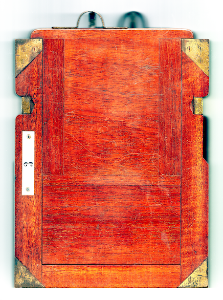

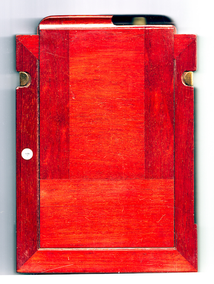

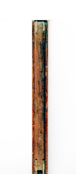

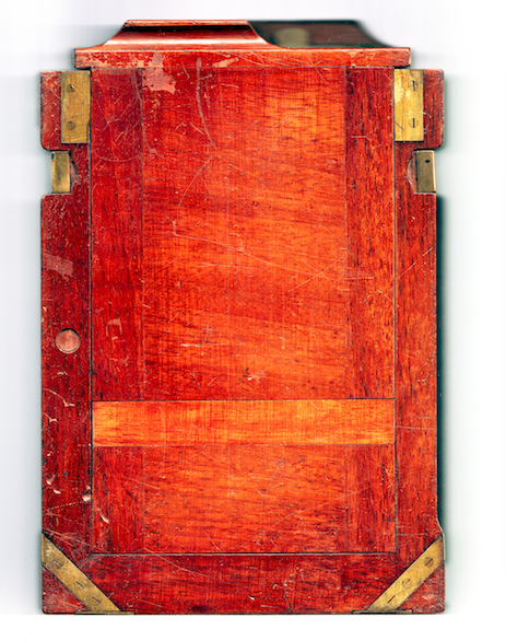

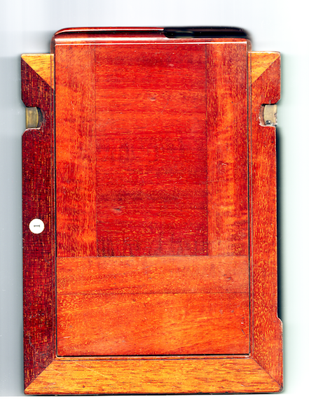

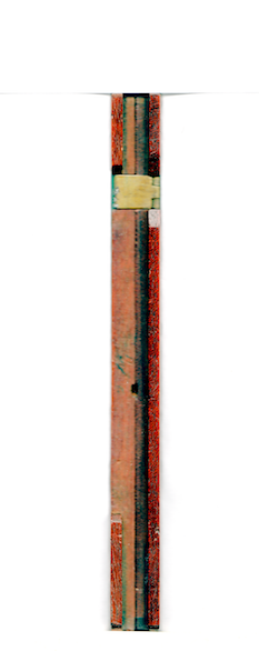

A half plate mahogany holder with no trademark/name and a very typical brass tab and release for the slides.
A = 6,19
B = 0,43
C = 0,19
D = 0,18
E = 0,19
F = 7,96
G = 1,85 including slope
H = 1,96
I = 4,15 including slope
unknown
extra info:
All corners have brass reinforcements.
The 3 holders in my collection have digits stamped at the inner side of the slides: nrs. 7 and 8, nrs. 25 and 26, and nrs. 27 and 28).

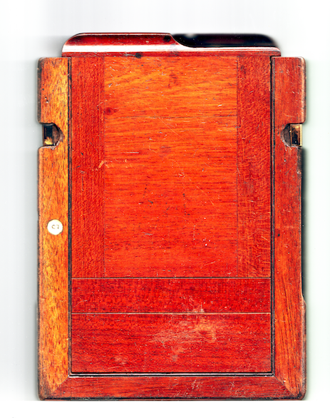

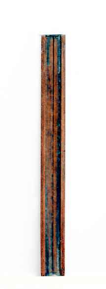

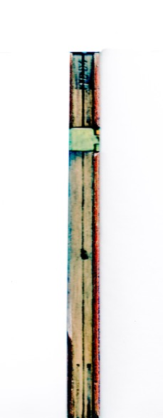

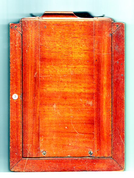

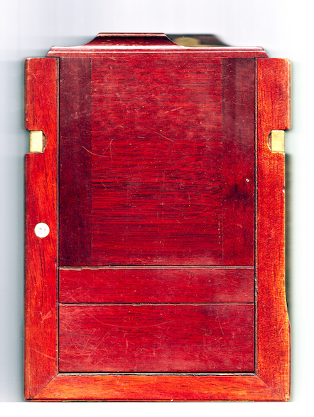

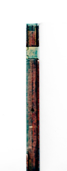

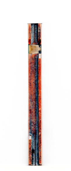

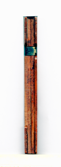

A half plate mahogany holder with no trademark/name and brass reinforcements at the top - possibly by Watson & Sons.
A = 6,00
B = 0,43
C = 0,16
D = 0,09
E = 0,16
F = 7,75
G = 1,05
H = 5,35
I = 1,35 including slope
This one does have a notch for a slot at the side at 0,95 inch from the bottom.
unknown - but possibly matching a Watson & Sons camera
extra info:
The 2 holders in my collection have digits stamped at one of their sides: 12367 and the other 12894.
Further the inner side of the slides have digits imprinted: nrs. 21 and 22, nrs. 37 and 38.

A half plate mahogany holder with no trademark/name.
A = 5,95
B = 0,49
C = 0,11
D = 0,11
E = 0,11
F = 8,05
G = 1,18 there is no slope
H = 5,34
I = 1,53 including slope
This one does have a notch for a slot at the side at 3,54 inch from the bottom.
unknown
extra info:
A = 6,10
B = 0,45
C = 0,14
D = 0,14
E = 0,14
F = 7,90
G = 1,65 there is no slope
H = 3,76
I = 2,49 including slope
This one does have a notch for a slot at the side at 3,36 inch from the bottom.
unknown
extra info:
The 2 holders in my collection have digits stamped at one of their sides: 1094 and the other 1163.
The inner sides of the slides have digits stamped: nrs. 39 and 40, and the other nrs. 1 and 2.
The ridges at the sides are strongly rounded (and therefore feel nice in the hands).
A half plate mahogany holder with no trademark/name and brass reinforcements at the top - possibly by Billcliff or Chapman.
A = 6,05
B = 0,53
C = 0,16
D = 0,09
E = 0,16
F = 7,83
G = 1,58 including slope
H = 1,37
I = 4,42 including slope
This one does have a notch for a slot at the side at 0,82 inch from the bottom.
unknown - but possibly matching a Billcliff and or a Chapman camera.
Other members might report whether the holders fit these cameras.
extra info:
At the top and at the below corners there are inlays with different wood.
The 3 holders in my collection have consecutive digits stamped at the inner sides of the slides: 1 and 2, 3 and 4, & 5 and 6.
These holders are distinguished by their typical hinges (see 2nd picture).
A half plate teak holder with no trademark/name - possibly by Sanderson / Houghton
A = 6,09
B = 0,41
C = 0,17
D = 0,10
E = 0,17
F = 8,26
H = 5,20
I = 1,80 including slope
This one does have a notch for a slot at the side at 0,89 inch from the bottom.
unknown - but possibly matching a Sanderson and or Victo tropical camera.
extra info:
The holders have a lot of brass screws as reinforcements and a double set of hinges.
The 2 holders in my collection have digits stamped at the inner sides of the slides: 29 (both slides) and the other 36 (both slides).
The finish on these holders seems more sustainable / durable than on regular holders.
A half plate mahogany holder with no trademark/name - possibly by Sanderson / Houghton (compare to holder under #8)
A = 6,09
B = 0,40
C = 0,18
D = 0,11
E = 0,18
F = 8,00
H = 5,09
I = 1,65 no slope present
This one does not have a notch for a slot.
unknown - but possibly matching a Sanderson and or Victo camera.
extra info:
From the 4 holders in my collection 3 have digits stamped at the inner sides of the slides: nr.s 25 and 26, and two have nrs. 39 and 40
