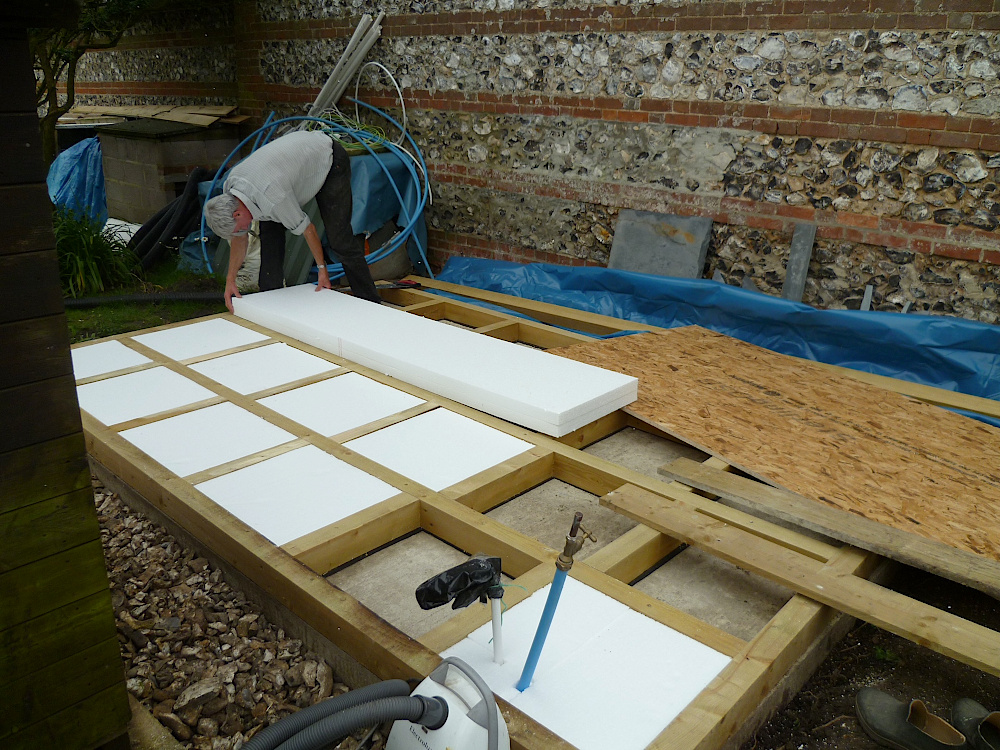

I built my darkroom shed with 2 inches of insulation in the walls, floor and ceiling, plus an inner lining of that silver bubble foil insulation for good measure. I then wrapped the whole thing with semi-permeable roof membrane and battens before wood cladding (so there is also an insulating air gap). I leave an electric oil heater in the darkroom on its lowest "frost" setting, and the door remains shut if not in use.
The shed is now more than 10 years old. Its temperature changes only very slowly, and stays within an acceptable range year-round. I turn the heat up for work sessions during the colder months. In hot summer periods the temperature inside is pleasantly cool. I've not had any issues with chemicals or other materials spoiling.
I was anxious about mould or damp in such a well-sealed shed, so I installed fans for both inward and outward airflow. The outward-blowing fan switches on automatically if internal humidity reaches a certain level. This all seems to do the trick.

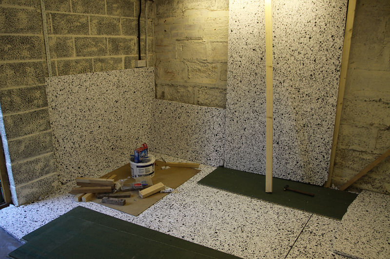

My darkroom is in a 12" x 13" stone and breeze block shed with a pitched roof at the end of my garden, electrics had already been installed.. As above insulation is the key. the floor was sealed with polythene sheet, then 2" expanded polystyrene sheets, and then flooring grade chipboard. The walls were battened , again lined with polystyrene sheets, then plaster board.

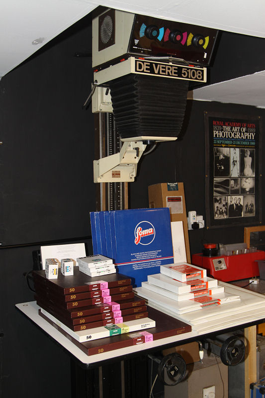

I had to cut away sand re=arrange 3 of the roofing joists to allow full head height of my De Vere 5108. The ceiling area is well insulated. I've also insulated the door.
During the winter I use a small heater to keep the darkroom at a minimum of around 10ºC, as long as I don't leave the door open on hot summers days it remains reasonably cool.

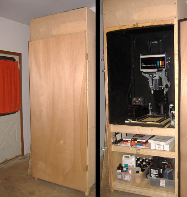

My darkroom is my garage, but it is attached. I built a cabinet for the enlarger to keep things clean. Over the years film developing tends to happen more quickly in cool weather when it is easier to heat a tempering bath, although I do use ice on occasion and simply wait until the bath hits the appropriate temperature. Winter printing is very possible with a "pig blanket", but I find my desire to print is often insufficient to overcome my desire to be warm.
My darkroom is in my garage. I live in a nice climate where summer and fall temperatures are about 20 degrees C, so I just use it that time of year.
Good luck!View attachment 368978
That's a great cabinet. Reminds me of something from Pop Photo from the good old days. I have my father's old darkroom box, he built it from a plan in the 40's, has 4 shelves for each contrast grade, and a place to store a tank and a couple bottles.

I'm in the UK, which may not be all that relevant, but I agree with others that heavy insulation is the key.
Just found a photo of me insulating the floor of my darkroom shed, in case this helps.
