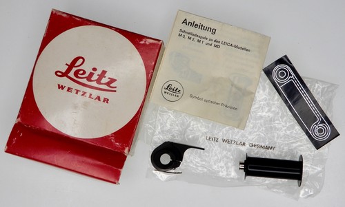

FYI, CameraWorks UK makes a quick load kit that can be retrofitted to the M2 if you don't gel with the M2 loading system.
Leica made one at one point as well. You can probably find a used one somewhere.
