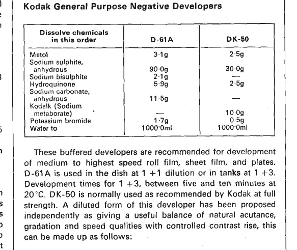

Ian, nothing you say takes away from the simple fact that Crawley published his own conversions from avoirdupois. He did the maths himself. ?
What's at issue here is that Bill Troop is accusing Crawley of reconverting D61a from the Avoirdupois and making errors, which us just a plain simple lie, if he did reconvert - which seems rather absurd as Kodak publish all theier formulae in metric anyway, then he came to exactly the same result as the metric weights Kodak originally published anyway, see attachments below.

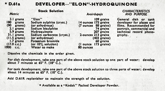

Look at the linked images Kodak & Crawley versions are in complete agreement so Troops comments are facetious, the left is Kodak 1948, the right Crawley 1972.

Ian, of course I know Kodak mis-published the formula years ago! But they publish it correctly today. You state they've dumbed it down. I just don't know where you get this information from. I've never heard it before. But I know from Harold Russell, who was there, at the time, that the correct formula is the one with integer amounts. So does every other chemist in the world who has ever formulated a film developer.
I also know that Geoffrey Crawley made the conversions himself, because he told me so. That they co-incide with some of Kodak's is OK. That just tells us how the mistake was made in the first place.
Kodak has corrected the mistake. Shouldn't you?

Kodak published D61a formulas using both the monohydrate and anhydrous forms of Sodium Carbonate. See the table in my post above for the comparison.
Avoirdupois measures vs Metric (rounded up or down) in the cases I compared do not match correctly. Therefore, there is an error in the Kodak published conversions themselves.

So which is right, well to find out you need to know exactly how many grains are in a gram, and make sure that your dealing with the right liquid measure for the final developer.
One grain is actually 64.79891 milligrams, as defined by SI, so 45 grains would be 2,915.95095mg or 2.91595095 g so both versions are actually wrong. 3,0g would be 46.297075059 grains.
However if you assume that the grain measurement was in US liquid quarts (there are 1.0566882094 quarts in a Litre), and the grams in Litres then 3.0g would be 43.813373375 grains, still wrong, now lets use the 3.1g version it would be 47.840310894 grains per Litre or 45.265513689 grains per US quart. You could round that off to 45 and be close enough.
There are lots of places where a conversion could go wrong, especially if you were doing the math by hand and didn't keep all the decimal places.
Thanks Paul for reinforcing what I just said.
These formulas are wrong due to math and transcription errors. The funny thing is that the Metric values vary while the English values stay relaitvely constant but more in error when compared as you did above and as I did.
Since the formulas were developed using the Metric system, then something is really awry! This appears with many many formulas in many texts.

I'd like to make clear something that Ian can't seem to get his head around: these versions are due to generations of technical writers goofing up. The chemists would not be closely involved.
>Since the formulas were developed using the Metric system, then something is really awry! This appears with many many texts.
That is true and, as you know Ron, a chemist has to have a very good reason indeed to add decimal places - - especially for environments where accuracy to within fractions of a gram were scarce on the ground. I would guess that it was the desire to provide avoirdupois users with practical, neat, units which started the process of distorting this developer.
It is shocking that Crabtree allowed the mistake into Photographic Chemicals and Solutions, but then, as we know, there were hundreds of similar errors in that 'standard' text. I must add that though Crabtree's reputation was very great, both Henn and Russell considered his celebrity undeserved.
Bill, Ian;
I'll tell you how decimals get added.
The original formula may specify 5 g/l of X in a fresh mix. It goes to the plant and they make the formula and find a 10% loss or a 10% variation in sensitometric result after the first day but it is ok after that, so they play with it to get the right (R&D) result. Lets say it takes 5.1 grams of X to make the formula rock stable but it is a little high on the first day. This might represent what is seen with D-76 in actual practice AAMOF.
This can also be seen in formulas like D23 and DK60. It can be seen in D76R, and in a number of other places where the English and Metric formulas both use fractions in compounding the developers. Formulas that use fractions of units in both English and Metric seem to me to be more likely to be right. IDK but that is another opinion.

And when you are all done arguing about how many angels can dance on the head of a pin, and calling one another names, how do you know who is right, if anyone?
The information about amounts of ingredients in the subject of a patent is not to be taken as absolutely precise unless only that precise value will make the system work to produce the claimed function. Otherwise, anyone could concoct a product that was a milligram off without violating the patent.
In the engineering and scientific world where I earned my living and got most of my education, a number that was specified as, say, 3 meant "greater than 2.5 and less than 3.5." If it was written 3.0 it meant "greater than 2.95 and less than 3.05." 3.1 means "greater than 3.05 and less than 3.15" and so on. If you wanted greater than 3.1 and less than 3.2 you specified 3.15.
If it is important to have 3.1 grams of Metol to the milligram, you should specify 3.100. I have a 1941 War Department Technical Manual of Basic Photography that specifies 106 grains of Metol per gallon for a developer that is obviously to do the job of D-76. That works out to 1.82 grams per liter. Would that work as well as 2.0?
We started out with Windisch. My money is on the lesser amount of sulfite, simply because I think he knew the value of the proportional staining of catechol and the effect of sulfite on that stain.

Ron's explanations are likely to be close to the mark and also match what I've said many times in the thread, so the implication is that the early versions of the Formulae were right. Ron has at no stage said or implied that they would be wrong.
I should add Bill that like Ron I have a scientific background, have worked as a photographic chemist, and later ran an analytical laboratory for a number of years.
There's an important issue raised by Ron's comments that we haven't considered and that's the purity of the chemicals being used.
Earlier in the thread I mentioned twice that someone in an entirely separate and unrelated post had stated that he thought Kodak didn't begin selling Chemistry until around 1938. It's quite probable that the advent of Kodachrome and other colour processes meant far tighter tolerances where needed in the purity of photo chemicals, in fact there were ANSI & BS (now ISO) standards set after WWII for the minimum purity of photo grade chemicals. Kodak state in their Harrow Research Formulary that "Elon" is a specially purified form of monoethyl paraminophenol (Metol), and some other contemporary manufacturers specify using their grade of photochemistry, so perhaps this was a major issue in the late 30's and 40's.
So taking these factors into account Ron's comments make even more sense.
That still doesn't make the early original published versions of D61a, D72, D156 "Velox", D163, D166 etc etc wrong, just the opposite, they use Kodak "Elon" so the purity of chemicals had already been improved by the early 40's when all these formulae were published and, and these may have been older unpublihed formulae that had themselves been revised to reflect these changes.
All formulae like D23/D25 & subsequent new developers etc were devised around or after the time Kodak had begun chemical manufacture so used the higher grade chemicals from the outset.
It is rather a shame and sad that Bill Troop has to constantly try and denigrate the work of other writers, it's easy now in hindsight to criticise Jacabson, Developing, a book first published in 1940 that was already in it's 18th Edition by 1972, particularly when the FDC hasn't even reached a 2nd Edition after 11 years. The FDC had an entirely different agenda to Jacobson, Developing, so direct comparisons aren't valid, it was never written as a book of Formulae.
By the time Bill wrote his contributions to the FDC data, printed formulae and access to people involved was far easier to access, and in addition many important text books that Bill has relied heavily on have only been written since Jacobson began writing.
A final point Bill, Kodak publications in the UK have never included Sodium Carbonate (Monohydrate), they always listed the Crystalline and alternative Anhydrous form. I don't think it was made in that form in the UK, and I've never seen a reference to it in any UK publications or formulae from any company. In the UK Kodak sold "Kodak" Sodium Carbonate as the anhydrous form I have a 1950's Tin ?3.5Kg in my chemical store.
