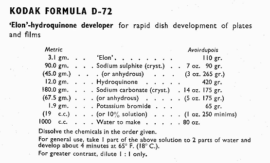

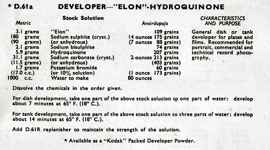

Here's an interesting footnote on BJP formulas for Ian. There are some apparently super-precise renditions of some Kodak formulas such as D-61a that have amounts like 3.1 grams instead of the expected 3.0 grams. I found out that this was because Crawley thought the avoirdupois versions of the formulas were more accurate than the metric ones. However, I discovered from H.D. Russell that all Kodak formulas from his time (late 1920s) forward were formulated in metric, and that it was the avoirdupois conversions that were very slightly off, not the metric versions.
Bill, your very wrong and making false suppositions, you should get the facts right. Those formulae in the BJP are correct as published by Kodak themselves.
Kodak published many of the formulae the weights rounded off in some amateur publications.
There's a Kodak Research (Harrow) publication 1944 with them in, these would be the commercial formulae as made by Kodak.
Also they are in the 1949 Kodak - Chemicals and Formulae publication, I have both open right now. D72 is another thats been simplified since.
If you can't get Kodak formulae right then there's no hope :D
Ian
Ian Grant
Ian Grant
Aug 2, 2004
23,256
West Midland
Oh and Bill the primary weights given by Kodak are ALL metric, so Crawley didn't convert them from the Avoirdupois.
So making a comment like this "I found out that this was because Crawley thought the avoirdupois versions of the formulas were more accurate than the metric ones. However, I discovered from H.D. Russell that all Kodak formulas from his time (late 1920s) forward were formulated in metric, and that it was the avoirdupois conversions that were very slightly off, not the metric versions." is just pure Bull Shit.
See the attached images from the two Kodak Publications mentioned previously.
Ian

Bill "edits" Haist by making notes in the margin, on the cover and in a seaparate notebook. Haist has done the same thing to Haist. I have seen Gran'ts and Bill's notebooks of errata and corrections.
Ian, I don't get anything from Bill's comments that Crawley did conversions. Maybe he did mean it, but the text does not read that way to me. It merely indicates what Crawley thought was the most accurate, not what he used or how he did it. It is interesting to note that Kodak Research used metric for as far back as I saw in records, but then I only went back to the 40s in internal repors, so I can believe what Bill said. Agfa used metric of course back then as well.
In my 1941, 1955, and 1965 formularies from 3 different companies (one Kodak), the D61a has the same value for Avoirdupois weight, but different values for Metric. I cannot explain that, but could have made the same assumption that Crawley is cited as having done above. So, I think we have to wait and see if Bill can clarify this.
All 3 of my publications are technical publications of their respective times. Maybe none of them are reliable.
PE
