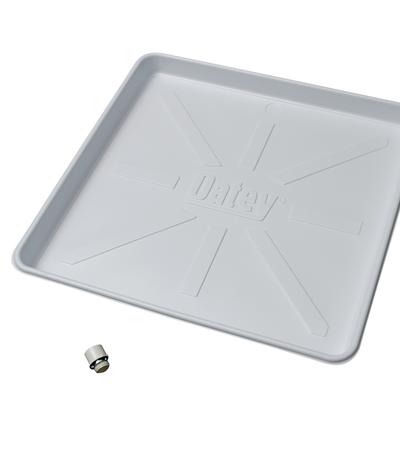

These are 15 bucks at Home depot, you can fit them with a drain fitting (I would not do this). These will sit on top of a bench, 28 x 30 inches. Buy 3 of them and you will have a easy to clean surface. They are thermoformed ABS. They will nest so you can clean up and put them away. Oatey Washer pans they catch leaky washing machines, I really would avoid the plastic panels, brittle, junk. ABS is used for refrigerator liners etc. Have good chemical resistance to darkroom solutions. Anything made for an automotive application will be resistant to everything and will be very durable. The Big Box stores also sell big plastic pans for mixing cement but to me they are to deep and awkward. Best Mike
Good call on the pans, definitely easier, thanks. Now I just need to make up my mind if I'm going to build a heavy wood workbench to hold a couple trays or if there's a simpler option lol.
