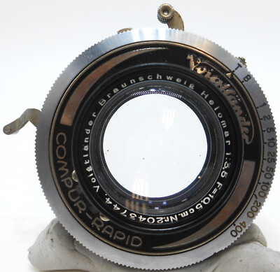

Alright I've realised that I own a #0 Compur in a 6.5x9 Voigtländer plate camera. At least it may be #0 judging by the diameter of the front threads, but it's pre-war, so as per Dan above, maybe it isn't actually 0, just close. I'll see when I have the lens. It lacks modern conveniences like click stops and flash sync, but as finding one seems a little harder than I thought, I'll extract it from the camera, at least for initial trials (and as these things go, it likely will become the permanent solution).
For the record, if someone with the same questions ever comes across the thread or as a note to myself, should I ever hunt for another one, it comes on a 10.5 cm f/4.5 lens.

Update: The pre-war Compur has the right threads in the front, roughly the right depth (I can't tell to more than half a millimetre as I don't have calipers), but the rear threads are too small, not the same is the front threads as on a standard #0 shutter. Other specimens might be different, the rear flange looks like it could be easily exchanged, perhaps different lens manufacturers used different ones.

I looked in the drawer, found a 105/3.5 Helomar in a Voigtlaender badged shutter threaded #0 front and rear, didn't measure tube length. There are a few on eBay.de at semi-reasonable prices.
