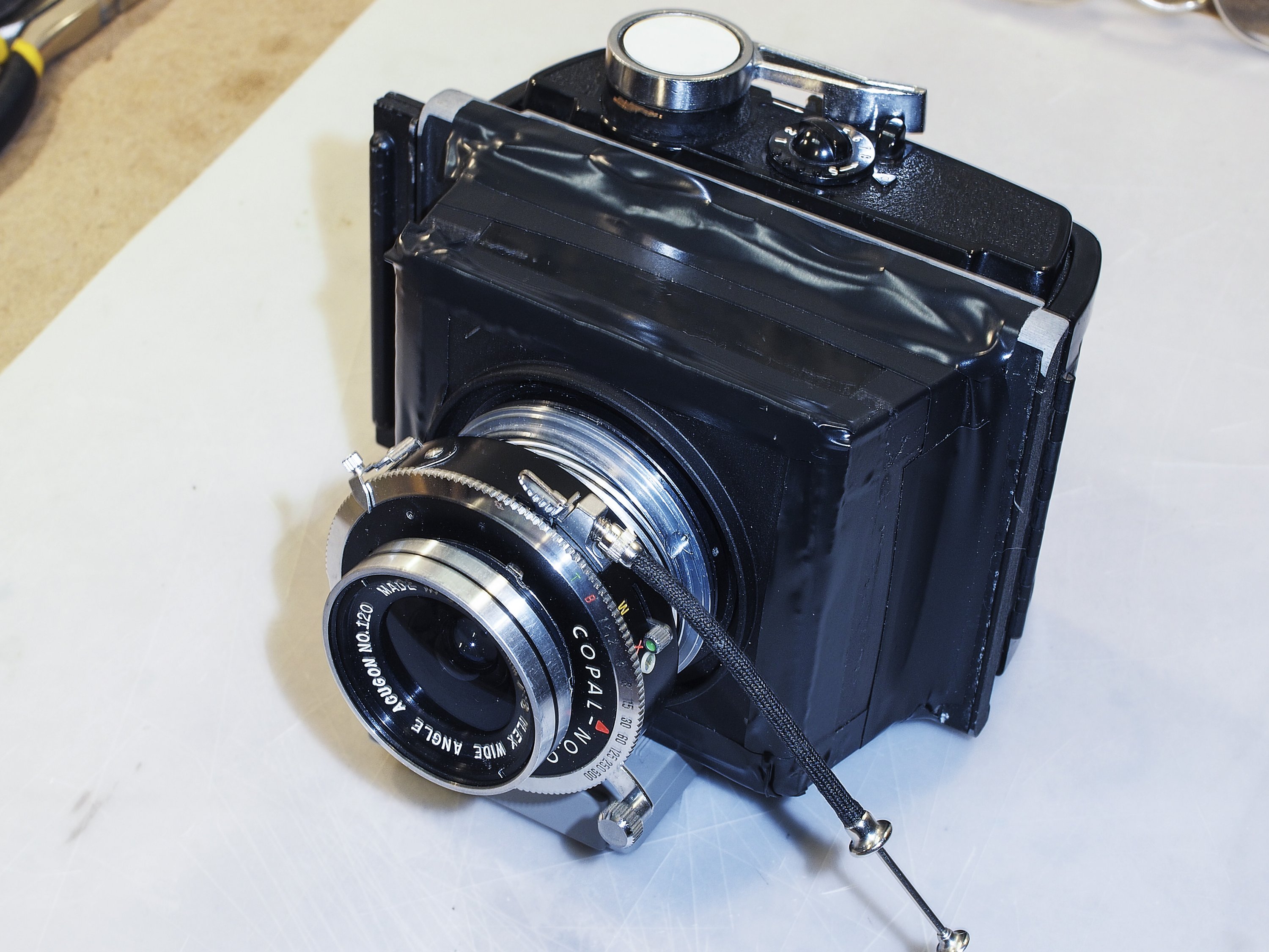

Well, it's a crude prototype but it works. 47mm Ilex Acugon mounted onto the helical from a Pentax 50mm f/2 lens. Box built from 1/16" ABS, back is a Singer Graflex 6x9 (that happens to give an almost exact 6x8 ratio). I tried a cheap viewfinder for a while and decided that guessing worked well enough for what I was doing.
Total- ~$160

Cute. Where'd you steal your Acugon?
Bought it from someone.... can't remember the name right now but a known small seller... Ivor? Igor? Drawing a blank, but he had it on his site a few years ago.
Steal? Is it meant to be tied into another camera body? I've never heard much about them except an Angulon or Super Angulon copy.
Dan Fromm
Mar 23, 2005
6,933
Dan, in this context steal means buy for a lower than usual price. Could have been Igor, I've seen Acugons on his site. Not long ago I bought a lens well below market. What a steal!
Acugons, like most LF and LF-ish lenses, can be mounted on most, if not all, cameras that accept lenses on boards. I said LF-ish 'cos 47/8 Acugons, like 47 mm jes' plan Super Angulons (both speeds), are really for 2x3; none will cover 4x5.
