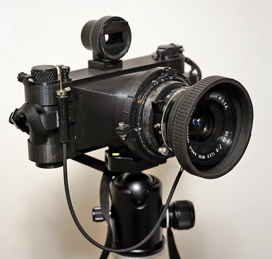

If you are a bit on the brave side, maybe consider a 3D printed superwide. Mine is 6X14 and I think these go to 6X17. Body was ~$175, finder $75 and LF lens/shutter of your choice. FOV is ~28mm with a 90mm WA. As you can see, I have done some hacking on this one. My kit totaled under $500. PM me if you want specific info.
