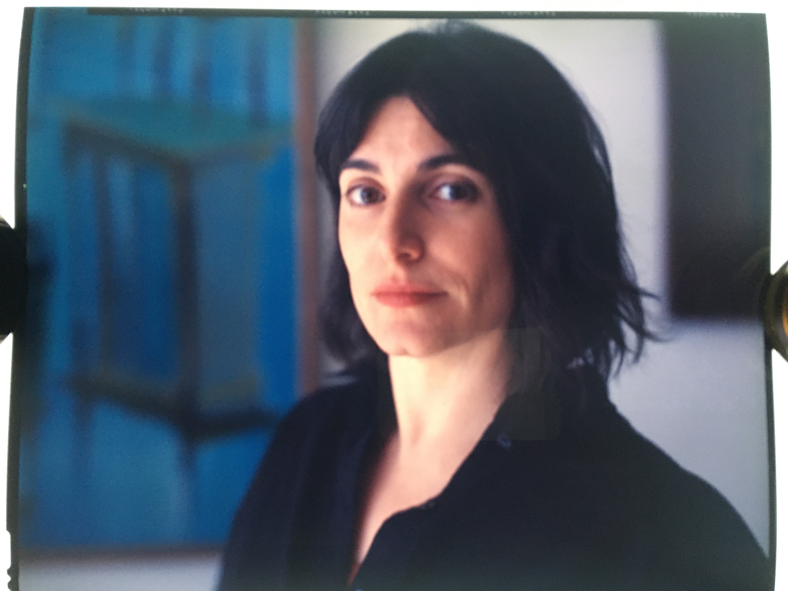

I have some 1996 expired Ektachrome 100 in 8x10 that would be a challenge to discern from fresh. In some cases the color shifts arguably improve the film.
Any advice on how to expose/process long expired Ektachrome? I have dozens of rolls from 2000, 1983, 1970's.
I shoot at box speed and develop normally. The oldest transparency (E6 process) I've bothered to shoot and process was 27 years expired, and it turned out very nicely in terms of exposure and color. An example is attached. It's a cell phone shot of the 8x10 on a light table, so it's not flat and there are reflections, but it should provide a general idea of what you might get with old stock. The film expired in 1996 and was shot earlier this year. Exposure was at ISO 100 (box speed) and developed using standard times in a Tetanal E6 kit.
I've also shot stock that was less expired but had major color shifts (like entirely green). It depends upon the stock and how it was stored, of course, but the one thing that has always been constant is exposure and processing. Even when the colors turned out crazy, I always got well exposed images with transparency stocks using box speed and the standard E6 developing process.
In my experience adding a stop a decade for expired film (the common internet wisdom) is a terrible idea when using transparency films.
I've never tried shooting anything older than this, so I can't speak to your 1983 or 70's vintage stock, but I'd expect it would be kind of toasty at this point.
thanks, I will probably try developing a single frame first from 35mm film, at box speed, then compensate until its right. I have a box of 18 rolls from 2003, and a few others from 80's and 70's.
thanks, I will probably try developing one frame at a time first from 35mm film, at box speed, then compensate until its right. Will have to trim the film manually, I've done this before with an old Leica iiif, which allows easy positioning of a trimmed piece of film. I have a box of 18 rolls from 2003, and a few others from 80's and 70's. Don't want to waste them.
