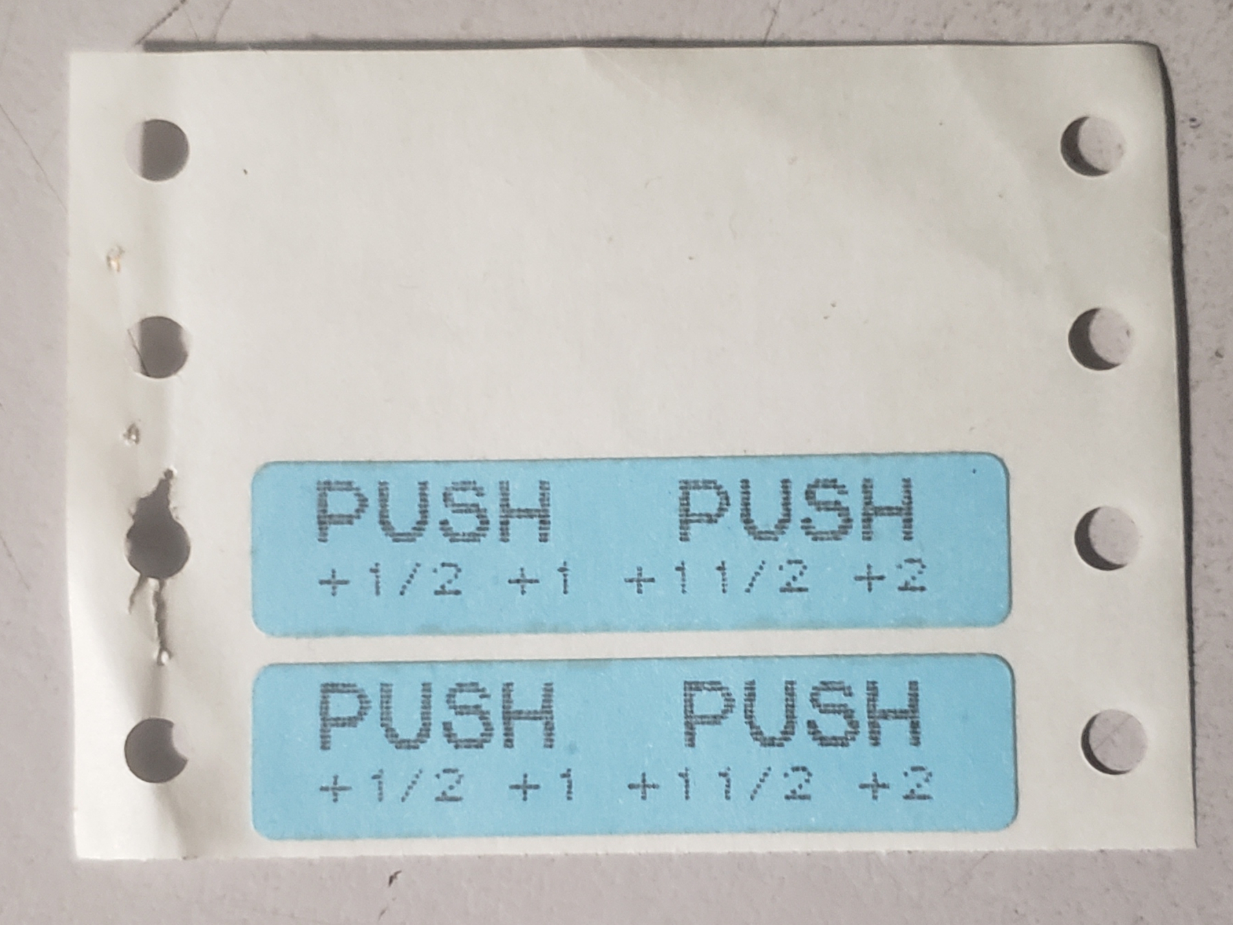

I still have these from The New Lab (SF), c. 1990.
I'm ready for when they decide to go back in business. 🤪

No wonder they went out of business - they got tired of everyone pushing them around. Push/shove, push/shove, "wait your place in the line".
