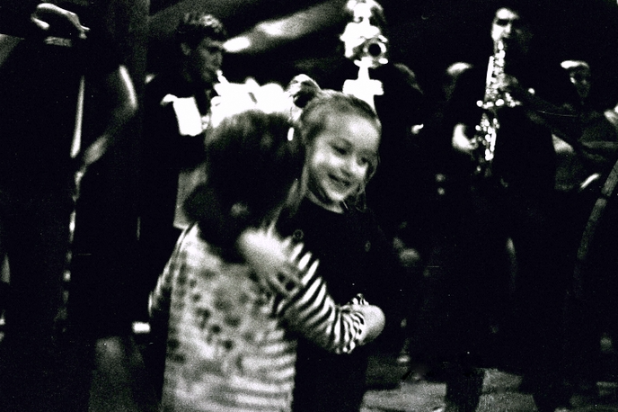

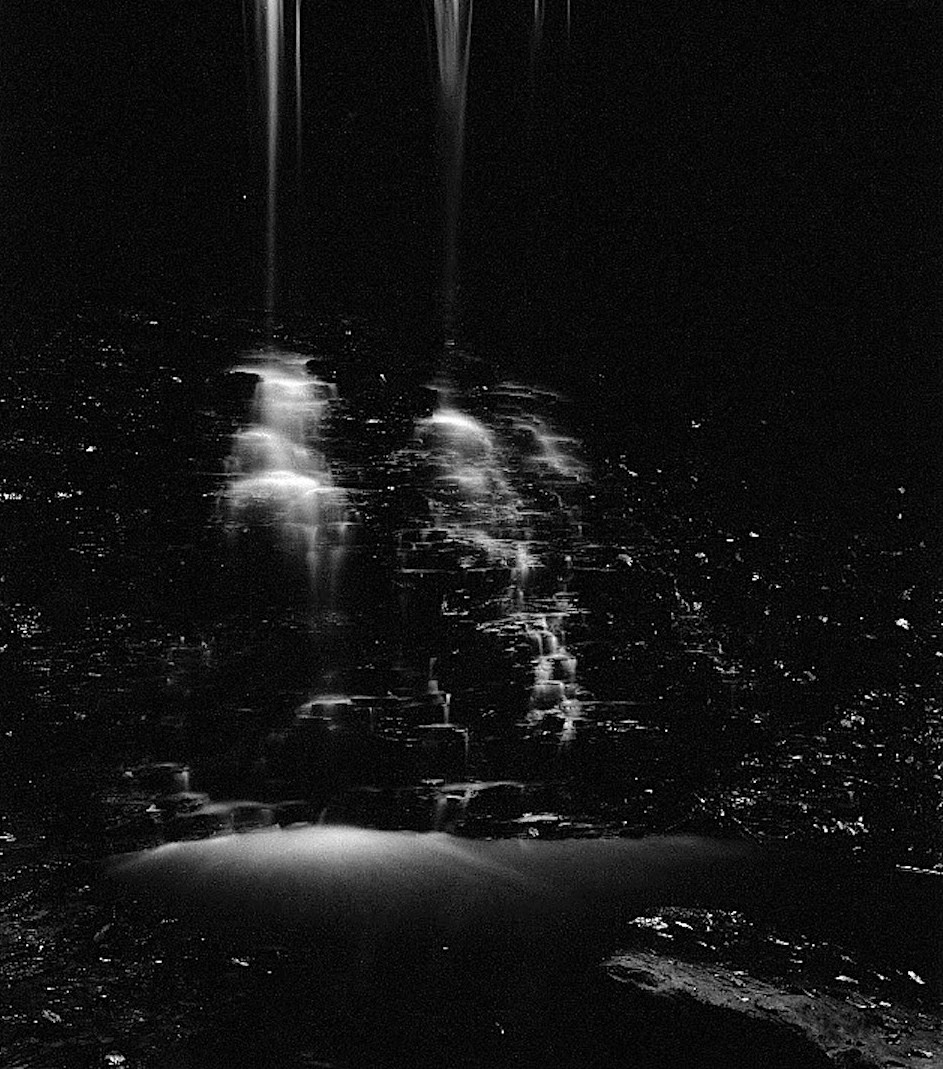

Below I'm sharing two examples of pushed film: the first for aesthetic reasons (a scan of a print), and the second out of necessity (a film scan). Does anyone object to them solely because of the lack of shadow?
Don_ih
Jan 24, 2021
8,715
Ontario
Your first example does not look pushed.
Your second example does.
In your first example, there is no loss of detail anywhere that matters - so it kinda looks like it was exposed properly. I'd not guess it was pushed.
