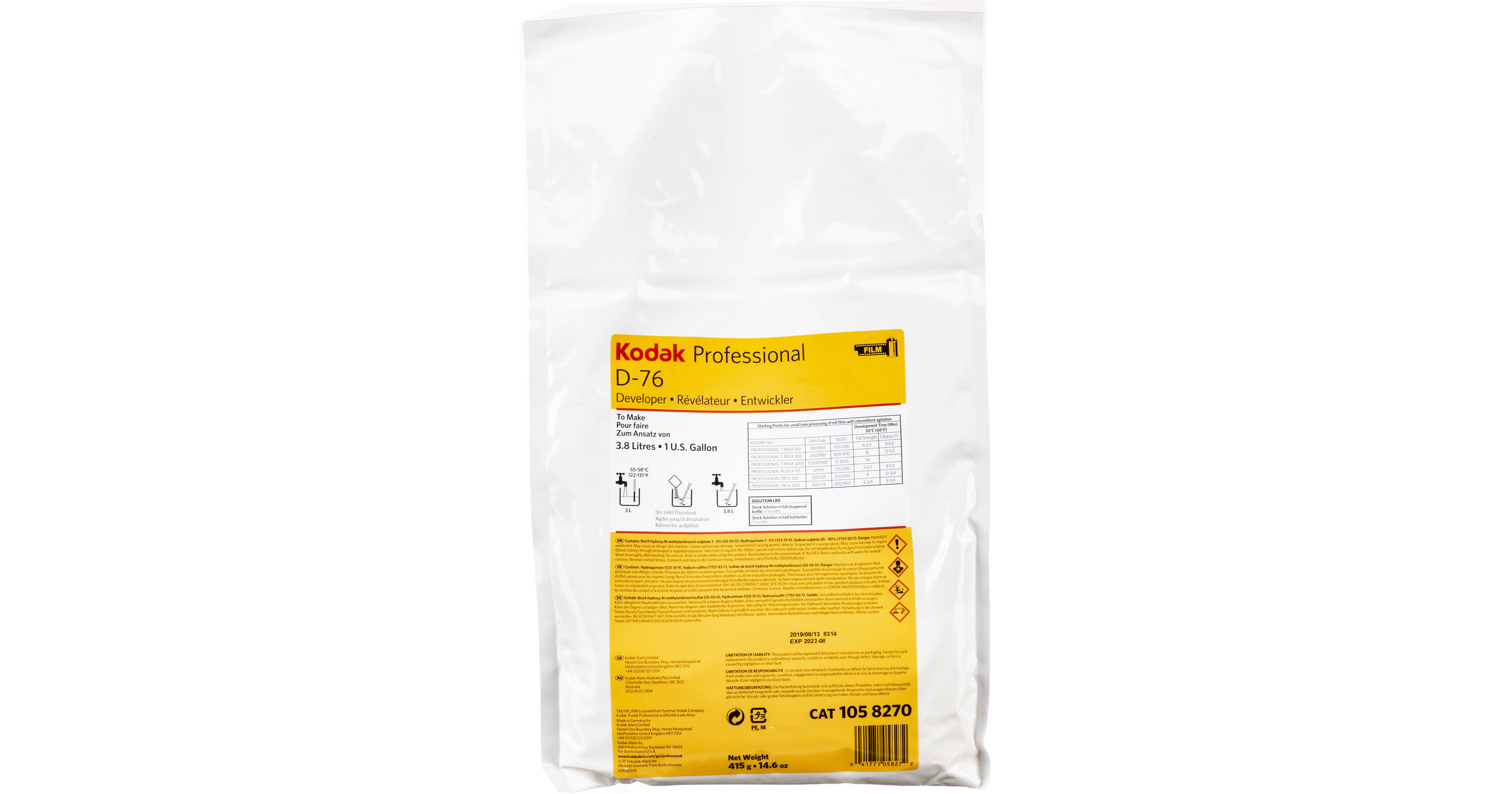

I have nothing against D76. If it were the last developer option on earth, I could make it work competently for my needs. I just have other developers I prefer instead, and for valid reasons. But this whole thread is largely moot with the local darkroom beginner classes, since they avoid TMax films entirely, and recommend something easier for beginners and their so-so TTL metering skills, like FP4.
Drew, lots of nonsense.
HC-110’s sole purpose of existence was to supplement D76 in the commercial and art world.
And no, artists, commercial photogs, and amateurs, that mix their own developer will never outnumber the ones that buy commercial developers.
D76 is still a huge Seller.
I have no idea where you get your numbers but it’s definitely not planet earth.

D76 is the bar that most developers try to meet or exceed, and it is the developer that codac uses to determine the ISO value, there must be something to that. There are several D76 clones that people use, I do not know if they should be considered D76 or not, and what about DD23 (divided with the borax bath) some suggest that is the pre-curser to D76, that bath mixed together. Who knows and who cares, I certainly don't I don't buy any codac products anymore, ever .. the company has let me down for decades, and I don't support companies that don't Kare.
