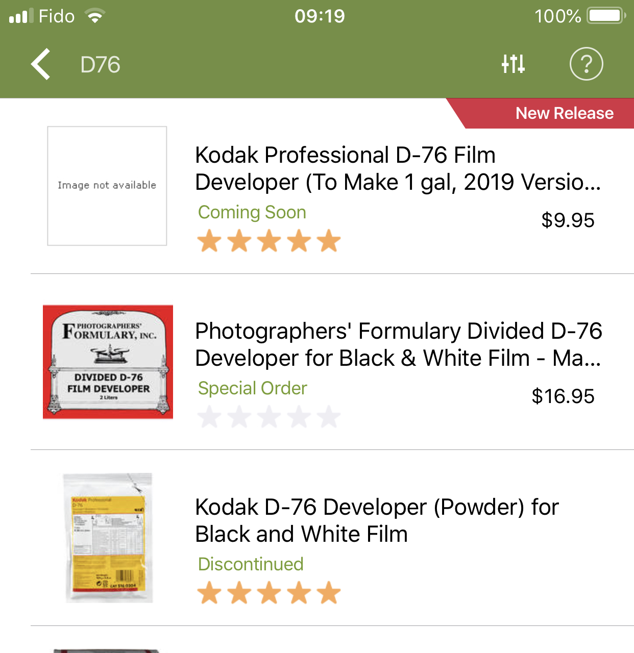

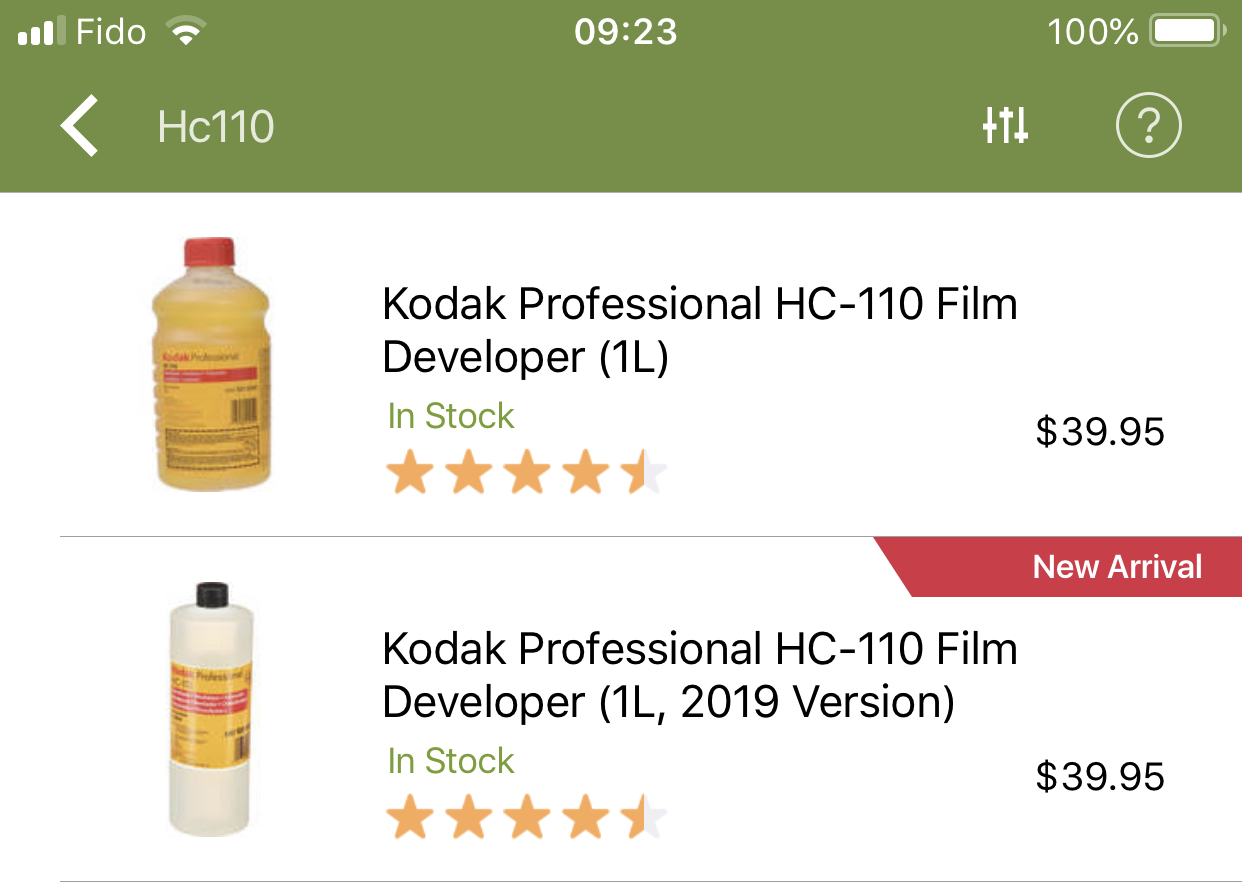

And where does this news come from?
Simply from BH’s website. Xtol as well...
Has there been any word on an actual chemical or manufacturing process change for Kodak's developers, or are you basing this 'change' purely on a new SKU that has as much chance of being driven by the marketing or accounting department?
I’m doing this the amateur way.
I am basing it on B&H statements: D76 and XTOL “new release” as well as seeing the old D76 being “discontinued”.
MattKing's link to the thread with discussions on the MSDS changes would seem to strongly suggest actual chemical changes going on [Or that someone had horribly screwed up past documentation?], but SKU changes and updates to package graphics seems to be a poor method to judge how different something is.
We do live in a world where ten different companies will buy the same product out of a factory in China, stuff it in their own box design, and market it as "New and unique!" after all. But maybe I'm just overly cynical and wary of marketing types?
We have all become extremely cynical in today’s world.
However, in the good old american way when it’s only a new packaging in question, the companies will usually specify “new packaging” or “new packaging, same great taste/formula”. In this case the mention of “discontinuation” clearly means that we are talking about a new/different product and not just a new packaging.
But again, we can not be sure anymore.
Matt's right, here. It will be found in the MSDS.
