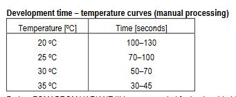

bernard_L
Feb 17, 2008
2,027
From:
https://www.foma.cz/ew/ac05d713-bad1-469b-b2f6-75de75962a96-fr
