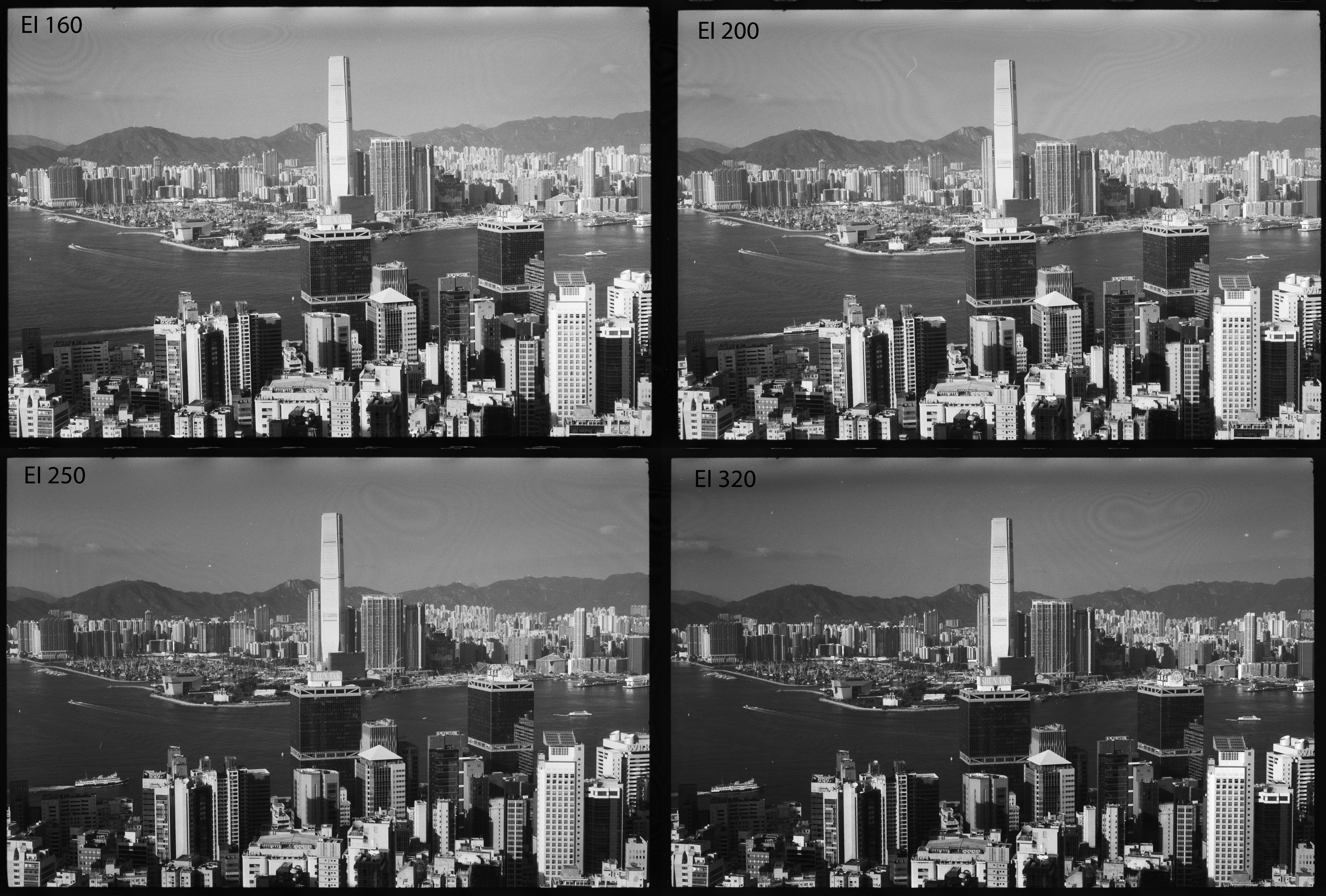

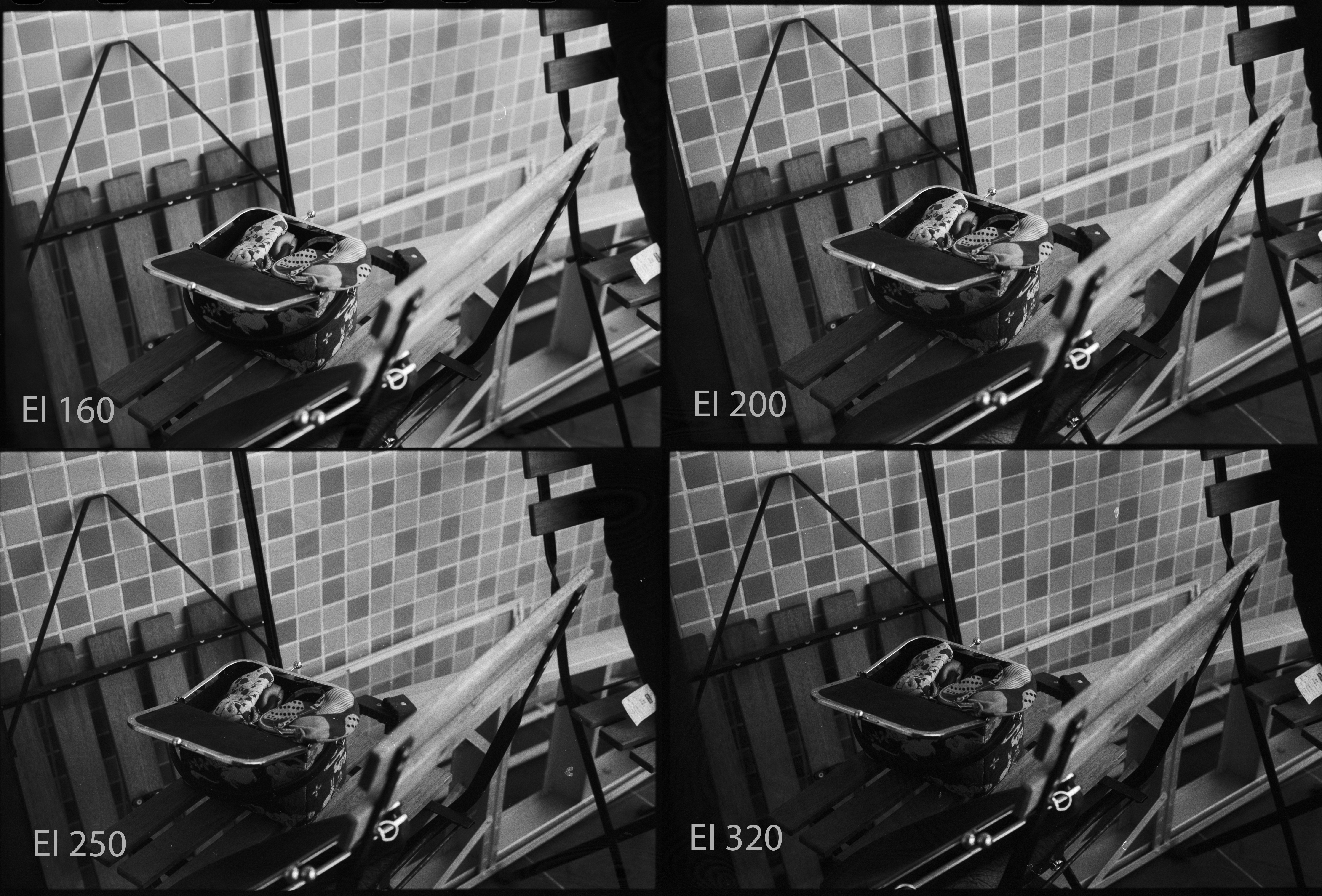

Thanks! It's great to be back to Photrio, 15 years later. How time flies!
I'm adding some pics here scanned using Nikon 9000ED (pls ignore the newton rings, they were introduced by scanning 35mm strips on FH869G holder for 120 roll films. I don't have a 35mm holder handy at the moment).
Again these are dev-ed by Xtol 1+2 dilution (100ml Xtol + 200ml tap water) one-shot, 12'30" at 21C with a 3D-printed rotary processor at 60rpm.
With incident metering at close distance using a Gossen Digisix, EI 160 seems to be the best for shadow details. EI 200 very useable too, while EI 250 is losing some info in the shadow. EI 320 is too thin and we can see dusts/scratches/all the minor blemishes on the film base start to become visible. It's a typical signal/noise ratio thing. As the silver density decreases with higher EI, dusts etc stay the same and become more visible.
At the infinity scene using yellow filter, with large portion of sky in the pics, EI 250 became somewhat useable, although the signal/noise ratio still seems better with EI 200. EI160 is a bit overexposed in the highlights. Metering in this case was done with Leica M6's internal TTL meter & confirmed with the LightMe app, assuming +2/3 EV for the yellow filter.
I have done portrait / flash lighting etc with similar settings and the conclusion is largely the same - EI 200 seems to be the best rating. I could try another test with longer processing time (say 15min) but I doubt result would be much different given Foma's curve for its 400 film which plateaus at ISO 250 per their standards. And contrast would be likely too high for EI 250 for longer processing time.
those look really nice, thanks for sharing.
I always found Foma 400 a bit to rough for bigger enlargements, but I exposed at ISO 400 and developed in XTOL 1+1 or 1+2.
Your examples look noticeable better, so it seems the higher solvent of stock XTOL and more exposure makes it quite a nice film stock.
Thanks. These are actually not deved in stock Xtol. I mentioned earlier in another post in the thread that they were 1+2 dilution one-shot. Stock Xtol is nice, but somewhat expensive and less economically/eco-friendly to use. Replenished Xtol on the other hand is eco-friendly and works fine for almost every other film types including Foma 100, but Foma 400 is an exception and it's just oddly difficult to build up density on Foma 400 in Xtol-R for reasons I don't understand. Thus I ended up using 1+2 dilution for Foma 400.
ah interesting, thanks for the clarification.
so I must have have an unsuitable subject or maybe the extra exposure you gave it helped to tighten up the grain structure (it war rather pepper grain like in my tests)
Yeah EI400 would be too underexposed for Xtol regardless of dilution, as the official foma 400 curve indicates max iso at 250 for stock solution. I personally would take another 1/3 ev away from the official data and wont go beyond EI200 for foma 400 with any xtol dilution.
But the grain structure might not be solely based on EI. If you look at my EI 320 exposures above, the grains there seem ok to me. If your grains were much worse, I wonder if it was temperature or something else that might have played a role in your case
