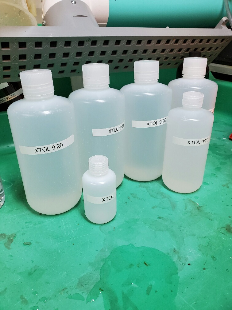

Here's how I do XTOL. Every container as full as possible. Have several small bottles for storing partials. I throw away any volume that doesn't fill a bottle. For replenishing I have a couple old glass gallon jugs. To start I fill the bottle full (takes over a gallon). Then after use put most of the developer back in the gallon jug, add the required amount of replenisher, then top off with any remains of the used developer, then toss any extra.
