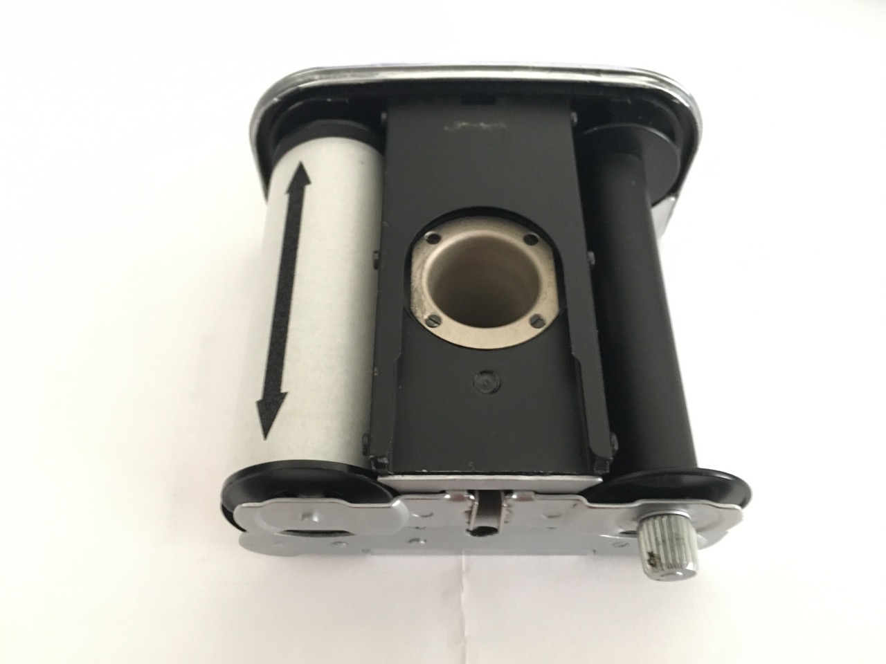

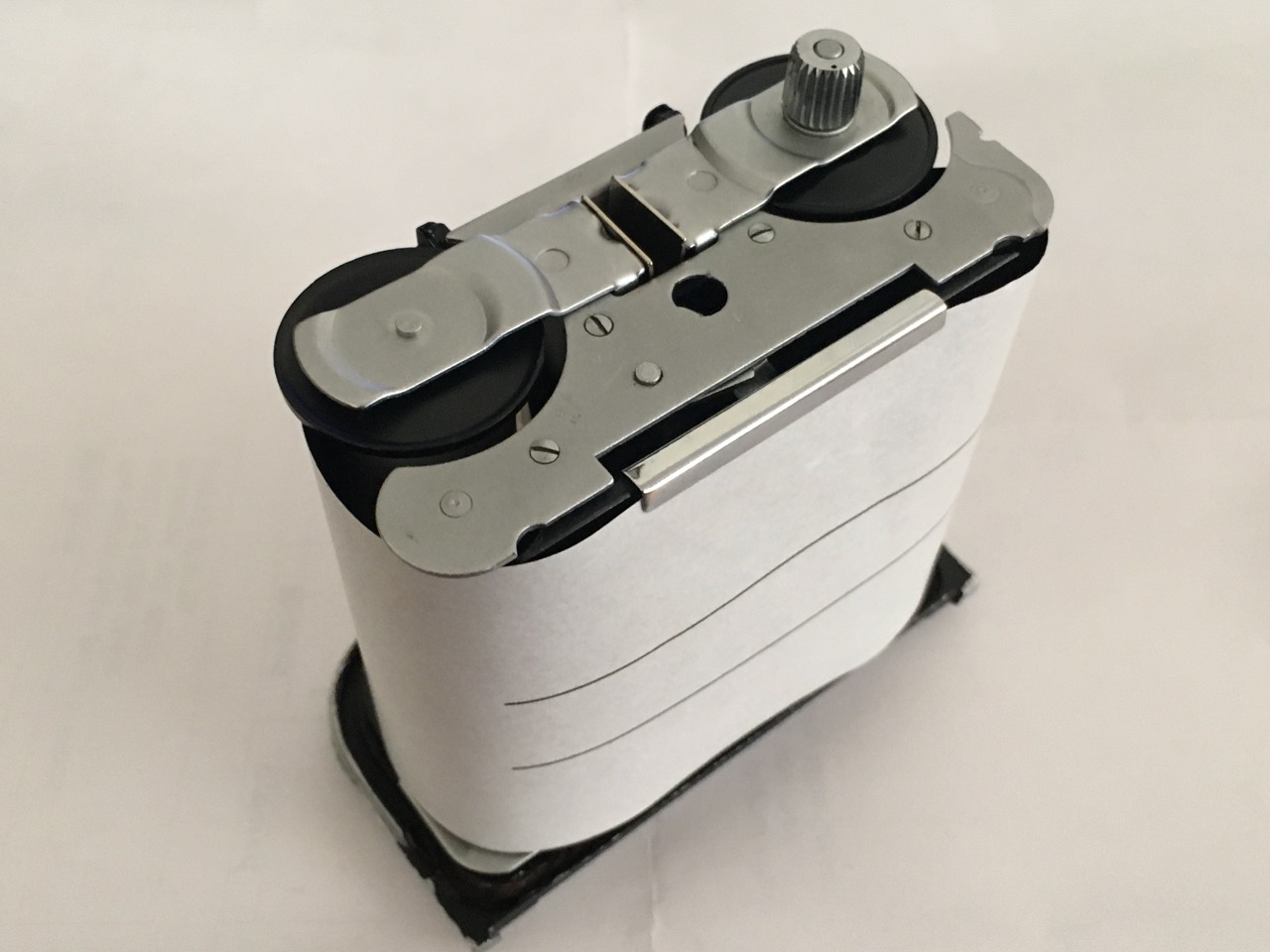

To be clear, this is what I think happened. Clearly this doesn't happen all the time since you get some rolls that are good. But for the rolls that are blank and wound the wrong way on the takeup spool, perhaps you were in a hurry, and I think you loaded the supply spool the wrong way around. This is a Kiev back so it doesn't have a start mark, but I lined up the backing-paper arrow with about where the Hasselblad start mark is. The supply spool is on the left, and the take-up spool is on the right and the film is winding onto it inside-out. It is possible to line up the paper arrow, but feed the film back-to-front.
View attachment 315706View attachment 315707
I'm sure you're right!! This is the only way i can think of that it can be configured wrongly and still have the arrow match up.
Thanks so much.
