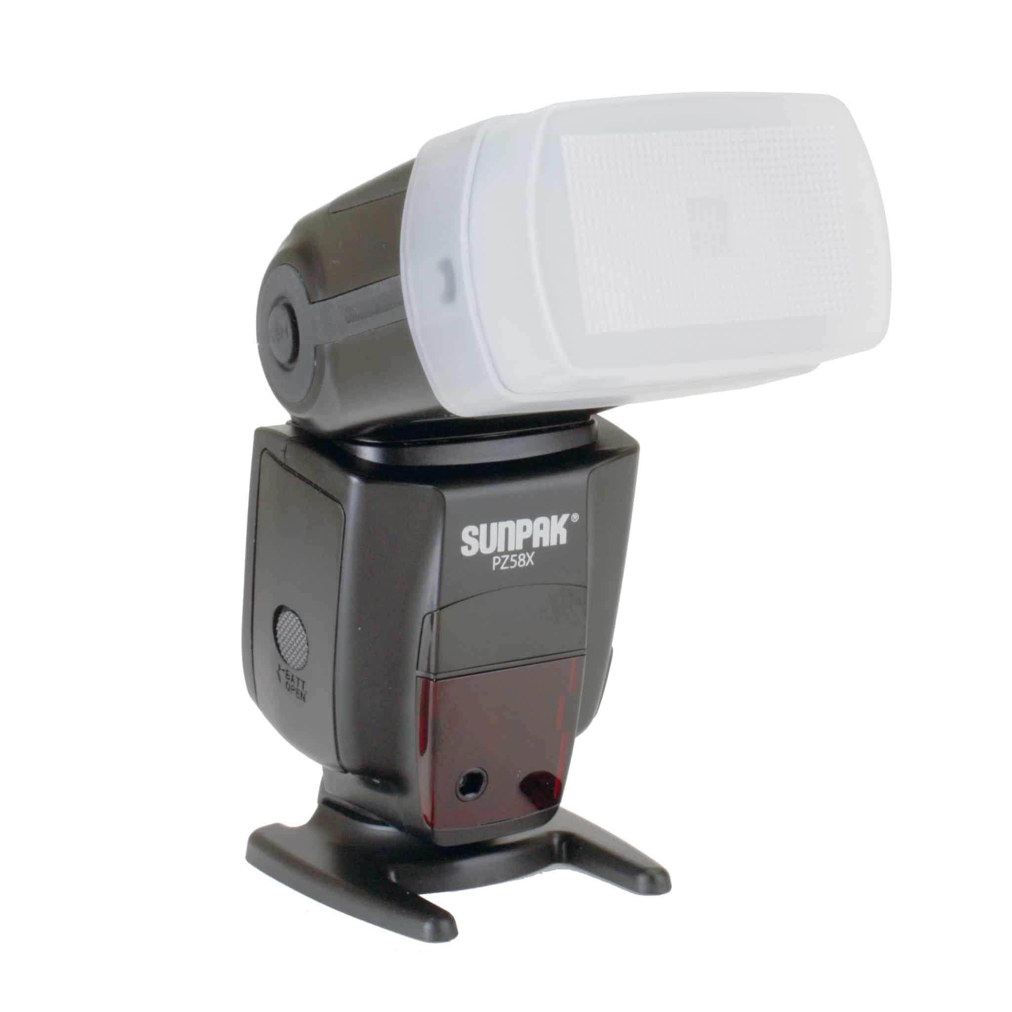

If you have a film camera and it doesn't support TTL the most convenient kind of flash to use is one that has an auto mode that uses the sensor on the flash. You can buy old flashes that have this feature and cheap but if you want a new one you're out of luck. Cheap new flashes like the Godox or Younguo are quite good except that they don't have this feature. The only new flash I found that has this feature is the Nikon SB-5000 which is way too expensive to buy if you have something like a Pentax KX or Nikon FM etc..
I suspect that the market for people who wish to use new flashes with 20th century film cameras is quite small. While the Tocad website still lists, the Sunpak PZ58X, it seems to limited to "new old stock."
I own this one, but I was disappointed to find out it was incompatible with my Z8:
If you own more than 1 brand of digital camera you would have to have different flashes for different cameras. Besides some old stuff like the Metz 45-CL4 would work just fine on your Z8 using non TTL auto mode. So it's not about using old film camera only.
