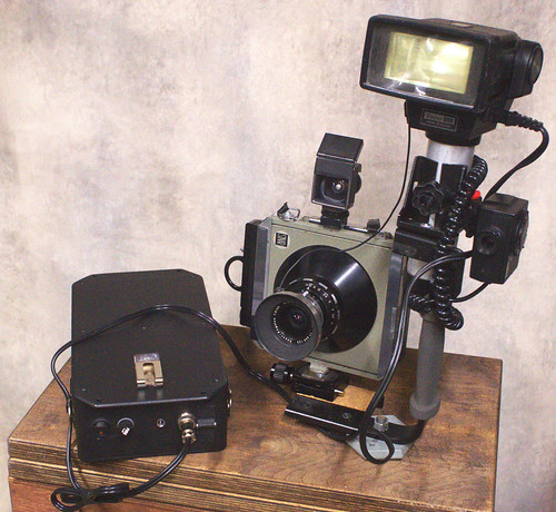

Here's mine ready for further testing:
Sinar Norma 4x5 Handy Super BubbaPack HV Battery Handy Bubble Level by Nokton48, on Flickr
A Friend built me this "Super BubbaPack" high voltage rechargeable Battery, for my Vivitar 365 Flash Units. Recycles LIKE NOW, no delay. This fires automatic exposure thyristor out to SEVENTY FEET, good for any situation, really. Shown on my homemade Sinar Norma Handy. My latest embellishment on the Handy, is a modern Sinar Handy Bubble Level/Mirror Unit, attached atop the Mamiya 7 43mm Viewfinder. Useful for "Hail Mary" shots, not looking through the viewfinder. Initial test shooting coming up soon.
Latest embellishment is the "Photoflex Large XTC" Inflatable Softbox. My preferred way of diffusing specular flash when hand held shooting. Two are coming here new in packages.

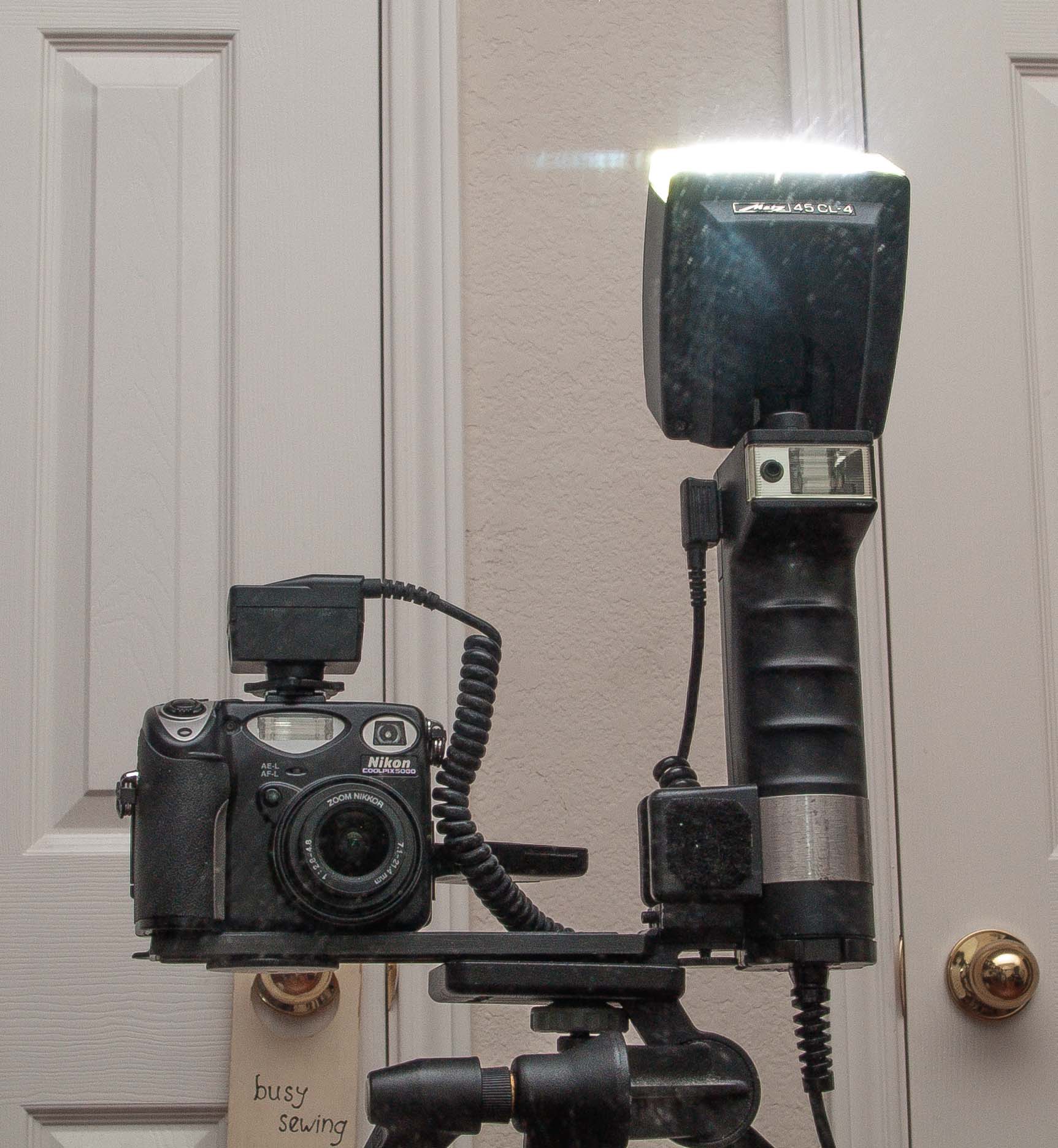

Here is mine! The camera is a digital. The short coming of the GN is that it only works for direct flash.

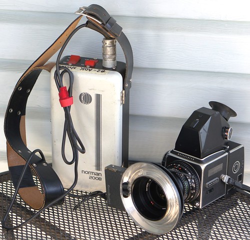

Here's another from over here:
SONY DSC by Nokton48, on Flickr
My CFV16 Hasselblad Fat Digital Back 36x36cm 60mm T* Distagon 500C/M 25th Anniversary P&F 200J Ringflash with Hasselblad Adapter. I used to use this Ringflash for Fashion Photography, back in the day. LOL. Now the CFV16 Digital Back gives me instant gratification. The Flash and Norman 200B pack (two packs actually) went to new York City Flash Clinic (sadly gone SNIFF). They Hot Rodded it to the Norman pack, everything needed adjusting by them, so the flashtube didn't "sparkle" after firing. This until runs off on 12V Dry Cell Batteries, trickle charged. I've replaced the batteries several times, just solder 'em right in. This works great and is an UBER HOOT to shoot with. Many more uses for this thing up ahead. Maybe buy some more cheap batteries, they are available on Amazon.
No thyristor but don't need one. Guide numbers and instant feedback are a delight to use.
