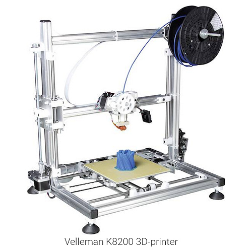

I looked into the suggestion of @Luckless (#14) to modify a 3D printer for stitching, with an X-Y adjustment for a film-holder and height adjustment for the camera, and came across the Velleman K8200 3D printer which is a relatively cheap kit to build yourself.
Here are some thoughts for modifications and possible limitations.
The printer has an open frame which allows modifications for mounting a camera and a film-holder. I think the best place for a camera is on the position of the nozzle (which is left out) because it has a height adjustment, and the print bed is replaced by a film holder where it can be moved in X-Y directions by the gear below. In this configuration a flat LED light source could be placed below the film-holder between the feet of the frame (for example a Kaiser Slimline LED panel or equivalent).
The camera is relatively heavy compared to the nozzle so perhaps a contra-weight is needed to level that out. I think the camera should also have an angle finder to allow focusing looking from the front.
If the space between the X-Y guide rails for the film-holder is too narrow for the light source to illuminate the film completely, you could perhaps replace some parts to increase the distance.
All adjustments X, Y and Z can be made manual by leaving out the stepper motors and by mounting knobs, but you could theoretically make an automated system too (all software is open source).
The overall dimensions of the frame are width=50cm, depth=42cm, height=60cm, which seems sufficient for 35mm and medium format films. However, the height of the vertical guide rails is much shorter than 60cm so perhaps they must be mounted higher up to get sufficient distance between camera and film.
As the camera is the heaviest, I'd have it fixed to the bed. As if on a tripod with the lens horizontal. Have the neg carrier controlled by the x and z axes. The y axis would control focus by jogging forward and backward. afaik, some cameras have a video output so focus could be achieved by looking at a monitor.
Good catch, that is probably better. So, when I read that correctly the camera is looking to the backside of the frame and the film-holder is hanging down vertically from the extruder carriage. An advantage is also that the backside of the film-holder is now free to position the light source behind it.
I think this setup has also some disadvantages.
The depth of the printer-frame is about 40cm, but the range of moving the camera on the guide rails is much shorter (the original printer range is 20cm in X-Y directions). You need a certain distance between the camera and film to focus. Perhaps a short 35mm macro lens could solve that.
In your setup the film-holder is mounted vertically to the extruder carriage, which has perhaps some movement in the bearings. If the camera is placed looking upwards from the print bed, and the film-holder is mounted horizontally from the position of the extruder, it can be attached directly to the rail (the complete extruder is removed), which is theoretically more stable. Point is, there is more room between camera and film. The sub-frames for stacking are selected with X and Y, and focus with Z.
That said, it is a certainly a good idea to mount the camera on the print bed.
A product overview of the Velleman K8200 printer can be found here:
https://www.velleman.eu/products/view/?id=412554
You can get PDF's with details from 'Download' link on that page:
https://www.velleman.eu/support/downloads/?code=K8200
The assembly manual is extremely detailed so with that you can better judge in advance if modifications are possible. There are several languages available.
Edit 28-03-19.
Forget what I said about the extruder carriage. The extruder can't move in X-direction, it is mounted on a fixed position in the middle of the rail.
