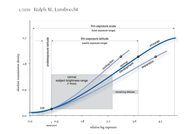

I don't get it, because I don't find this to be the case at all. What does that MEAN? I don't see how it could have more exposure latitude than TMAX by any measure, so people must mean something else when they say "more exposure latitude".
I agree. I think some descriptions of "exposure latitude" I've seen are quite misled.
The exposure latitude of a film is evident in scenes with low SBR's and a characteristic curve that does not shoulder-off too quickly. The film can tolerate additional exposure in the shadows of a low contrast subject without losing the ability to control the negative densities for necessary detail and high value tonality at the high end up around Zone VIII and IX.
As SBR increases, the exposure latitude decreases. When reducing exposure to keep control of the desired highlight ends up making your important shadow area lose detail in the negative, then the subject contrast is very high and you have little or no exposure latitude to play with.
...As SBR increases, the exposure latitude decreases. When reducing exposure to keep control of the desired highlight ends up making your important shadow area lose detail in the negative, then the subject contrast is very high and you have little or no exposure latitude to play with.
Quite correct.
Film exposure latitude is defined as the range of exposures over which a film yields images of acceptable quality.
