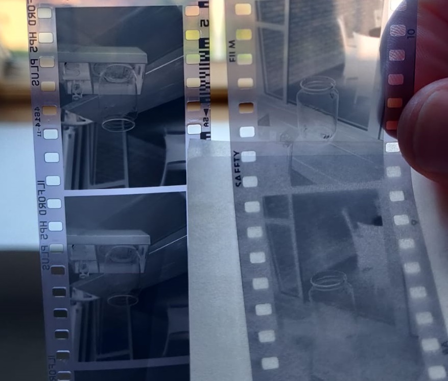

those look *marginally* thin but I'd have no problem making prints with those negs. Have printed worse. the proof is in the pudding, so try making a few prints and judge those.
Just some test shots to check the camera for light leaks etc..
If I put my black point on the negative border, pictures are very dark.
  • The first on is a big contrast scene, shadows inside and highlights outside but even this one is very flat
  • The one of the steering wheel is one of the better shots, all the rest look super flat.
  • The last on is a bit underexposed, lost detail in the shadow there
  • The other car pictures are really dull and lifeless but shadow detail looks fine
Quite confident that my exposure should be fine, except for a few mistakes I made. Had this problem 3 years ago as well when I used an external incident meter, which was accurate.
The negatives that are denser are way better to scan/print for me. Much less work needed to get them "right".
I now used the in camera meter, which is still accurate if I compare it to my digital camera.
These will print very good.
I'd definitely had worse negatives but to my eye there is not enough contrast upfront. Have to add too much afterwards.

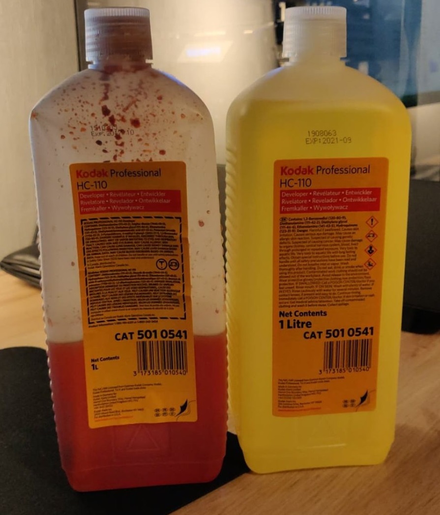

Could the HC-110 be exhausted due to age? Even though I read the syrup lasts for a very long time. Bottle is 1/3rd full. Any other guesses?
Since you had the problem three years ago and changing film does not solve the problem points to the light meter [in or out of the camera] is out of calibration. I had the same problem until I attended a week long class with Alan Ross. He said the problem was that my light meters needed calibration and he lent me his for a week. Immediately the problem went away. Contact George at Quality Light Metric in Hollywood. He is the go to guy for the movie industry.

I just shot the same scene again with the new agitation and NEW fresh HC-110. Same light metering, same exposure etc, .. WHAT a difference in density!!
Left is the new HC-110 bottle + different agitation: 4 turns at 30 sec interval - 30 second initial
Right 5 y/o bottle with this agitation scheme: 4 turns every minute - 10 second initial
As an extra... my old HC-110 bottle compared to the new one
Different film as well?
