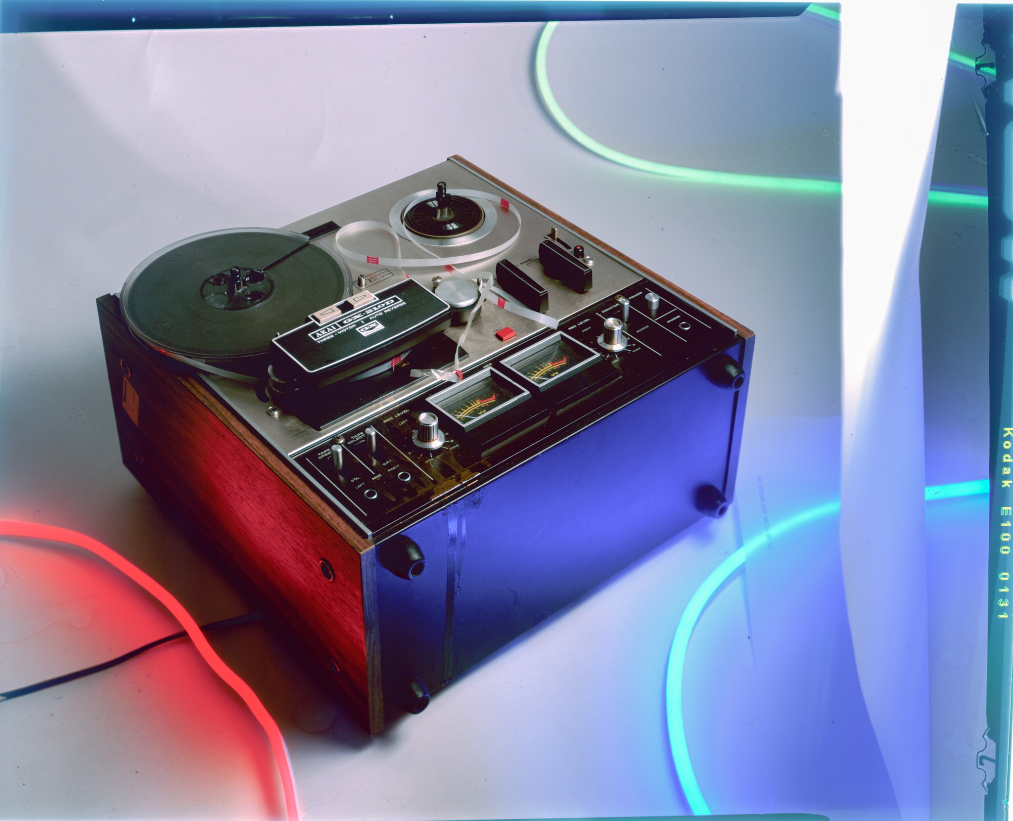

Guys, i want to re-take my test shot tomorrow and to try and get a exposure better.
Please take a look at the first version below.
I'll get my middle grey reading from a grey card placed on top, but it's be roughly equivalent to the brushed silver / bronze top of the R2R machine.
I'm shooting Ektachrome 100.
My question: what reading should i get when spot metering (film plane) on the LED lights on the floor? I mean in relation to my middle grey reading. Their brightness is freely adjustable via an iphone app so i can dial them in just right.
In the version below i had them much too bright compared to the rest of the scene, so after increasing the exposure in post to correct my original under-exposure, they became all washed out.
The reading that gives you the result you want.
That probably sounds flippant, but it wasn't intended to.
Spot meters aren't really designed for reading the light being emitted by a light source. They are designed for reading the luminance of light reflected off a subject.
The intention being that you take that reading and then adjust it, depending on what tone you intend the subject to have in the final print or screen image.

I don't see what difference it makes if the light is reflected or emissive, light is light when it arrives at the film plane, right? Not trying be argumentative, please correct me if i'm wrong!

LEDs and real neon (or the other gases used in neon tubing) are very different light sources. Neon is much more spiky in its spectrum.
There is basically no way of knowing exactly how your film is going to react.
If it’s dark, neon lights will always register. Do you want the neon to completely dominate or do you want it as part of a scene?
It’s easier to measure the background and decide how much you want to dial that up or down.
The challenge with a light source within the frame is that it is difficult to visualize how it is supposed to look in the final result.
With something like a rock, you can look at it and say - it looks like it should appear about 1 zone brighter than a grey card, so I will take a reading off of it, and then give the film one stop more exposure than that.
But in your case, you have an adjustable light source within the subject - an adjustable "rock" as it were. And a meter that is designed to read light reflecting off a subject, rather than light being emitted by a subject - the meter has a built in 18% (or 14%, or 12%, or - depends on the meter) adjustment built into the calibration - the meter assumes that the subject is absorbing something like 82% of the light hitting it.
You're right. Light is light.
But Matt is also right:
This is especially try with narrow-band light sources like LEDs which may interact with the spectral sensitivity of the film and the light meter in unanticipated ways. When shooting slide film, you may end up being slightly off as a result. But I wouldn't worry about it too much.
You're the boss! But in general, I'd try to stay within +2.5 stops from your middle grey reading for the brightest area on the floor that the light shines on, and then let the actual light source itself fall where it may. This is a bit haphazard when dealing with slide film, but because your light source is essentially monochromatic, it'll still look nice and colorful. If you were to balance your readings on the actual light source itself, you may end up with a somewhat unfortunately balance. You'd either underexpose the entire scene a bit, or you'd dial the LEDs down properly and end up with too little of a colorful effect on the surroundings to be worthwhile. So I wouldn't worry too much about slightly blowing out the light source itself. With white lights, the story would be slightly different, depending on the scene and the effect you're after.
Careful with the brushed aluminum as it's highly reflectant so how it meters depends strongly on how it's lit - more so than the more matte surface of a good grey card.

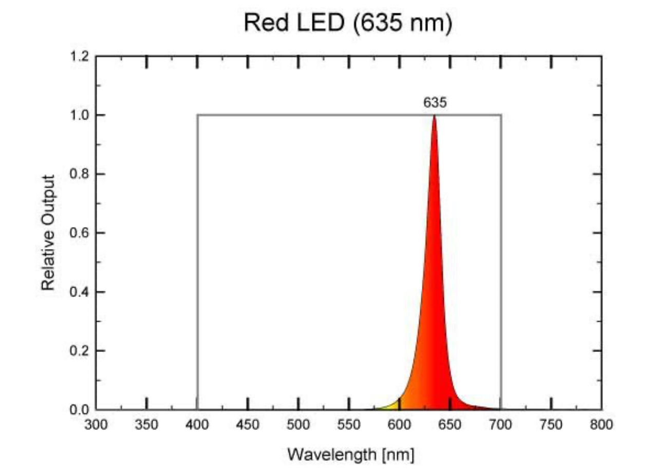

Colored LEDs are also very 'spiky', i.e. narrow-band emitters. For photography, they're quite equivalent to neon. LEDs are just easier to adjust. The caveat is that dimmable colored LEDs tend to be PWM-ed and this can result in problems with short shutter speeds and low PWM frequencies. Sadly this is difficult to predict. With longer shutter speeds (1/25 and longer) it shouldn't be a problem.
White LEDs are a different story. White LEDs and colored LEDs should be considered separately, with white LEDs being more of a mixture of LEDs and fluorescents.

@Helge I see what you mean now - by 'spiky' you refer to the various spectral peaks of Ne while LED typically only has one (and perhaps a very small secondary one). Yes? I referred to the width of the peak(s).

About the LEDs: thanks for the info, i guess i'll just play round with them, maybe choose like +3 for the light itself and see what happens with that.
I'm not too worried about how they translate onto film, i did a few test shots already with colored LEDs on various films and cameras, and as long as the exposure is ok, the color was also fine. I'm not looking for scientifically accurate color anyway, if it's a little off, who's to know?! 😅
