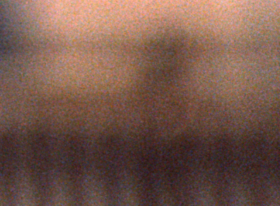

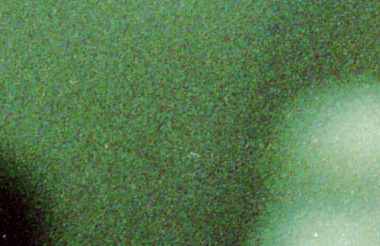

By means of illustration - not that it's a scientific proof or anything, but still:
Sensia 200
Fuji NPS160
Same scanner, both 3200dpi 100% crops, no sharpening or noise reduction applied, no in-scanner grain reduction, smoothing or ICE.
Whats funny is that high speed slide films, ISO-400 and above were always a lot grainier than color print films of the same speeds.
I dunno about that.

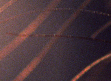

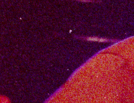

Sensia 1600, pushed to 3200:
Fuji 400 color negative (rebranded for a local retail store):
(2004)
(1998)

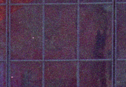

Sensia 400:
Ektachrome 400:
All examples exposed in 2004 (exception noted), on freshly purchased film, lab-developed and scanned on the same scanner.

I dunno about that.
Sensia 400:
All examples exposed in 2004, on freshly purchased film, lab-developed and scanned on the same scanner.

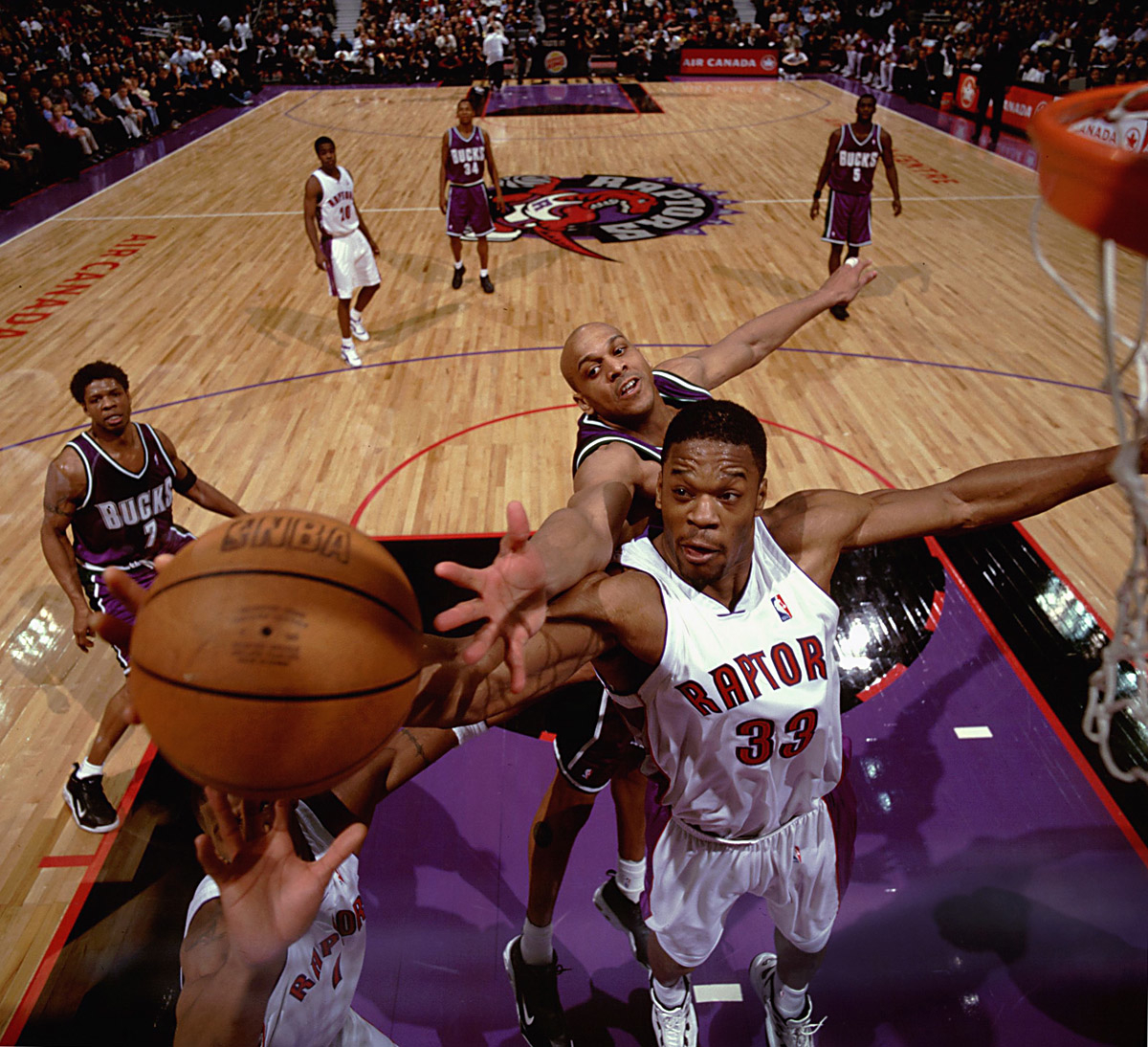

After I left the newspapers and went to Major League Baseball and then the NFL. Everything was shot on slide film. We bought cases of Fuji100 and would push it one stop as standard. When Kodak came out with Kodachrome200 I switched to that and it became my favourite film. It took about a week to come back from the lab but you could also push it to ISO500 (ASA back then), but that had to go to Texas from processing and would take about two weeks.
I became very accurate with exposure since there was no bracketing with sports.
Fun times.
This shot from the NBA was done through the backboard with a remote Hasselblad with a 40mm lens, using strobes to light the entire court. It was shot on Ektachrome 100.
It's magnificent!
