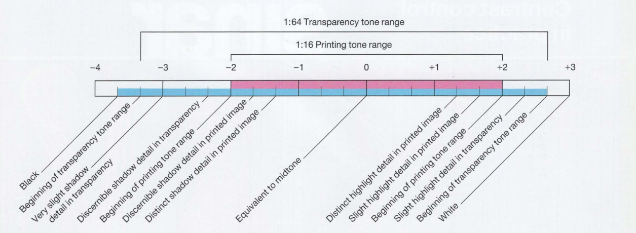

Hi folks,
I'm wondering: with the difficulties involved in shooting slide film (limited dynamic range), why was it a popular choice for studio photographers in the 90's and earlier?
To maybe answer my own question i've been looking at Sinar 31 (download here: )
.....and something that strikes me is that the very limited dynamic range of slide is closer to the even more limited dynamic range of print media.
So maybe the idea was that a successful slide exposure was more likely to translate well to print?
Especially curious to hear from anyone who was working with slide in the studio in the 90's and before.
Thanks!
That was a large part of it, yes. It did away with the inherent trouble of color balancing the results from color negative film. The image on the slide was precisely how the photographer intended it to be; no second guessing about filtration settings etc. necessary. Another part was that slide film had superior characteristics in terms of fineness of grain for instance, so it was technically very well suited to form a strong link in the imaging chain.
The problem of dynamic range was mostly worked around because a lot of the work was done in a studio environment will full control over lighting conditions.

Art directors liked/required it as well - they could see exactly what the photographer produced, without the intervening contribution of a colour printer.
And as a result the publication infrastructure for things like books, magazines and catalogues was designed to deal with that material.
For similar reasons, National Geographic photography was almost all Kodachrome for a significant time. National Geographic's in house Kodachrome lab was for a number of years the highest volume 35mm slide Kodachrome lab in the world.
(The other high volume Kodachrome labs had total volumes that were higher, but like all such labs during Kodachrome's heyday, a substantial portion of their volume was movie film - primarily Super 8).

Ah-ha, so it was also for the convenience of the people downstream in the chain, to easily and quickly view the image with the correct color.

No, there isn't. And I would not consider it a "convenience" for the people downstream, rather a requirement. They were the clients and end-users. That's who you were shooting for and they were the ones paying the bills.

Art directors, curators, editors, etc could spread out all 36 35mm slides on a light table and pick the ones they wanted quickly. There was no need to spend money and time on printing color negative pictures that might change exposure and colors with the next printing procedure and chemicals. The slides showed exactly what was there. If bracketed, you could immediately pick out the one exposed the best.

This is the answer, at least in my experience. It's what the Art Directors asked for, and it's what the prepress people preferred.
