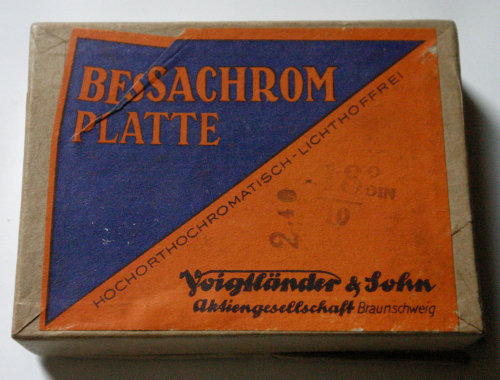

Well that's my pack of "Bessachrom" Voigthlander plates, and my father shot rather a lot of images on Selochrome on his regiments (IEME light tanks) long march from Karachi, through the mountains on the Afgan border, Persia, Lebaon, Syria, Palestine and Egypt and witnessed Rommel and Montgomery's epic El Alamein tank battle, they were on the edge of the fighting closing off bolt holes :D
My mum took a few picture of me as a kid on Verichrome, then later when my sister was born Werichrome Pan
So you see "Chrome" could mean different things to different people.
