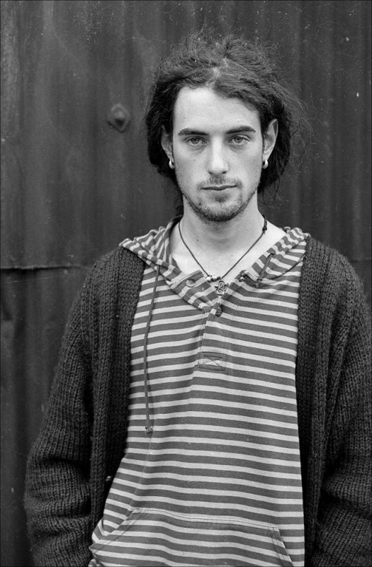

I've never found the grain to be huge with a combo of EFKE and Rodinal, even in 35mm.
Here is a test of EFKE 25
Adox film test
Here is a portrait on that combo
EFKE 100 in Rodinal on 35mm film
*debunking the myth that Rodinal gives large grain*
Mark
That shot does not debunk the myth at all. The nature of the image will hide grain almost entirely (sweater texture, dark corrugated iron, hair, pale face etc. Try a scene with subtle greys in the sky.
I use rodinal and like it for some things, but lets be realistic - it DOES give large grain relative to many other developers. Of course you can get fine grain with Efke 25 as someone else pointed out. But it will be finer still with D76, or Xtol or...most develpers. If the enlargement ratio is relatively low then it wont be an issue of course, but that does not mean that the grain is not there.
Let's be realistic here. Some of us actually take photographs that don't always have a sky in them! The photo posted is/was not significantly grainy. P3200TMZ is an example of something that can be grainy - his example was not.
It also doesn't mean it's even a significant issue in the first place. Perhaps if grain-freaks would stop breaking out the microscope anytime a piece of 35mm film shows up there would be less emphasis on "grain" in general. To me, the grain discussions become so pedantic at times that we might as well be discussing megapixels.
