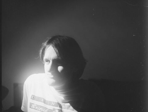

I vote for uncoated lenses... If only because I took this photo last night. Bright halogen light not very far away. Lens is... I'm not sure how old but it has a pat. date on it of 1903.. we think the camera is about 1920s.
HP5, EI800, Rodinal 1+25 8minutes, crap negative scan of 4x5 film on a flatbed.

glow not flare!
Thanks Akki and I take the point about uncoated lenses. Perhaps my description was misleading because the glow I'm referring to appears to be a quality of the negative itself rather than lens flare, however yours is an extreme example.
