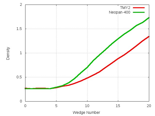

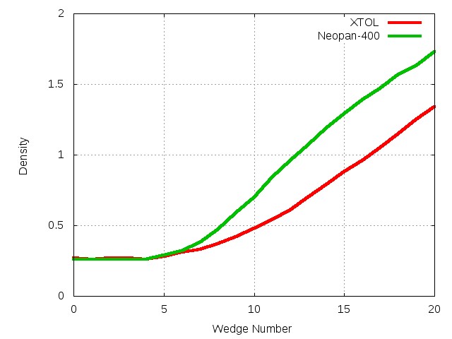

Thomas, I wish I had a darkroom! I had one years ago, but not here, so printing is done a la dpug. Anyway, in response to your request, I measured the densities of the Stouffer wedge off the Neopan roll. The graph below compares the TMY2 with Neopan:
Green is Neopan, and red is TMY2. It's clear that TMY2 is thin. Regarding an earlier posting: The X-axis is step-number on a Stouffer 21-step wedge, and each step of 1/2 stop (density change of .15).
ic-racer suggested boosting dev-time with TMY2, and I think I'll try that. If the yellow-orange developer isn't totally dead, more time should increase density.

If all other things are equal i.e. same tank, mixing containers temps etc and other films except TMY2develop OK then unless I have missed something OR there was some other change in the process which you have overlooked, it would seem that the TMY2 you have has a quality problem which is serious.
If there is a Kodak problem then you'd assume that quite a number of TMY2 films were affected so other users will be experiencing the same issue.
APUG can't cover all TMY2 users of course but you might expect someone else to report the issue.
Seems that you can do yourself and the rest of us a favour and report your findings to Kodak.
If this had been an Ilford film then after 7 pages you can bet your bottom dollar that Simon Galley would be reporting on matters.
Pity that Kodak can't be bothered to give us a contact or keep a watching brief here on APUG.
A difference in the two slopes isn't an issue by itself. It may be that Neopan has a steeper slope but key to this is whether your experience is preventing good prints from TMY2 negs and more to the point whether there is a real difference in your TMY2 negs compared to previously
You may have already covered this but maybe you can say if there is "before and after" difference.
pentaxuser
Thanks for that.
The curve shape is normal, so developing for more time is probably a good solution to simply increase the slope. If your developer had completely exhausted on you, you would likely be getting a shoulder since developer would exhaust in highlight densities first.
Getting such inconsistent results from Kodak film is very unusual. I wonder what a Kodak technician would say about your findings. All other things being equal, it clearly appears you have a problem with your film, especially if your density curve is inconsistent with previous results, while other films develop normally.
I echo pentaxuser's plead to report this to the place you purchased it, or better yet, to Kodak directly.

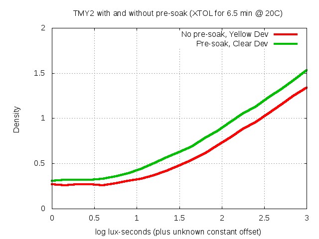

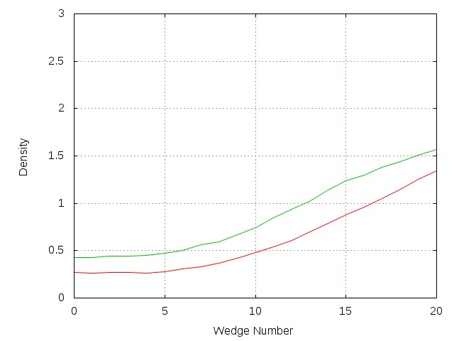

Pre-soak TMY2
Another major discovery:
If you pre-soak the Tmax-400, the problem with yellow developer and thin negatives goes away!
The developer pours out clear. And the neg's are denser. Here are the H&D diagrams with and without a pre-soak (X-axis is now log lux-sec):
The pre-soaked TMY2 is still less dense than the Neopan (did I over-develop it?), but the densities look normal now, and the leader-density is 2.75, which is fine. The leader was 2.35 before. The TMY2 now looks healthy instead of sickly.
When I did this test, my hunch was that (1) some chemical was added or boosted in TMY2 which harms ascorbate developers such as XTOL, and that (2) a pre-soak would remove this chemical. My pre-soak consisted of three fillings, soaking for two-minutes each, agitating twice/minute. That's probably overkill, but we don't care. The water after the first soak poured out discolored, so something was removed from the film.
This solves a problem I've been fighting for over a month. It sure is nice to see TMY2+XTOL behaving correctly again!
Again, the box-code on the 35mm Tmax-400 is "04/2014 0166".
And I need to contact Kodak about this...
Mark Overton
