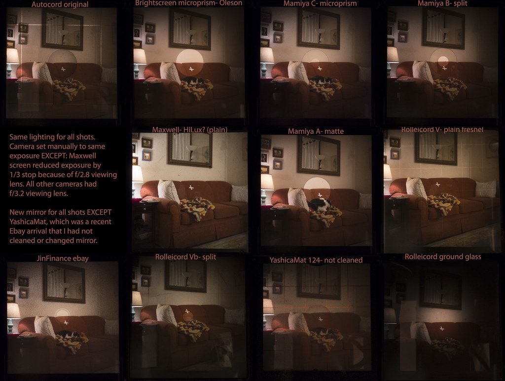

Meant as a rough comparison. Not really representative of the edges, but it should give some idea. The Oleson microprism was from the Brightscreen mold. I am not certain if he and Lance had really nailed all the molding issues.
I'll say this again: split hairs all you want, in practice you dance with the one that brung you and most screens are quite usable. Sure, a Maxwell looks better compared to a... oh, say, Autocord. But on its own, shooting, most of us will find it quite possible to use any of these. Look at Robert Dosineau and his 1930s and 40s Rollei work- ground glass screen only.
...most of us will find it quite possible to use any of these
"Possible" yes, but pleasurable, maybe not so much. The factory screen on my Rolleicord V was satisfactory for focusing in most situations. However, for framing, I thought it was unacceptable. After shooting slide film for several decades, I became very aware of what is happening at the edges of the frame; there is no cropping with slides. So I got very frustrated with my Rolleicord V because the edges of the viewfinder were usually so dark I could not really see what was going on. My replacement Brightscreen is no better than the factory screen for focusing (maybe not quite as good). But for framing, the Brightscreen made the difference between me enjoying the camera and using it -- or hating the camera and not using it.
