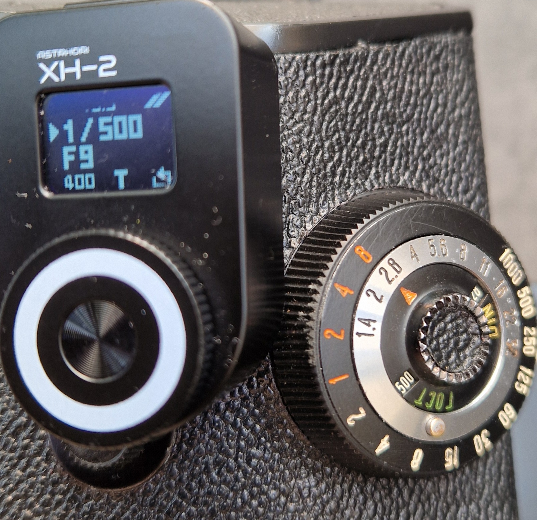

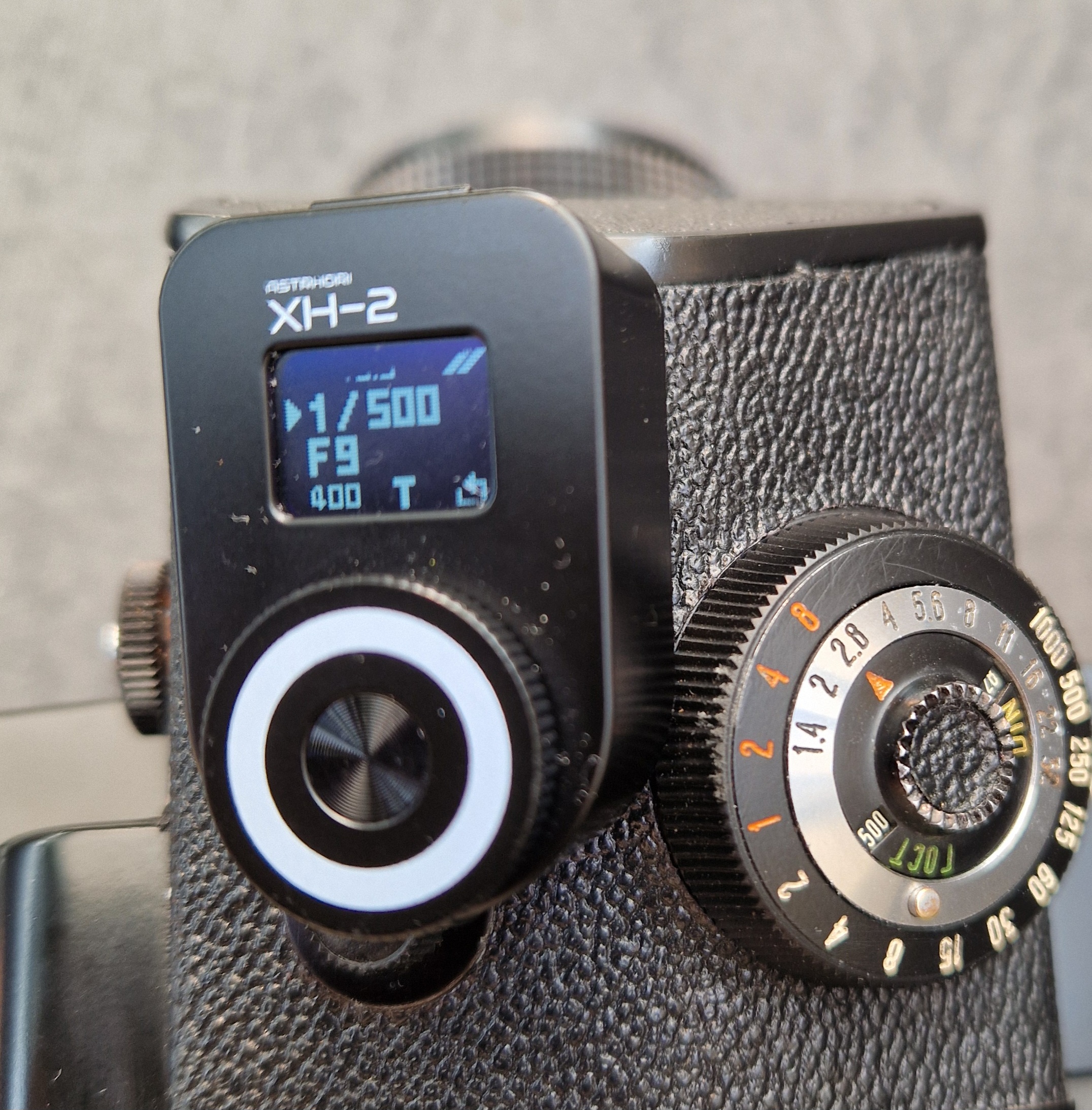

So I'm playing with my beautiful beast, but there is something wrong with the lightmeter. Both red dots should be flickering together. But, when I tunt the wheel very slowly, the red dots go only from left to right.... every setting is correct and the battery is fine.
What could be the issue here?
According to chatgpt the voltage of the battery is too high (1.5v), but a specialist I talked to, says the voltage shouldn't be the problem here...

I can't be real sure, but when one light switches to the other, it's the correct exposure. There is a way to adjust the meter. After peeling back the leatherette, there's a cover you can remove, and inside are two adjusters you can turn.

It's been awhile since I've used it, but I think your meter is fine, and the point where it switches from one LED to the other is the correct exposure. Yes, it's possible to have both LEDs lit, but it may take a ridiculously light touch, and isn't necessary.

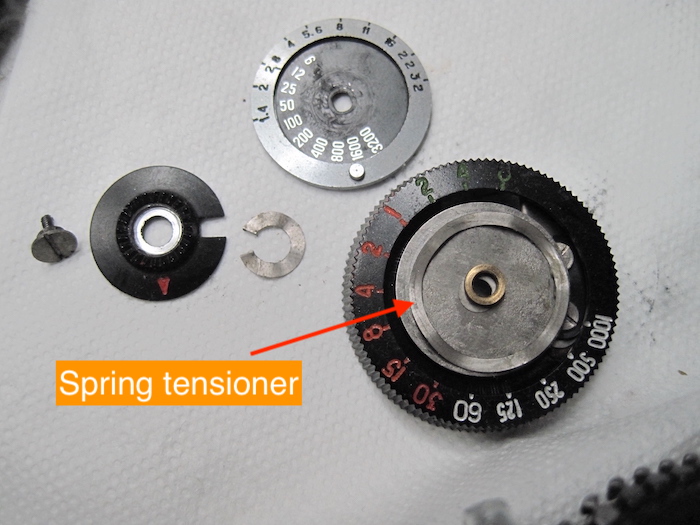

The silver dial shouldn't move once you've set it for the lens you're using. If the silver dial is moving freely, it's missing the spring tensioner beneath it. Or it has lost so much of it's tension. it's not effective any longer. Slight bending of the tensioner should fix it. Apply a little grease when reassembling.

Now my problem.... both outer and silver ring move when I move the outer ring for metering.... that's bad because I paid more for a "mint" version. Also the meter gives me a really weird reading and it's always the same... doe you kiev/arax users use the meter, or do you meter with a external meter? And should I make a problem because it doesn't do what it suppose to do?

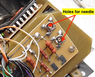

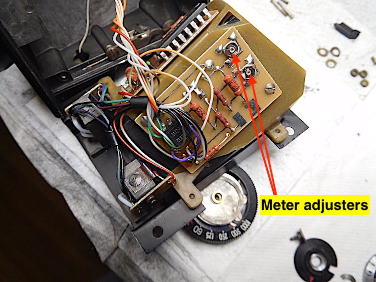

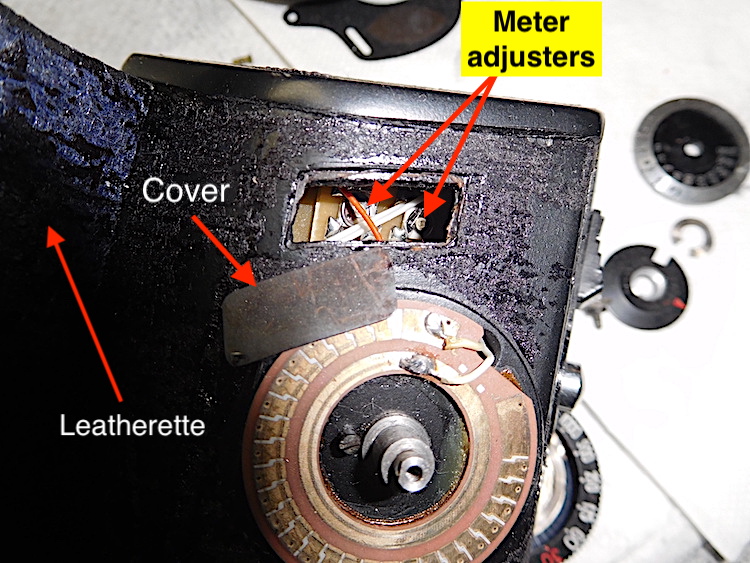

Perhaps a little late with this post, but the photos show the adjusters for the light meter. Devise a tool to get in there and rotate the adjusters slightly, one at a time, checking the meter reading each time, in bright light, and in low light conditions.
Is one of the pots or low level and the other for high level?
I'm not absolutely sure which is which, the photos were only to show the adjusters themselves and where they are situated in the meter unit. I also haven't adjusted any of these Kiev meters, I'll try that soon when I power this meter up and see if it works first. I have five of them, I can fiddle with all of them till I get a good one out of all five.
There was a camera that I did successfully adjust the meter on, and that was a Pentax KM. After removing the top cover, the two meter adjusters were staring me in the face at the rear of the prism. I knew nothing about adjusting those either, but had a go anyway.
To start, I turned each adjuster to establish what they did. One adjuster (the left one) moved the needle quite a lot, the other moved it just a little. I guessed then that the left one was for daylight possibly, and the right one was for dull light. Stepping out into the day light, I adjusted the left one until the needle matched my good hand-held meter. Then I stepped back into the house and saw the the meter reading was off according to the hand-held meter, so I turned the right adjuster till the reading was good for dull light. Each time, the top cover must be sat back on the camera, and light blocked from getting into the viewfinder by having your eye covering it.
After that, I went back out into the daylight and found that the meter reading was very close to being spot on, even after adjusting the right one for dull light. From memory, I only went through this procedure twice to finally get fairly accurate readings in both bright and dull light ... Pheww! that KM meter was out 2 stops before I started. Now it's all good again.
To adjust the Kiev meter, I will do much the same as I did with the Pentax KM, but it will be harder because the Kiev has red lights instead of a meter needle. So after turning one adjuster slight amounts, I'll be checking to see whether I can get the first red light to come on precisely according to the accurate reading of the hand-held meter. If I can achieve that, I'll then turn the other adjuster to see what happens with that. I'll try to get back with some results. The job will be tricky because there's not a lot of room to get in and turn the adjusters, but there are holes in the adjusters for a needle to turn them.

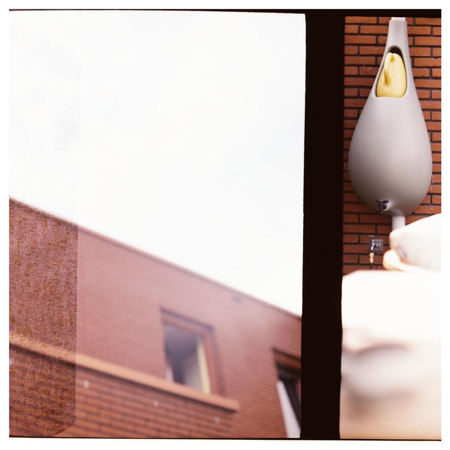

On the other hand the ARAX gives me issues with the first frame. I load the film properly and align the arrow with the dot.
Still I see the tape on the first frame. Or a weird foto on other first frames.
This is the last weird photo. What am I doing wrong?
