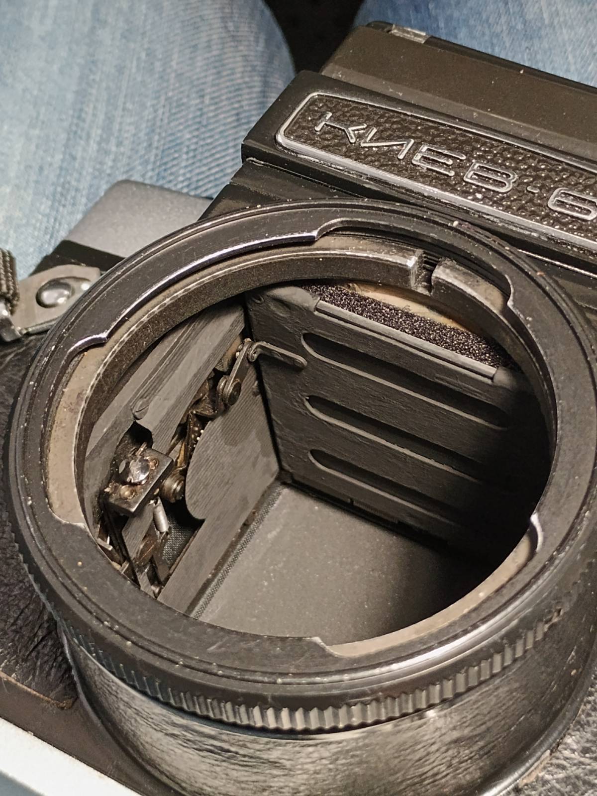

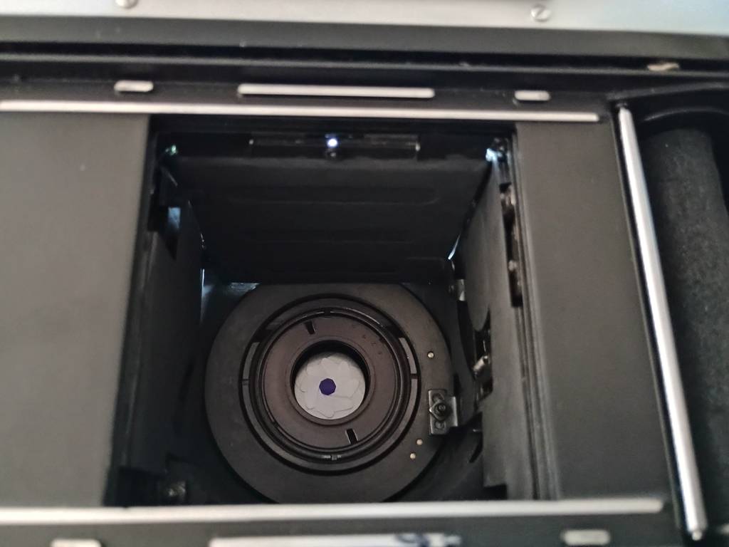

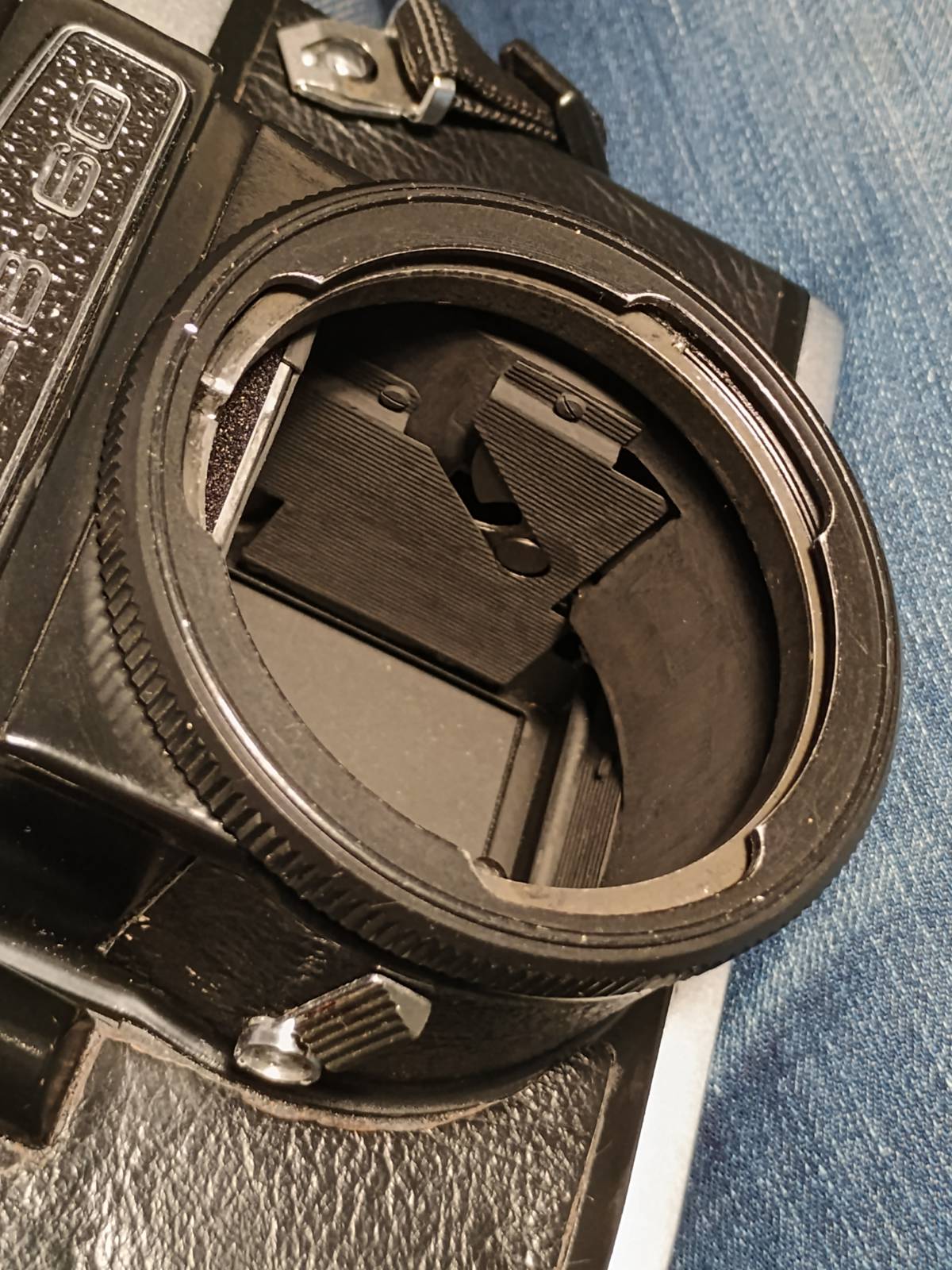

If you catch a good sample, the Kiev-60 is a bargain. The focusing screen is very bright and superior to the dim glass screen of the Pentacon Six which does not show the whole image.
But there are some issues you should be aware of. You can solve them by yourself:

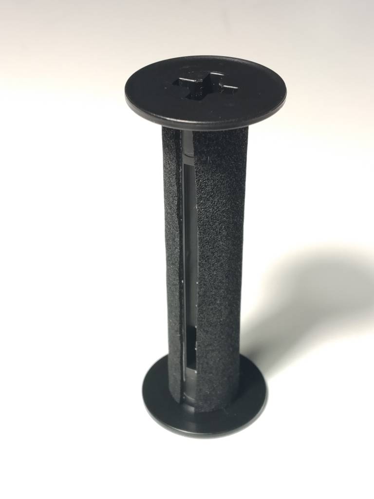

1. The frame space is very narrow, sometimes even zero. Easy to solve by thickening the taking spool with self adhesive tape or something similar.
2. The mirror box is reflecting light. It was painted glossy in the factory. Most of the complaining about stray light of the soviet lenses is in reality caused by this issue and not by the lens. Solve it by repainting with black chalkboard paint. Flocking is an other option.
3. There is some light leaking from the focusing screen to the mirror box. Avoid light to fall into the chimney during the exposure. I have a broken chimney viewfinder, encountered some strange light leaks, and could proof the issue with a torch. This is only an issue during the open shutter time.

I photographed quite a bit with a 1991 produced Kiev60 in the 90's. When things went right it was a good camera. Overlapping frames problem I solved by taping some stuff to the winding spool to make it thicker, I still got 13 frames out of a roll. But in almost every roll there was one frame which had an annoying bit of overexposure. Finally the shutter gave up altogether and I couldn't get a repairman touch it with a ten foot pole.
