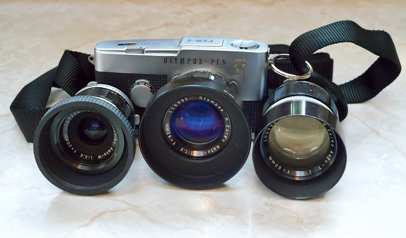

In the interim, my refreshed lens line-up is sitting on the Pen-F:
Had a delightful chat with René at Service Camera Pro in Québec City, around one third in English, one third in French, and one third in Franglais. He will be happy to make the Pen-FV work using donor parts if needed from the Pen-FT. What a nice man! Told me if I need any Hasselblad repairs he is factory-trained but will retire in a couple of years. So $18CAD to Canada Post and we'll see what happens.

Perhaps it's time to say something about where this half-frame nonsense is going. I have gone from an old Pen-FT to an even older Pen-F, and now the FT is a donor body for parts for a Pen-FV. Craziness, indeed. My half-frame lenses began in the 1970's with a 38mm/f1.8 and a 150mm/f4, but have since grown to a 25mm/f4, 20mm/f3.5, 42mm/f1.2, 60mm/f1.5 and a 50-90mm/f3.5 zoom. Generally, I'm happy with any camera that has the FF 35mm equivalents of a 28mm. a 50mm and a short portrait telephoto 70-90mm. The last time I spent some years with a meterless, all mechanical camera with 28/50/90 lenses it was a Leica M2. (OK, there were and are still some MF and LF cameras that I have that meet those criteria!) This one excites me a bit more, as I am naturally an SLR-viewfinder person, rather than a rangefinder person. Can't help that, it's something to do with brain wiring and not open to argument. But this little camera is smaller, lighter and quieter than the M2. And, yes, the negatives are half the size, so half the quality. (Also half the price, but I know none of you care about that.) With grainless XP2 Super, I don't think that matters so much, and while I really get off on setting up, planning and executing a high-quality MF or LF photo, I haven't had quite so much fun in ages when it comes to carelessly shooting whatever is in front of me with film.
No doubt ii is not in my interest to make others want to buy into this old system, but it's hard not to share the fun. Give it a try if you fancy it.

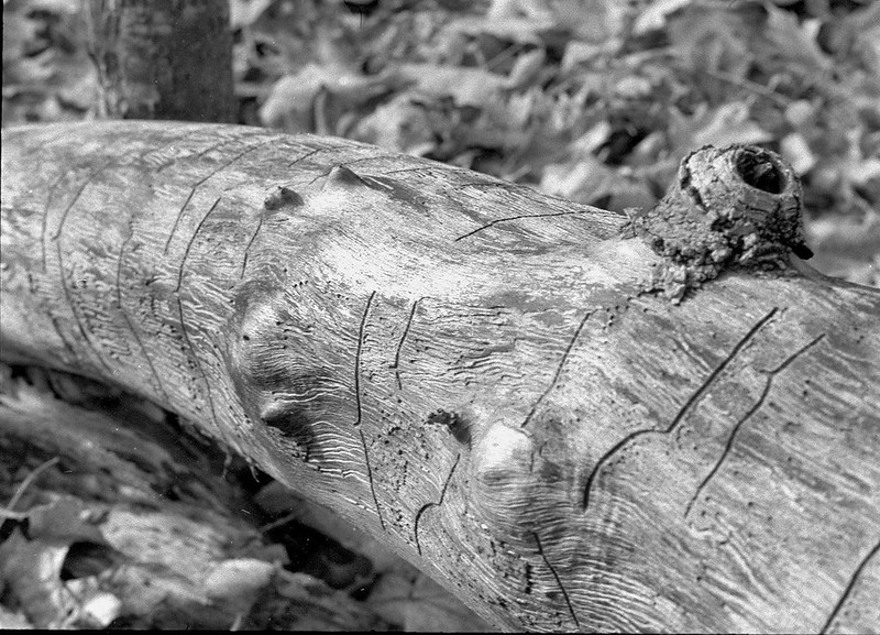

Wormy deadwood, Pen F, 42/1.2, Pan F @ 80, Diafine.
