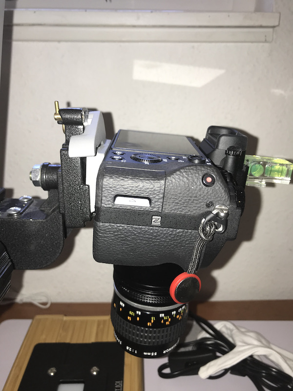

Check your Alzo Copy stand. I was using one for quite a while and was continually having sharpness problems. Part of the scan would be right on and part of would be soft. Bought some cheapie camera levels and found my problem:
The quick release plate doesn't latch into the baseplate very tightly and the camera tilts out of alignment. I swapped it out for an Arca-Swiss plate and solved the problem.
My first Alzo copy stand had to be returned because the plastic gear track was broken, and the second one had some issues related to the baseplate. The camera screw was grinding into the backside of the baseplate - but I was able to make it work after adding a thin washer to create more clearance. The front-to-back alignment was actually not bad on mine - little or no sag, requiring only some fine tuning with the adjustment screws. But I am happy to learn Arca-Swiss plates can be substituted if necessary.
