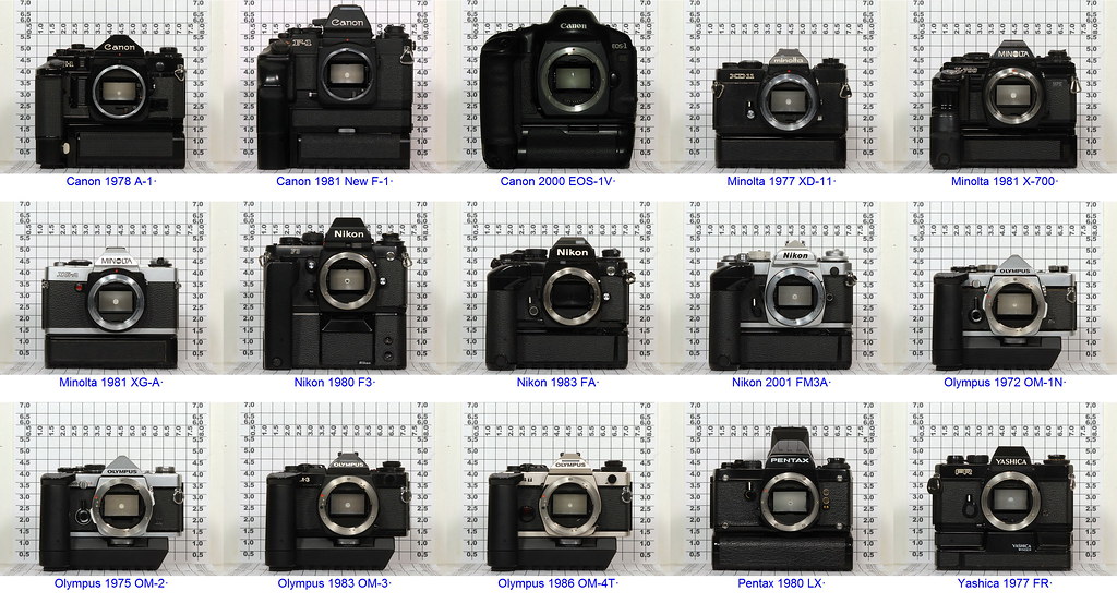

Motorized by brand/date by Les DMess, on Flickr
The MD-4 on a F3 and the MD-11/12 on the FA and FM3A, if it operates the same as when on a FE, replaces the in-camera battery to power the camera electronics.
