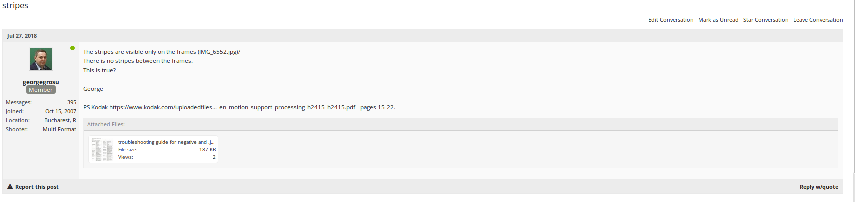

The stripes are visible only on the frames (IMG_6552.jpg)?
There is no stripes between the frames.
This is true?

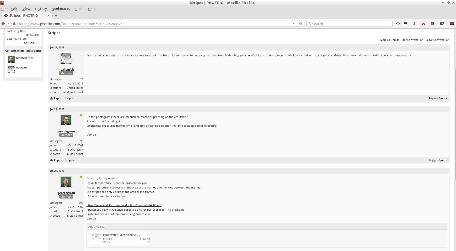

Yes, the lines are only on the frames themselves, not in between them. Thanks for sending over that troubleshooting guide. A lot of those sound similar to what happened with my negatives. Maybe there was too much of a difference in temperatures.
