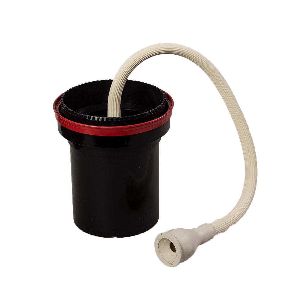

Having one of these will make your life a lot easier and you can set the flow rate really low and time how long it takes the water to come out clear.

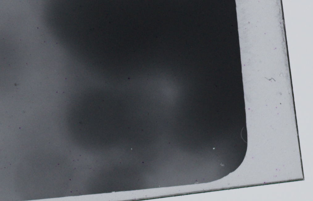

Has anyone noticed what color the spots are on the negative? I think I might have the same problem but in my case the spots are red. Here's an example:
Seems unlikely that the spots are the anti-halation since they are red instead of blue?
I am using Arista Ultra 100, 2 1/4 x 3 1/4" sheets, emulsion # 021754-03. I presoak for 1 minute in tap water which comes out bright greenish blue. Develop in D-76 stock (which was mixed about a month ago and used a couple times), 6 minutes at 68f. Stop with water, fix with Ilford Rapid Fixer 5 min. The spots did appear when using fresh fixer for the first time.

The red dots are an interesting additional piece of information -- those would of course show as white in a print, and light gray to white if scanned as grayscale (scanned as color and converted might be different). The only thing I can think of that would be red in Foma film (the antihalation dye is blue in 120 and sheet sizes; the gray base does that job in 35mm) is one of the panchromatizing dyes. Some of the dyes used to give red sensitivity are red in color; erythrosine? is used for ortho films, probably panchro as well, and based on its name is probably also red.
Add this on top of the issues with antihalation dye not dissolving correctly and it points to a QC problem with a chemical supplier; chemicals clumping before they get into the gelatin and onto the base. There are fairly simple solutions to chemical clumping, but you have to know it's happening before you'd apply them, because they add additional cost to the manufacturing process...
