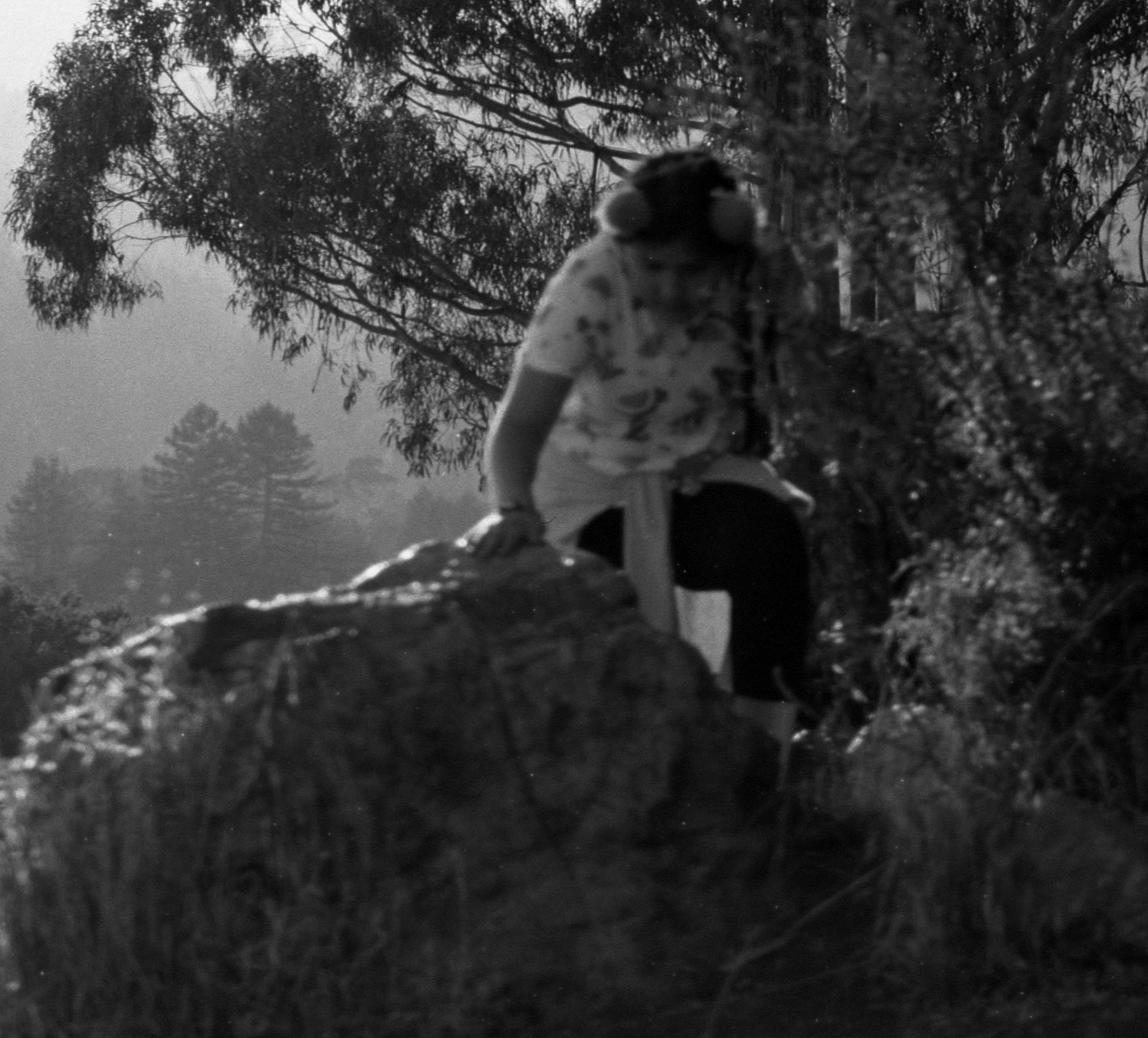

Ever since I started shooting medium format a few months ago, I started seeing tiny blurry white dots / specks on my negatives, but only with Fomapan 100, and only in 120 format. The samples are below. What are these?
Here's what I am ruling out:
  • Developer is well-mixed several days ahead of time. In fact, I am seeing this with D76 and Xtol.
  • 35mm rolls developed from the same bottle are perfectly fine, including Foma 100 rolls.
  • This happened with 3 Foma 100 rolls already. Some negs are worse than others.
  • My agitation is Ilford's standard: 4 inversions in the beginning, then 4 inversions every minute.
  • I am using "System 4" Paterson tank, i.e. the one which fits two 35mm reels or one 120 reel.
Thank you!

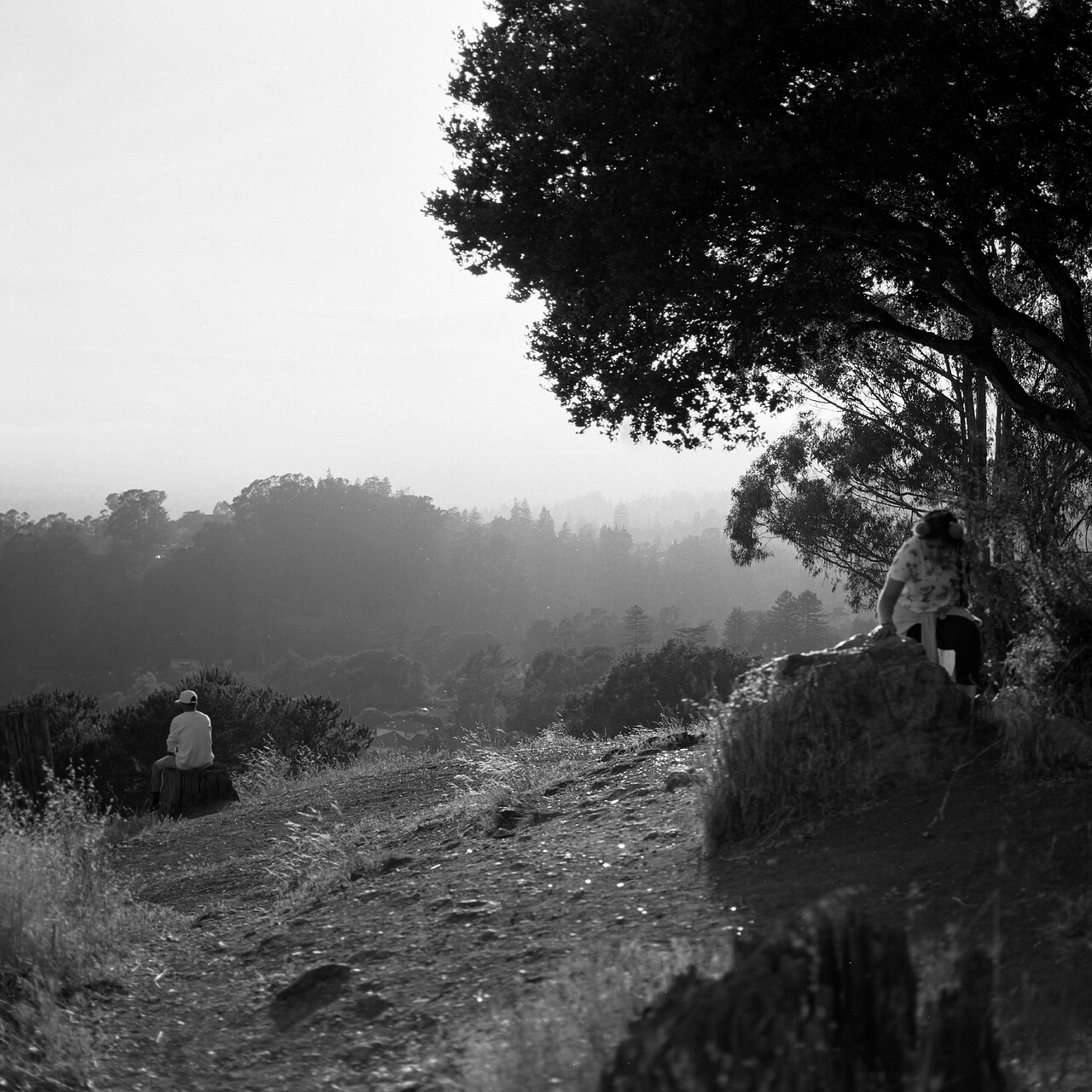

Full photo, as you can see they're tiny enough not to be noticeable at web sizes:
Zoomed in 100% (you have to click on it)

This looks like dust to me.
Every scan I've ever done has at least some dust on it.

My other negs are always 100% dust-free. I mean literally zero specks per roll, for both 120 and 35mm, I almost never touch up. Dust is the reason I switched to developing at home, because my local lab isn't very clean.
Is it possible that the Foma 100 emulsion is drastically stickier than others?
I will do an experiment next weekend: will soak this roll again, then photo-flo, and scan again to see if the specks appear in a different location (or if there are more of them).
Any other ideas?
Or more likely to build static.
The Foma may also interact with your scanner differently.
Try scanning the negatives again, with the negatives facing the other direction - still the same side up, just turned around.
If the white spots move in the image, then they are a product of the scanning process.

That's a good tip, except I use dSLR for scanning (another reason I never see dust). I think re-washing the negs will be a good test for dust, just time consuming...

Have you got any silver precipitate in your fixer or is it fresh solution in clean bottle ? A lesson I learned the hard way with similar spots appearing on my film (Tri-X).
Bormental
Mar 1, 2020
622
USA
John, thank you for replying.
Usually, I would use one 1L bottle of fixer for 10 films or one month, whatever comes first. Then I discard it and move on to a fresh bottle. The first two rolls were #9 and #10 rolls of a bottle. The 3rd roll is the first roll with a freshly mixed bottle, and a different brand too.
I would **love** for this problem to be dust. Dust is easy to fix. What bothers me is that the dots are somewhat blurry and suspiciously uniform only varying in "intensity". Dist is usually sharper and irregular. Another thing I'm hoping for is defective film, all these rolls were ordered at the same time. If it's not one of those two things I'll be begging for this thread to provide answers, I am not ready to drop Foma 100, it's absolutely gorgeous in 120!
