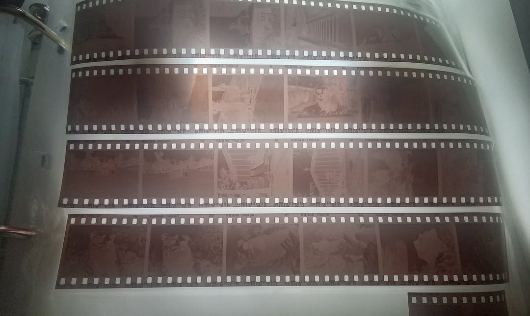

I had a 35mm roll that had expired ~2004, I shot it at 200 & got it developed in C41 chems at a lab. To me the negs look ok:
