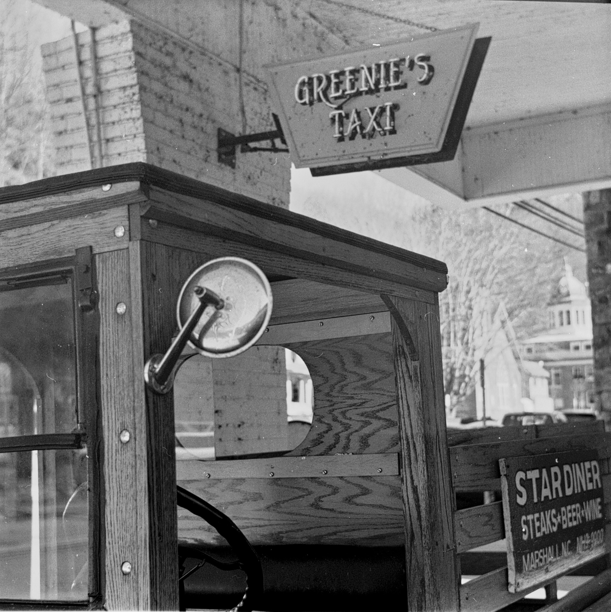

I've had several rolls of 120 T400CN sitting in my closet for about 15 years or so, just developed it yesterday, D-76 1:1 at about 70F, 10 minutes with five inversions every minute. It scanned very well.
