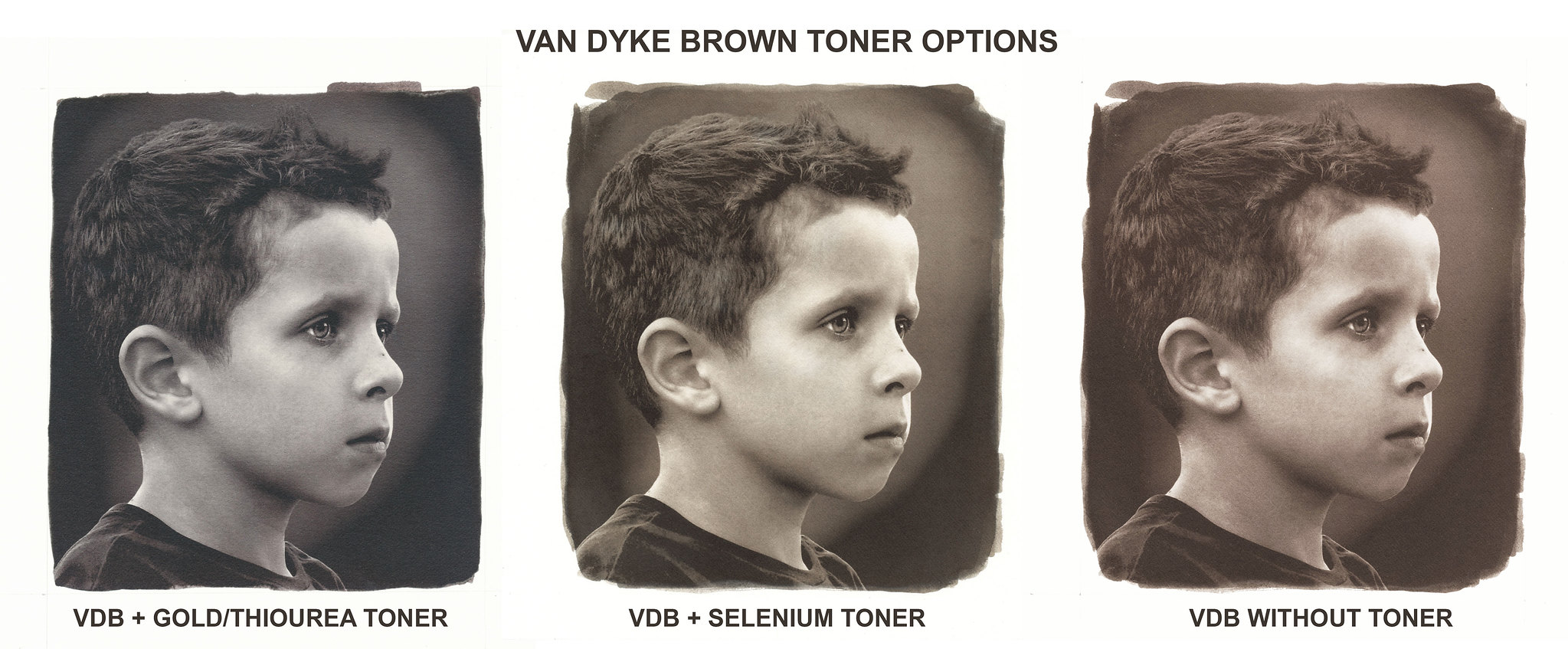

I'll recommend VDB as starting process, as well. It's cheap, fairly easy, fairly rewarding and mastering it will make upgrading to PT/PB very easy. Additionally you have the toning options that can improve the print stability. You can tone only the best prints and this way even the expensive toners become cheaper to use. With the Gold/Thiourea toner you get prints quite close to B&W.

I'll recommend VDB as starting process, as well. It's cheap, fairly easy, fairly rewarding and mastering it will make upgrading to PT/PB very easy. Additionally you have the toning options that can improve the print stability. You can tone only the best prints and this way you even the expensive toners become cheaper to use. With the Gold/Thiourea toner you get prints quite close to B&W.View attachment 245176
If you can get such density range and smooth tonality out of VDB, who needs Pt-Pd?
Wonderful portrait(s)!
:Niranjan.
I second that!!
I've been reading a little on VDB. Once I get a few rolls shot, and go through some of this cyanotype chemicals, I think I'd like to try VDB's. I think the examples you posted please me much more than CT's. I'm going to give toning the CT's a try though and see how I like them.

I’ll third that. Not just a good demonstration of VDB but a really great image!
