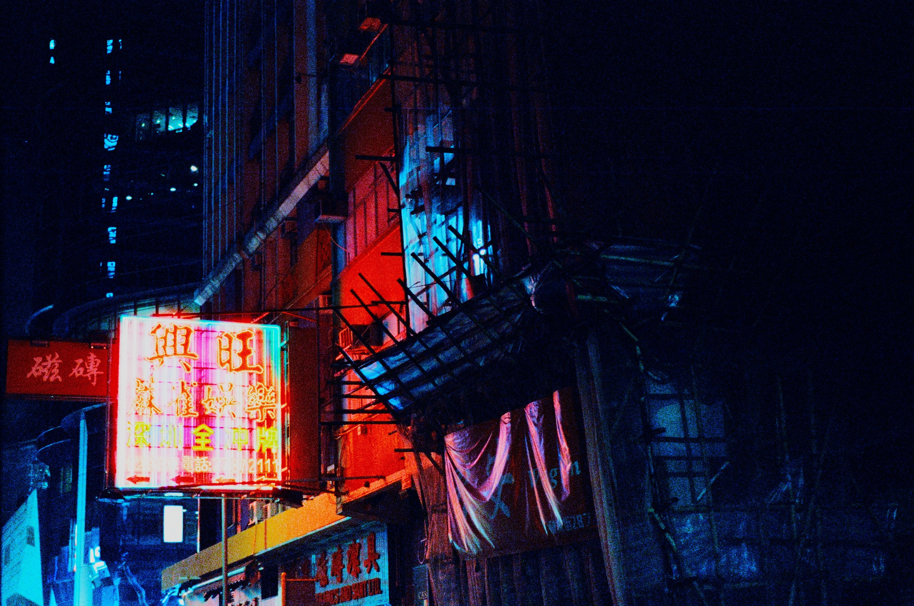

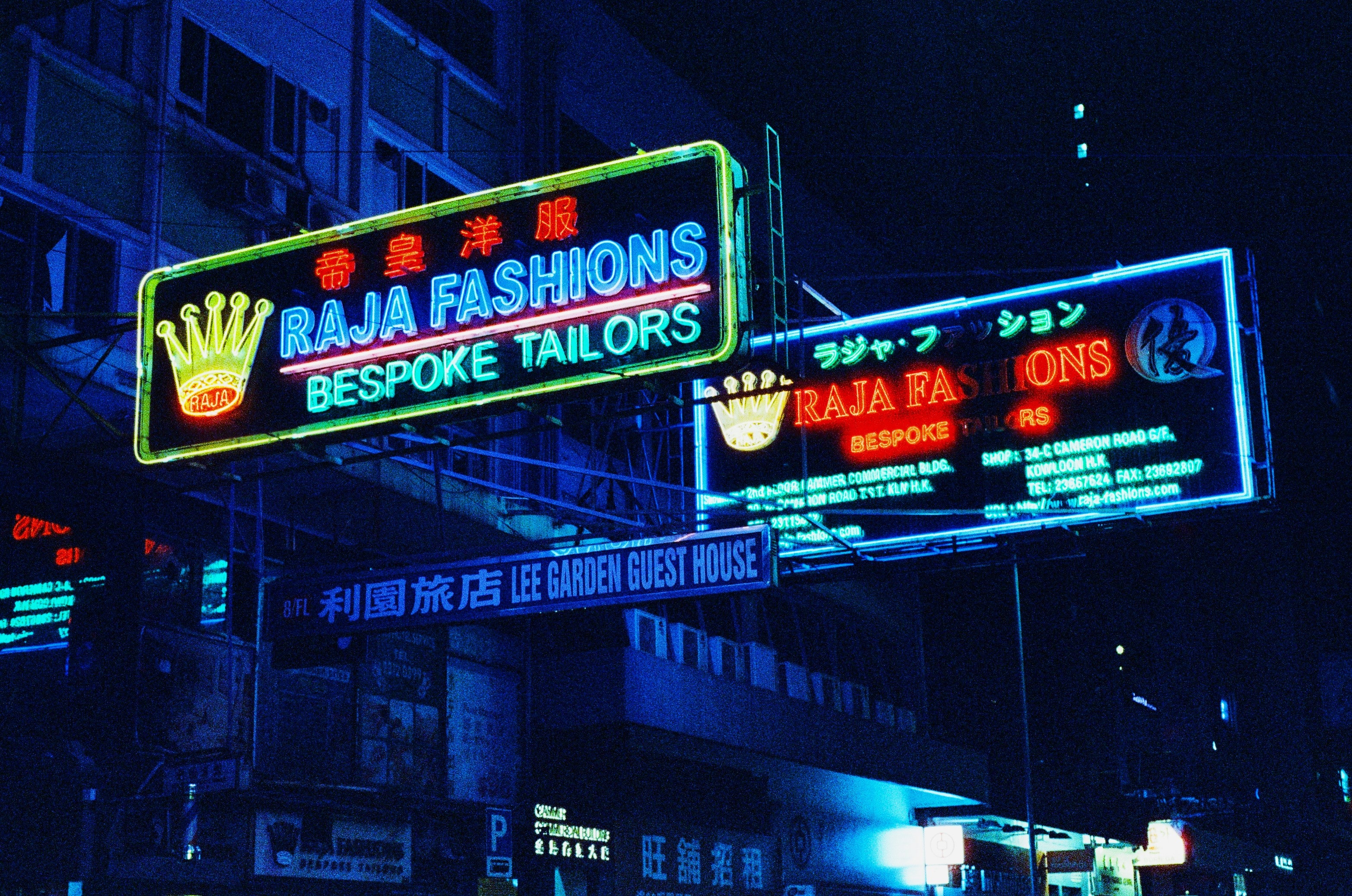

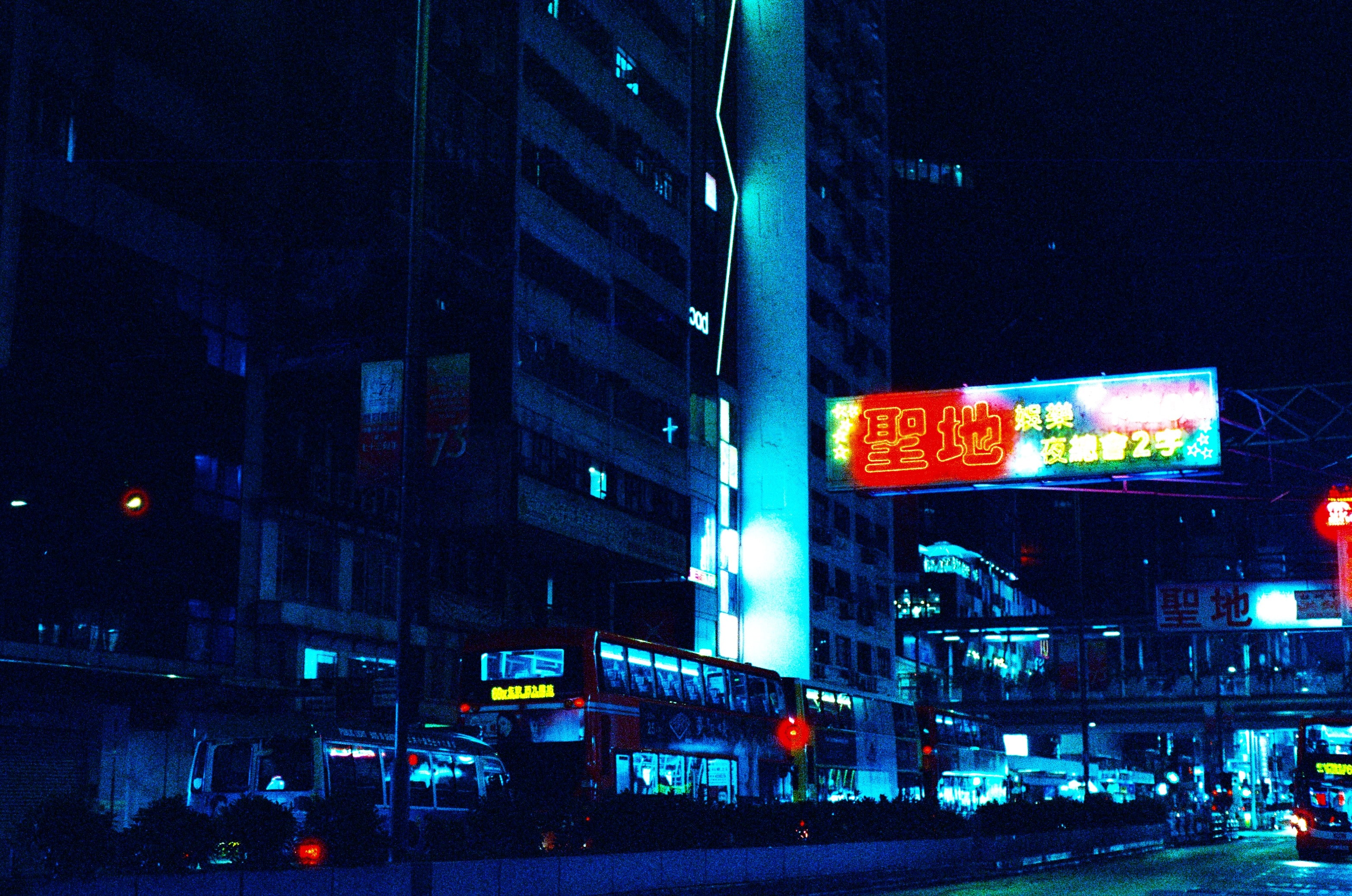

Ok, this is a common lab issue, from the days before film was scanned. They are set up to look at an image and give an 'exposure' that is 18% grey i.e. an average. If you have a lot of black in the scene, they will automatically lighten it, messing it up. You need to edit the scans.
You could ask your lab to re-scan the negatives and tell them that you'd like your pics to look more the reference images you shared in the first post. A scan is like a digital photograph of a negative and lab scanners are set up by default to do a kind of auto exposure and auto white balance of each frame. A good scanner operator (person who works in the lab) can override these auto adjustments but you have to tell them what you want.

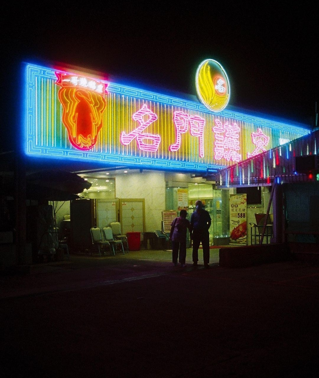

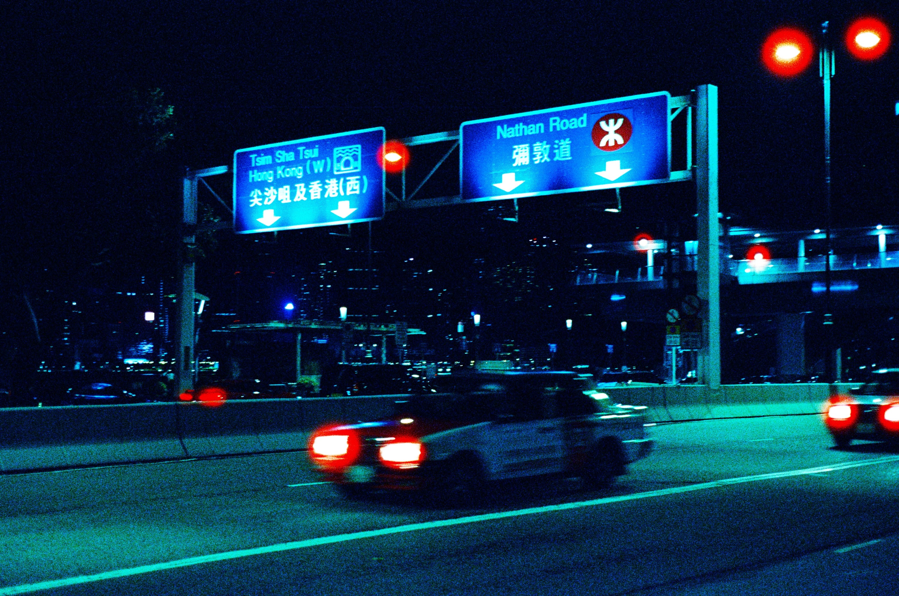

I went out 2 nights ago and I just got the results. Well, it is mostly crap, but I am still learning.
Made with Nikon F + 50mm f:1.2 and no tripod
As far as I can understand, I would say that I have allowed too much light inside my camera. I have used the app LightMeter on my phone to try it, the issue is that you can only choose to have the result of one value on it. I needed to know which shutter speed to use, so I had to set the aperture and the ISO first, but having no idea which aperture I needed, I almost always set it at f/2, hence the disgusting results

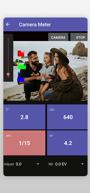

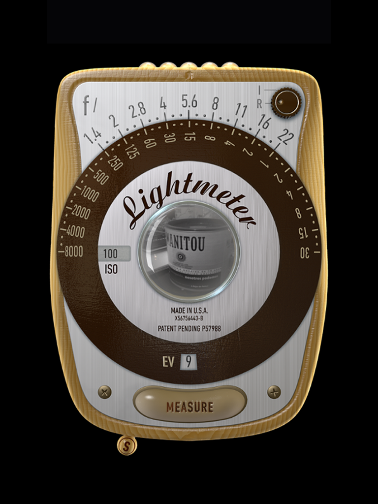

Is this the Lightmeter phone app you are using? (there are several apps with similar names, so this may not be the one you used).
If so, set the ISO (800, right?), then look above the dial at the aperturtes (f-stops). Notice each f-stop lines up with a shutter speed as shown on the brown dial. In this screen shot, f/2.8 lines up with 1/60 second, f/4 lines up with 1/30 sec, etc. So, if you set your camera lens to f/2.0, then set the shutter speed to 1/125 sec. Or you could use f/2.8 and 1/60 second - or f/4.0 and 1/30 second. Those are all the same exposure, so pick whichever combination you want. That is, each pair of settings that line up on this meter will let in the same amount of light to expose the film. Make sense?

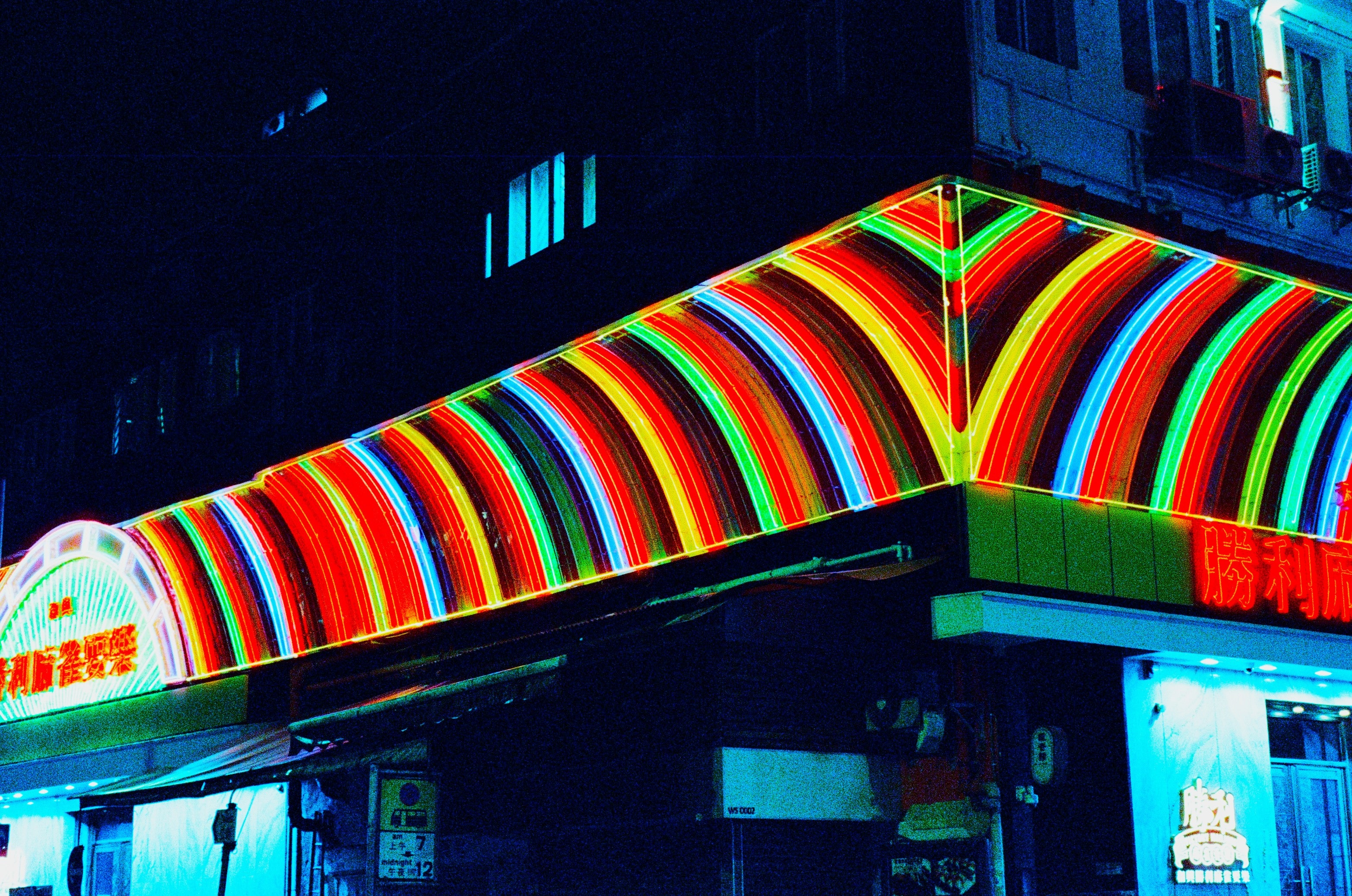

In the chart above, an EV of 9 has been assigned for neon
There's your simple answer. Not need to meter (and in fact metering this can be tricky) for negative film as neon lights have all similar brightness. EV 9 means 5.6 and 1/125 or equivalent at ISO 800. A little more probably doesn't hurt with negative film and you might get a bit of the environment.

The scans could be better, but I expect that the film is also a bit over-exposed.
Bright lights in front of a dark background will fool most meters. The meter ends up giving a result that will lighten the background, which also lightens the lights as well. Then when you combine that with automated scans, you get disappointing results.

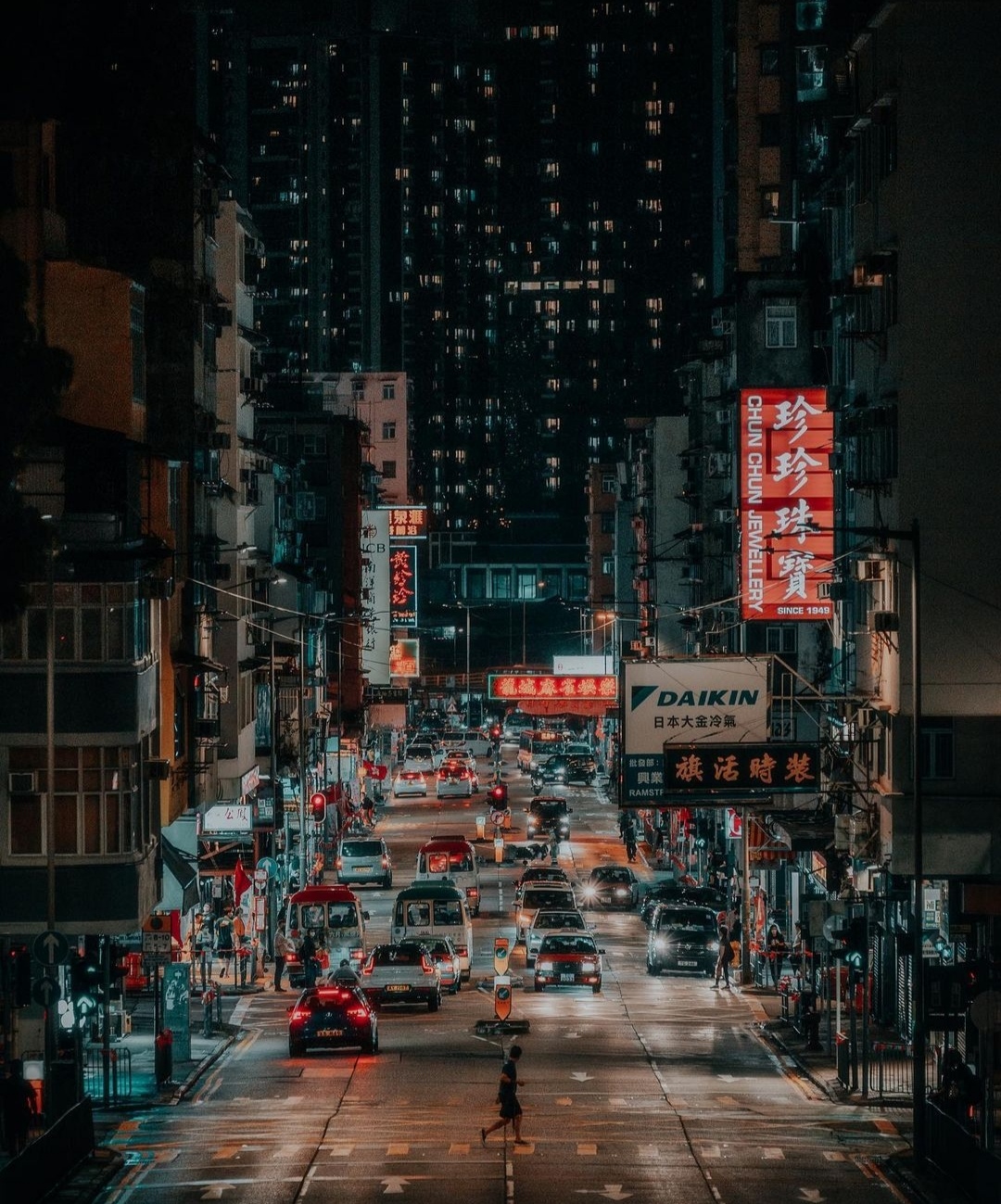

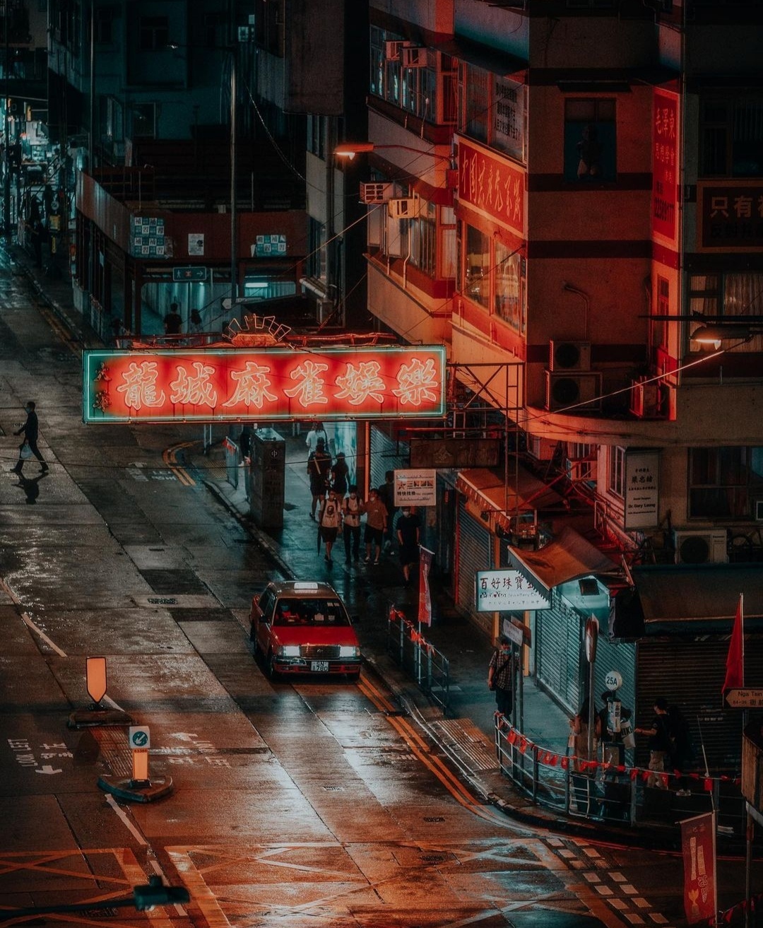

I have tried to edit the pictures with what I have on windows by default, looks better. Thanks a bunch to all of you. That'll do for now until I figure out how to obtain the below results, which is what I am after.
Ok now that makes sense. I thought that the amount of light wasn't the same actually. The app I was using is this one.
Is this a rule of thumbs to start working with or can I just stick to this for a whole shooting session? Light can really differ in Hong Kong. A neon can be in a really bright street among powerful LED lights signs + the shops, or hidden in a really dark alley.

What also makes the examples you show “good” is excellent composition and interesting subject matter. Also they are sharper so that .person’s technique is better. No camera shake and/or better focus.

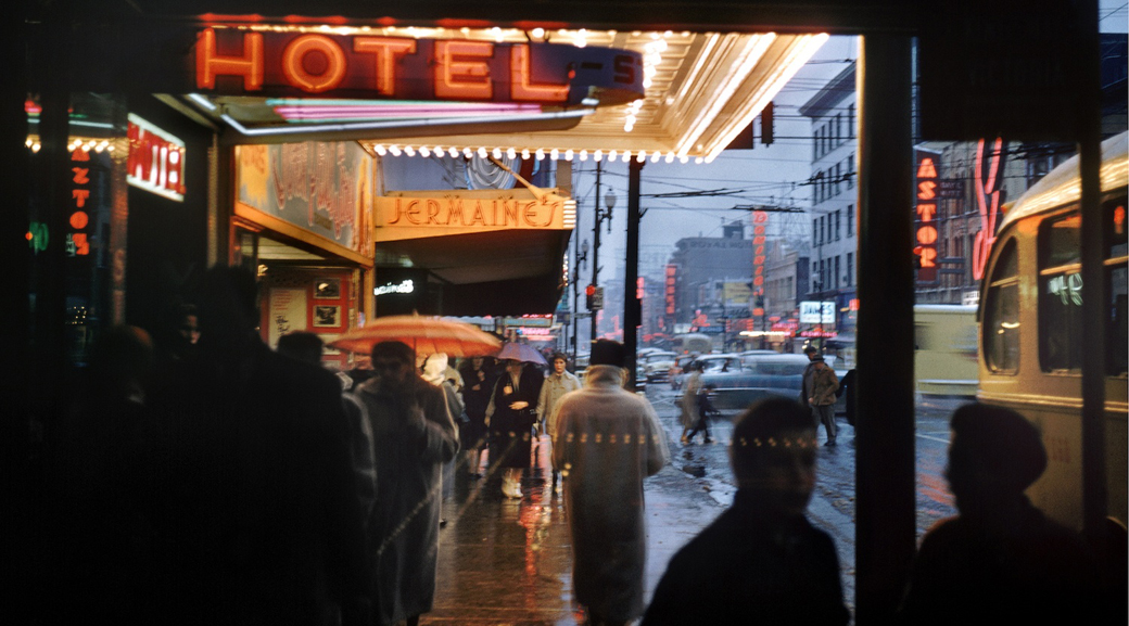

Vancouver in the ~1960s - 1970s, on Kodachrome, courtesy of Fred Herzog:

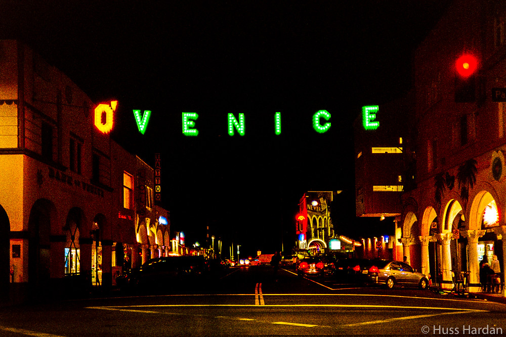

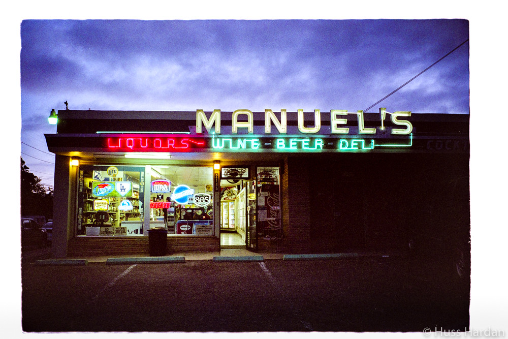

I would be curious to learn what films were used for these?
You're in the wrong forum mate, people in this forum only use manual cameras and no auto exposure as that needs a battery and it is automation and the devil will come take your soul if you have batteries in your camera and you are probably the rich 1% if you can afford $1 batteries for your camera because you just spent $15 on a roll of 36 shots and the only thing worse than a sinner using auto exposure is a heathen with autofocus.
I like the way you think.
Top two Portra 400. Venice one is Cinestill 800. Bottom two Superia 400. My mad skillz were pointing the camera and pushing the button.
Thank you. Do you usually meter these at box ISO?
There is only one Cinestill 800 and it is tungsten balanced, right? If so, I am a little surprised to learn the 'Venice' scene was shot on tungsten film, because it has the look I would expect from daylight film. I have not shot any Superia, but those last two shots inspire me to want to try some.
All shot at box speed. The giveaway that the Venice pic was shot on Cinestill 800 are the big halos around the light sources due to the lack of the antihalation layer.
