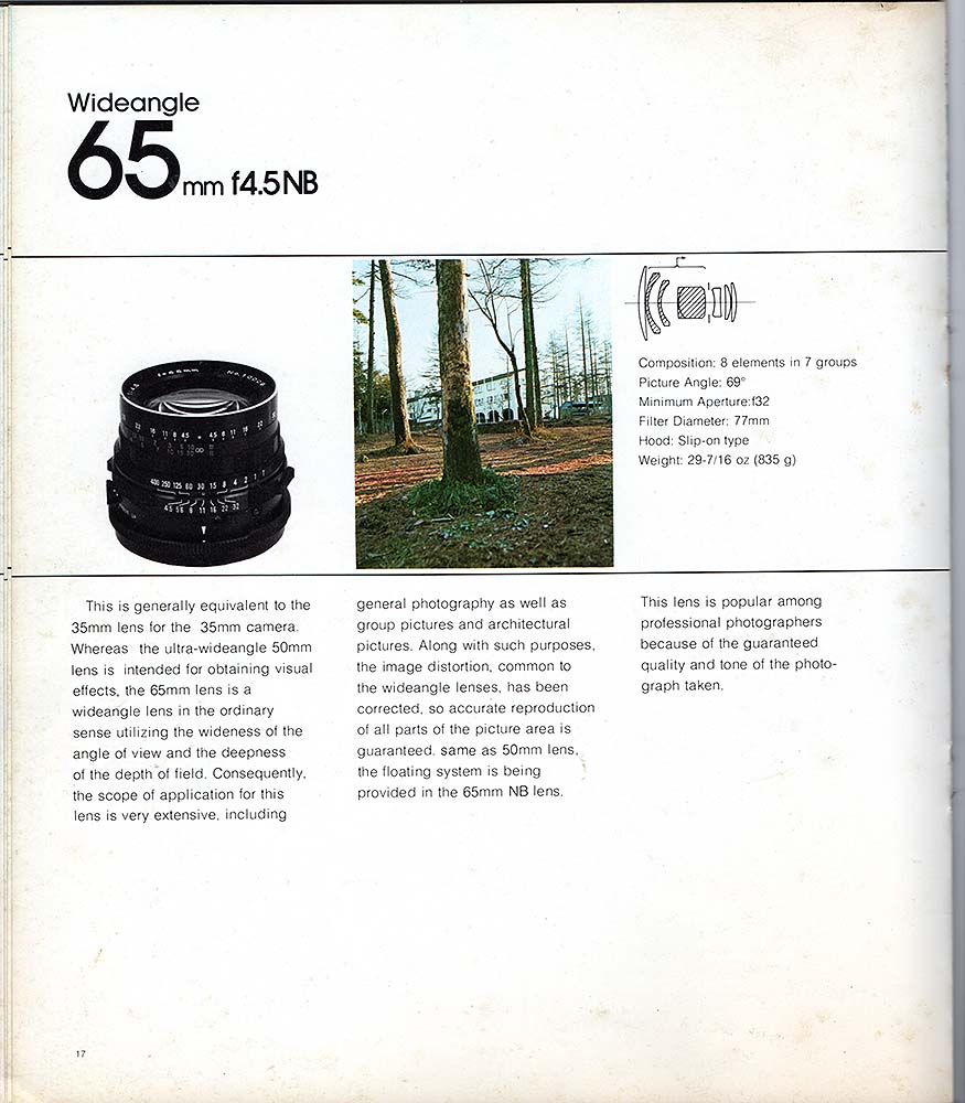

Here is a page from the instructions for the 140mm Macro C lens. As you will see, the lenses that have a floating element on them have more markings near that depth of field scale than the ones that just have a depth of field scale.

Further, according to Mamiya's RB Pro SD brochure, following lenses have floating mechanism: 50/65/75 (not shift one)/90/140

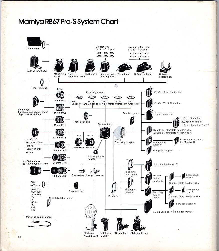

Further more, according to Mamiya's RB Pro S brochure, following lenses have floating mechanism: 50mm / 65mm NB. There is no "C" in the description or the lens photos but the lens is an 8 element in 7 groups which is the same as the C lens is. There is no mention of the 140 in the "Pro-S 76.1" brochure.
Perhaps there were four 65mm lenses made:
65mm Non-C
65mm Non-C, NB, improvement in eradication of aberration (floating).
65mm C (floating)
65mm K/L (floating)

[QUOTE="....am unsure of what "NB" means but strongly suspect it equates to "New Barrel" which is also used for the 90 / 127mm, there is no mention of the 140 in the "Pro-S 76.1" brochure.
- the 140mm macro is a post-1976 lens?
Sorry I was editing that out as I found some better info on Witold's link
I would not go as far as to say it is post 76, the brochure may have been printed for a future publication and pushed out regardless.
My brochure seems to trip over itself in more than one place, as far as I know the C designation started before 76 which further muddles it up, if the 76.1 means what it looks like.

... your brochure may be timed to the release of the Pro S (1974). Many lenses were subsequently added or updated. I've never seen a 65mm NB - only 90mm and 127mm. It's interesting nonetheless. I think the 140mm macro was introduced in the early 80's.
The 1978 Bell and Howell/Mamiya RB67 Pro-S system chart I have in pdf format lists the 140mm f/4.5 C macro lens with floating element.
The 140mm macro lens is the only one that has any reference to a floating element, and that is hard to read, because the chart was apparently over a two page spread, and it has been scanned in two parts, and the lens description is half in one part, and half in the other!
The instruction manual for the original RB67 that Mike Butkus has on his site has information on the early (pre C) lenses. There is no 140mm macro on the list, and the description of the 50mm lens is the only one that refers to a fkloating element.
I have the brochure for SD with same 2 page spread, so what I wrote is what it says.
