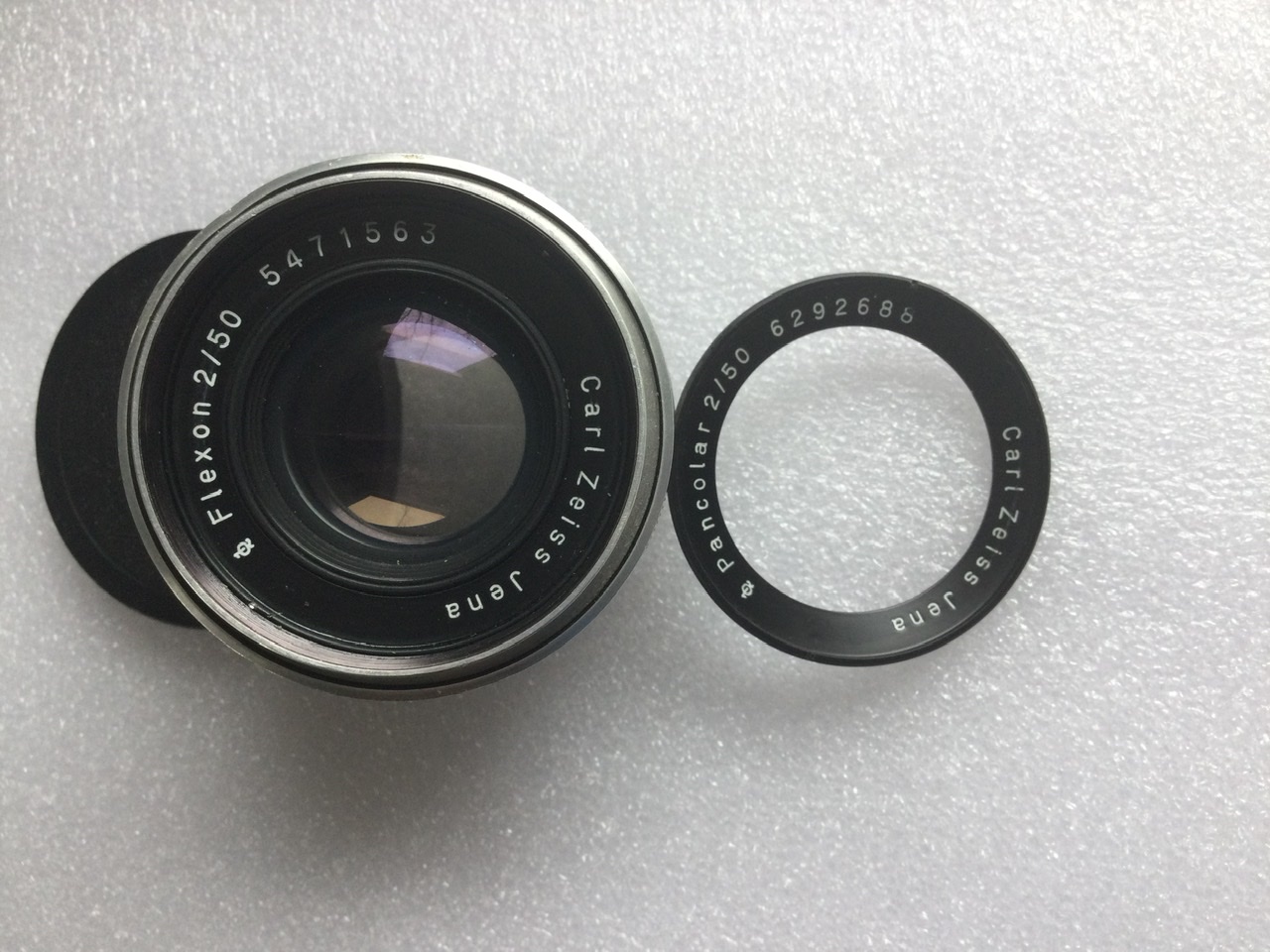

The Flexons were made through the 50s and the Pancolors started at latest by 1960, and serialized after the Flexons (some data missing).
Here is a pic of the lens that had the pancolar ring over the flexon
Here is a pic of the lens that had the pancolar ring over the flexonView attachment 332787View attachment 332787
The Flexon is listed (serial number) for 1958 (I think first piece off the line) for Praktina (note says "auch" Pancolor- also Pancolor). The Pancolor ring of that serial number is in a range (ending in 1962) that should be an M42 (note says "zT. [zum Teil] Exakta", partly Exakta) 58mm f2 Biotar (per the Fabrikationsbuch refenced above).
According to the link I posted above ( https://zeissikonveb.de/start/objektive/normalobjektive/pancolar2.html , section "Flexon und Pancolar 2/50"), there was a new calculation done in 1960 (maybe this had the improved coating?), but the name change to Pancolar happened already before, so there are some Pancolar with the 1954 version (=Flexon) around. And the picture says the lens section (https://zeissikonveb.de/____impro/1/onewebmedia/Marco/Normalobjektive/Pancolar 2!50b.jpg ) is for both versions (1954 & 1960)...
